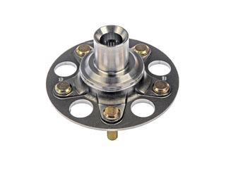

I identified another candidate for a bearing/hub combination:
2004 Honda CR-V Hub (42210-S0H-000, $109) with 1990 Civic Wheel Bearing (44300-SB2-961, $68). The Civic wheel bearing has a 72mm outer diameter, 40mm length, and 38mm ID for the hub shaft. The CR-V hub has a 5x114.3 bolt pattern. I don't have one on hand so I can't measure the flange offset of the hub, but based on photos it looks to be greater than the GTI flange by a significant amount.
The CR-V wheel bearing (44300-SAA-003, $68) can be used but requires a larger bore (73mm), and according to NTN's catalog for the equivalent bearing, has the same load capacity as the Civic bearing.
This is the CR-V hub flange:
Due to the lightweight design of the hub flange it would not be possible to drill it out for a 5x100 bolt pattern. However, it does start with the same wheel stud diameter and thread pitch as the Fiero, unlike the GTI hub which has 14mm thread holes. Since the CR-V hub is $109 compared to the $201 GTI MK III hub (1H0407613B) which requires $40 ARP studs, the CR-V hub reduces the cost per side by $132 and results in a stronger knuckle due to the smaller bearing bore. However, the CR-V hub is likely weaker due to its lightweight construction.
