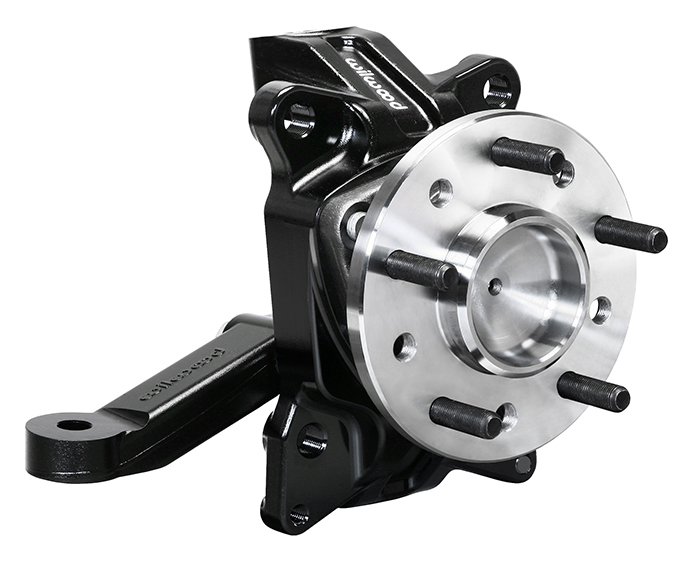

4.) Wilwood C10 Pro-Spindles
Looks very promising, price is "decent" at $499/spindle at certain vendors, not sure about the 9deg kingpin angle, axle centerline to lower ball joint mount looks to provide a 1-2" drop with regards to the 88 fiero upright. Steering tierod attachment would have to be altered or a new one created to address any bumpsteer issues... need to research more about instance center first. Called 3 times and no one can get back to me on the exact bearing used, but it comes with 5x120 and 5x5 bolt patterns, uses Chevy C10 ball joints. Total height is 9", ~2.25" taller than the stock 88 upright.
