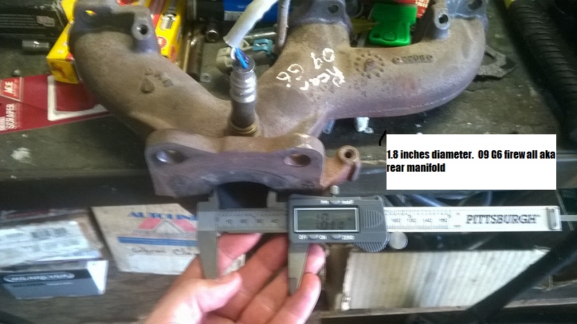

Also I got a exhaust manifold in from a G6. This manifold merges just 3 cylinders instead of all 6. It made me consider going with a twin turbo setup. you can see the exit from the g6 manifold is at 1.8 inches which is the same as the impala but the impala combines all 6 cylinders into that 1.8.

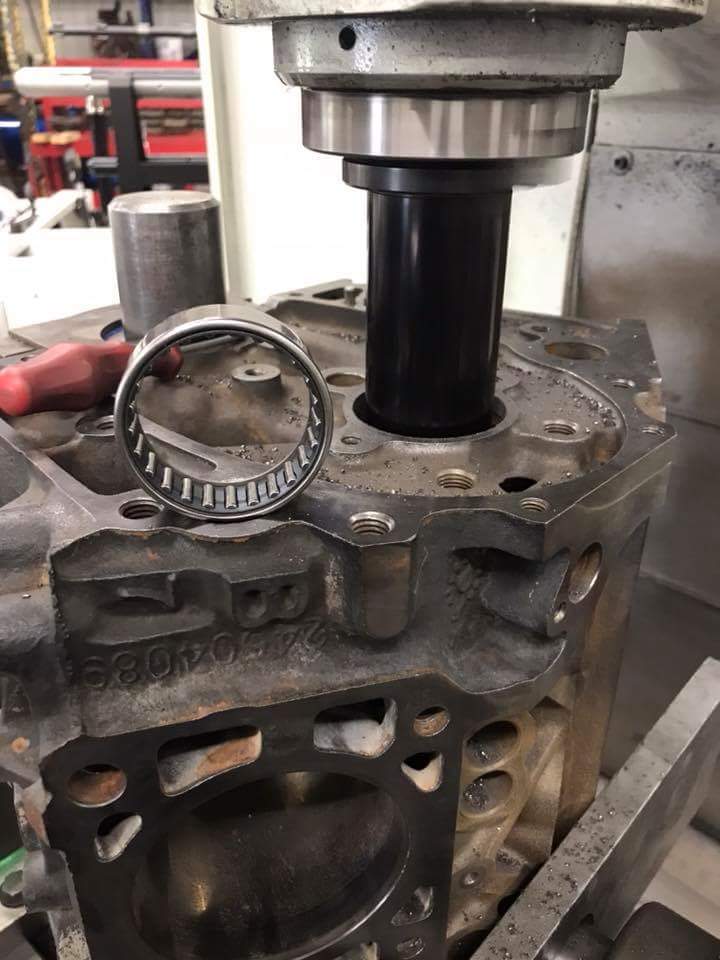

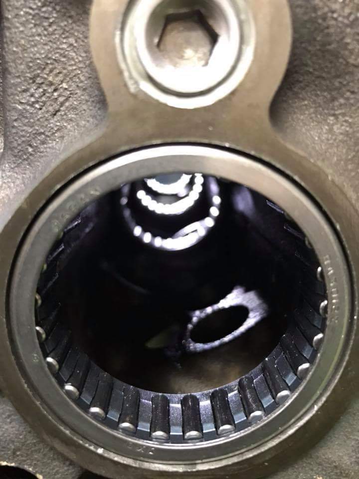

Found a needle roller cam bearing that can fit the 3900 block with some machining.
What this means is no more bearing spacers are necessary.
Its way more expensive however. 500 for machining and align hone of cam bores and about 200 for the bearings and installation.
Add shipping of the block both ways and its easily 1k bucks.
This will allow use of a factory or comp cams aftermarket 3400 roller cam

Better be a hell of a cam.
Needle roller cam bearings are pretty serious shiz.
How will you handle cam thrust? (from the oil pump drive)
Does it keep VVT? I'd expect appropriate use of VVT could spool a turbo faster.

Using these bearings would not allow use of the factory vvt cam. They are machined and installed to use the comp cam roller cam that can be custom made for 3400 spec blocks.
Thrust is controlled by the factory stop at the front of the cam. Its a piece that bolts to the block.
These bearings would keep you from having to buy my bearings spacers.. Yes more expensive than my spacers at $200 but its no longer a bandaid setup which I kind of feel the spacers are. However the spacers are proven to work

- 36278022_1810122729053467_1507463899476131840_n.jpg (61.64 KiB) Viewed 18296 times
