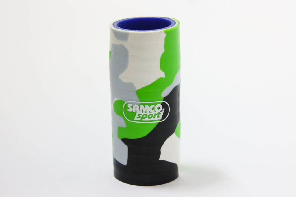

I ordered a bunch of SamCo formed silicone hose bends from an outfit in the UK for use in my brake booster vacuum line and the heater lines, as well as the coolant line from the oil cooler to the thermostat housing inlet. After being on order for since 5/07, they finally shipped today
Edit: I ordered from SamCo in the UK because they had Fucking Green Bitches! which is the color I wanted for cooling system hoses, while US suppliers only had blue, black and sometimes red.

Fucking Green Bitches! hoses finally hit my doorstep over the weekend... 3 months after placing the order
