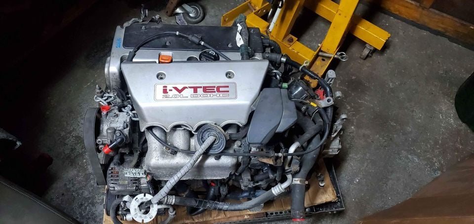

Drivetrain:
- K20A2 swap - This will give me a nice light compact engine and transmission which are known to be able to make very good power (~200whp NA for the first iteration, ~400whp on a supercharger once the chassis development is more or less done). I have a set of mounts from kfiero on their way: https://www.facebook.com/groups/1086771178323278
- I'll be using the stock RSX-S 6 speed transaxle, adding an LSD
- Custom axles - Honda inner and Fiero outer
- RSX shifter and shift cables are actually around the right length for the car, so use that or an aftermarket RSX shifter like KTuned
- Halltech ECU

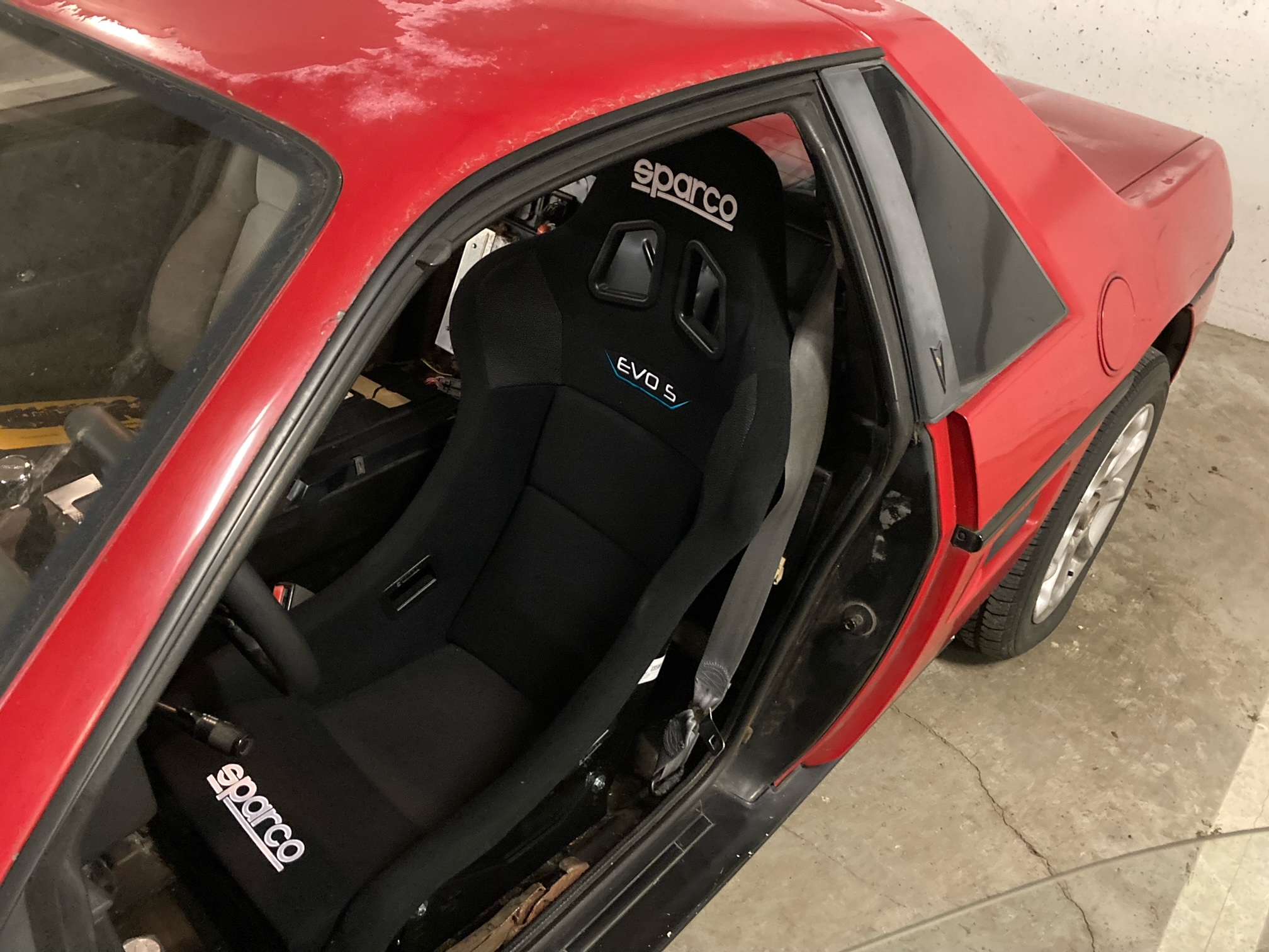

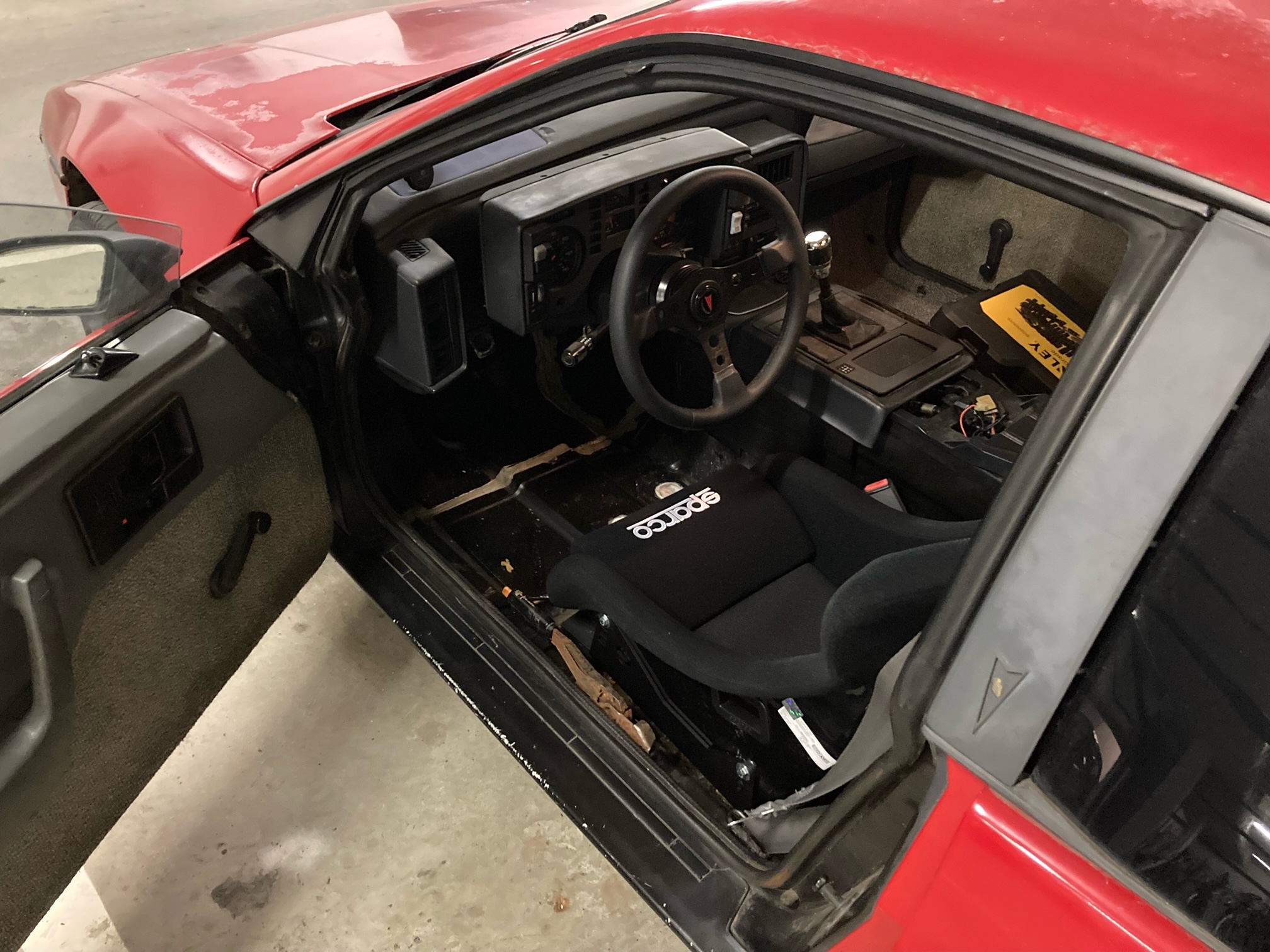

Interior:
- Building to Max category Time Trials rules
- Roll cage
- Stripped except for dashboard
- Fixed racing buckets (not finalized on brand/model yet)
- AEM or Haltech digital gauge cluster (remove stock gauges completely to simplify engine swap wiring)

I've started stripping the interior. Console, carpets, trim pieces. The head unit and speakers are out, and in the hole where the head unit was I've fabbed up a basic switch panel with some toggle switches, a clock, 12V outlet and a couple usb ports. At the moment only one toggle switch is wired, it controls the radiator fan. (I also changed the radiator fan circuit to be switched power instead of switched ground to make the LED in the toggle switch work):
I pulled out the garbage, sticky aftermarket wheel that was in the car and put in a grant 14" wheel:
image0 (1).jpeg (882.82 KiB) Viewed 66063 times
And finally I've pulled out the stock driver's seat and installed a Sparco Evo QRT S with their fixed aluminum side mounts:
Interior weight savings so far:
Sound system - 12lbs
Carpet - 37lbs (15 each side + 7 for the rear bulkhead)
Seat and mounts - 15lbs (old 34lbs - new 19lbs)
Center Console - 10lbs
Total: 74lbs

I picked up the engine that will be going in, a K20A2 out of an 03 Acura RSX type S. Came with the 6 speed transmission, shifter, cables, wiring, axles, and ecu (those those last two won't be used in my build).
