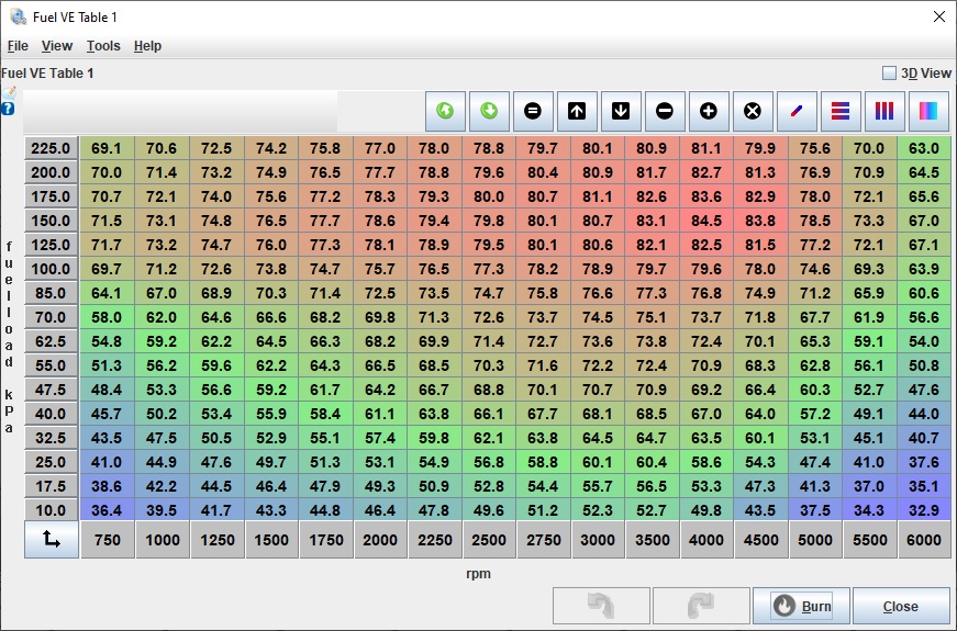

I understand you want tables that to 12 kpa but you dont need to. Granted I dont know how you ve map looks but your timing map is the same from 32kpa and down. If your ve map is the same from 32 and lower than you can repurpose those rows. Your timing is the exact same at 17 kpa as it is at 32. If your engine is ever below 32 it just uses the 32 row. And since your timing is the same from 32 to 12, you can repurpose those rows for resolution somewhere else.pmbrunelle wrote: ↑Mon Oct 11, 2021 1:17 am
According to my plan, I will set up the boost control to be able to run at 175, 200, and 225 kPa, and then I will tune those three rows (maybe other rows, depending on how much time it takes). I set up the table with 225 kPa at the top row, because I want to run the engine with that amount of manifold pressure. I suppose that with 7.4 compression and water injection, it should be possible.
That said, I realize that plans can change!
I have a bunch of resolution in the low-load low-RPM range, because that's where much of the "daily driving" happens, and smooth daily driving is a priority for me. On high-RPM decel, the engine will hit 12 KPa, so I wanted the tables to go all the way down there.
I tuned multiple rows at once. So where my 8 psi run and 160 kpa, I tuned VE and timing tables in the kpa and ve table above and below 160kpa. So I wpuld make changes in the 150, and 180 kpa cells. Thats because the computer interpolates from 4 different cells at one time so the adjacent values must be close.Did you tune each high-boost row (160, 180, 195, 210, 230) or did you just tune around your 8 psi boost, and then you adjusted the rest of the ignition map to fit with the area you tuned?
So for instance if one cell at 160 kpa and 5k rpm is at 20 degrees, and the 150 kpa and 5k rpm is at 10 degrees of timing, your computer might be around only 15 degrees of timing when you datalog your run. Yes I might be traveling through the 160 kpa cell, but it might actually be 169 kpa. Or it might be 155 kpa. So the computer grabs from 4 diff cells and takes the average.
So I think my timing table is.
180kpa
160 kpa
145kpa
If at 160kpa boost and I wanted to change the timing at 160 by 1 degree, I bumped timing in all 3 kpa ranges because like I said the computer interpolates four cells at a time. If my ups is at 165, it will use the 160 and 180 ups range. If I only hit 155kpa, the computer will interpolate between the 145 and 160. If I only bump it by 1 degree at 160, I wont see a full degree change unless I change the values in the neighboring cells. Same goes for VE
If you use megalogviewer to look at your datalogs you will see what I mean with the color change of the four cells its averaging from.
Thats the best I can explain how I made my changes on the dyno and street tuning
- Posts: 630
- Joined: Thu May 20, 2010 10:07 pm
- Location: Grand-Mère, QC
Re: Dyno tuning the new 3.9 lz9 setup.
Cool, I understand your tuning process now.
Yes, you are correct that based on my ignition table, the lower-kPa rows I have are useless.
VE keeps dropping off as kPa goes down, so I wanted to capture that in the VE table: My ignition table is only that way in order to be consistent with the VE table.

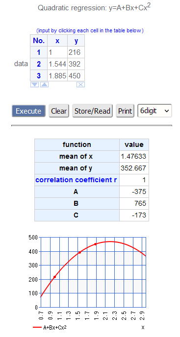

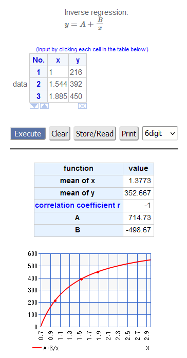

Using an estimated stock LZ9 = 216 whp, and two points with boost in this thread.
The "x" axis is the manifold pressure in atmospheres.
The "y" axis is SAE whp.
Soooo, when I think of interpolating three points, I think, PARABOLA! Oops, around 2.3 atm whp is going down... that doesn't look right.
Inverse: Looks nice enough...
15 psi:
x = 2.021
y = 714.73 - 498.67/2.021 = 468 whp
19 psi:
x = 2.293
y = 714.73 - 498.67/2.293 = 497 whp
Doesn't look like the numbers increase fast enough in the higher boost areas.
Instead, I'll try to linearly extrapolate from these points:
(8, 392)
(13, 450)
473 whp
520 whp
I don't super-trust linear extrapolation either, so I'll take the average of the above two methods:
Final answer
470 whp @ 15 psi
508 whp @ 19 psi

Pretty good guess. On 93 octane I'd say you would be pretty close. I am hoping e85 adds 20 hp by itself. Cooler, denser charge as well as being oxygenated usually gives a decent bump with boost by itself without timing being added.
This test showed a 6% gain from e85 alone vs race gas with no timing change. If my results are similar that should put me around 477. More timing could make it another 15-20. And that's still on the same 13 lbs of boost.
https://youtu.be/Z0Ac72xQvAo
I am thinking 490 whp on 15 isn't far fetched. If I can get more boost out of it, I think low 500s is there. I'll put my number at 530 on 19 if I can get there. I think my stock camshaft is really holding me back.
I guess we shall see
