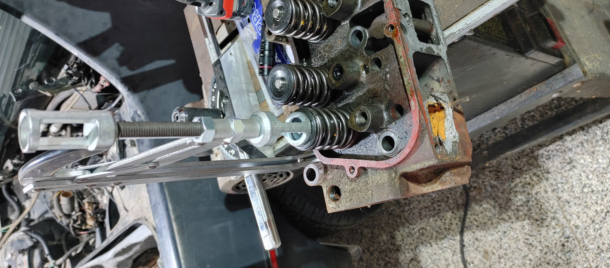

Valve spring compressor was a bust. the whole thing flexes like crazy and the triple valve springs wont budge. I'll have to use the hydraulic press at work, hopefully the cast pieces for the vice-grip style valve spring compressor doesn't fail under load.

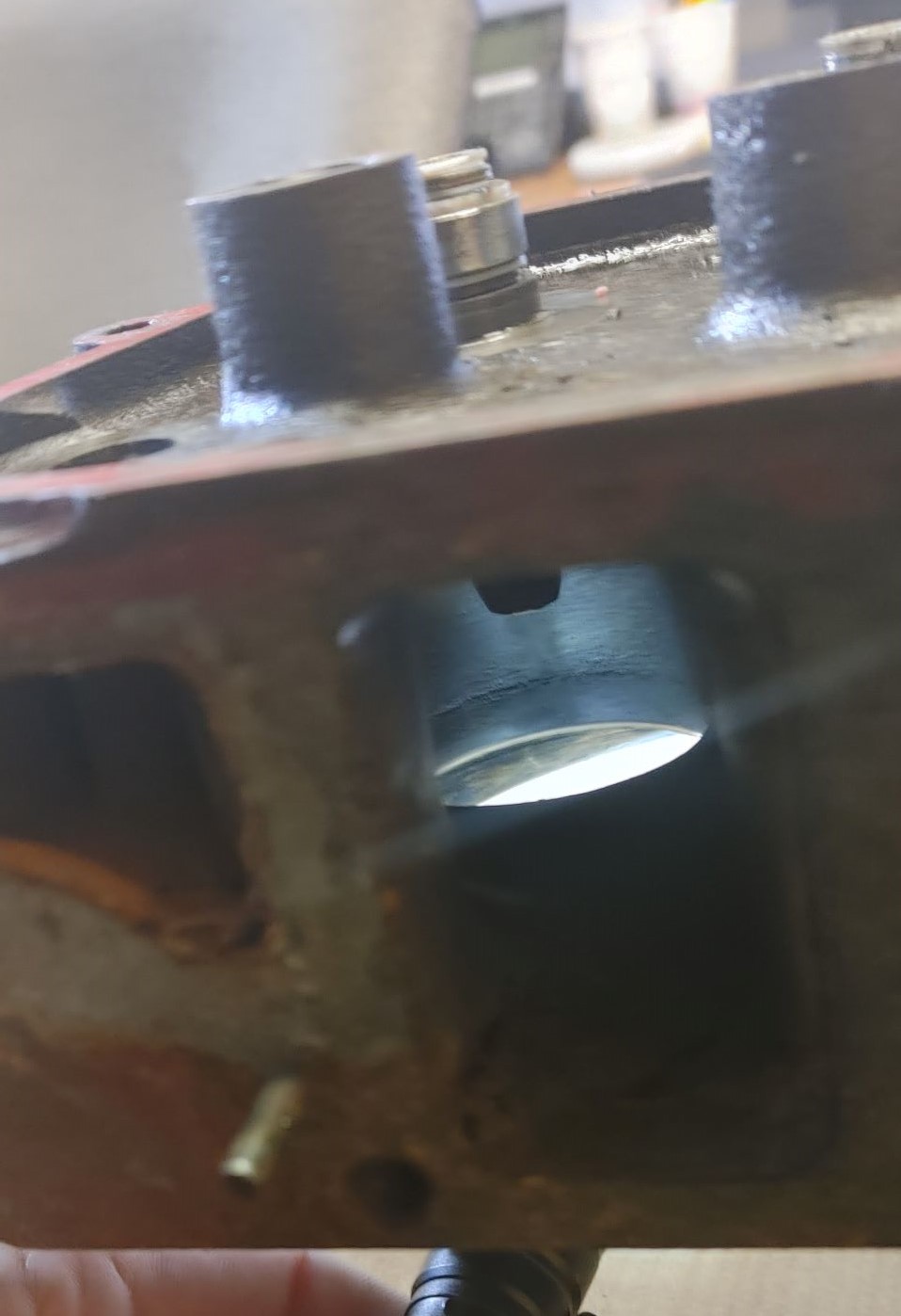

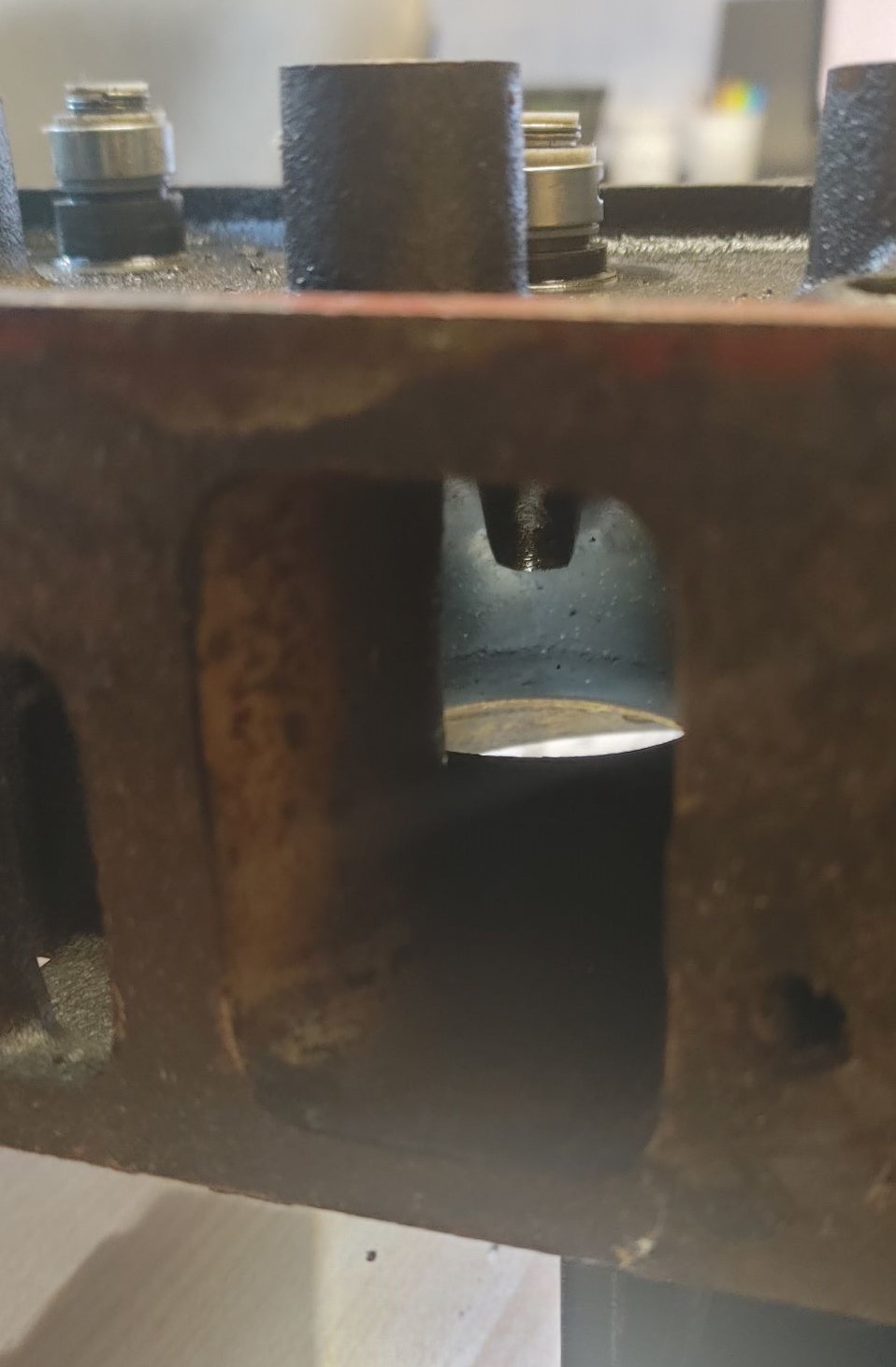

I got the head apart.

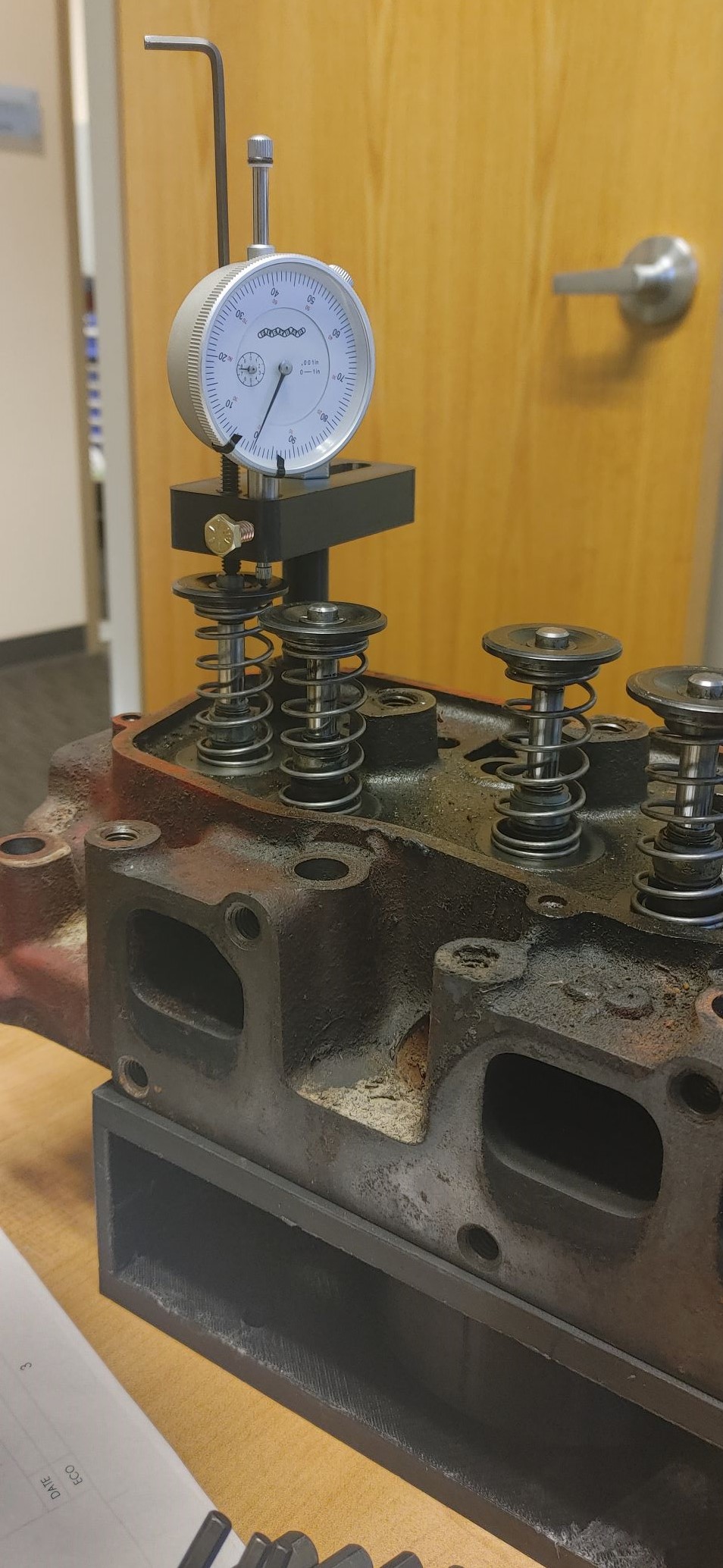

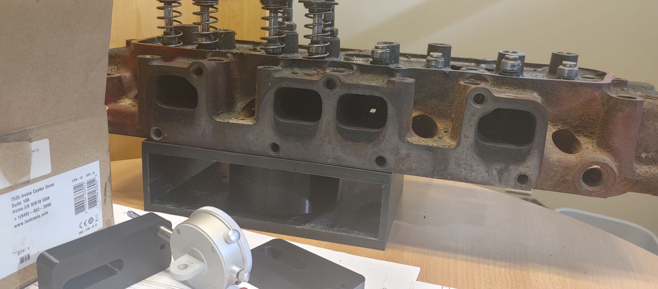

I 3d Printed some parts for use on the calibration SF-750 flowbench at work.
4.030 bore head adapter, valve pusher and indicator holder.

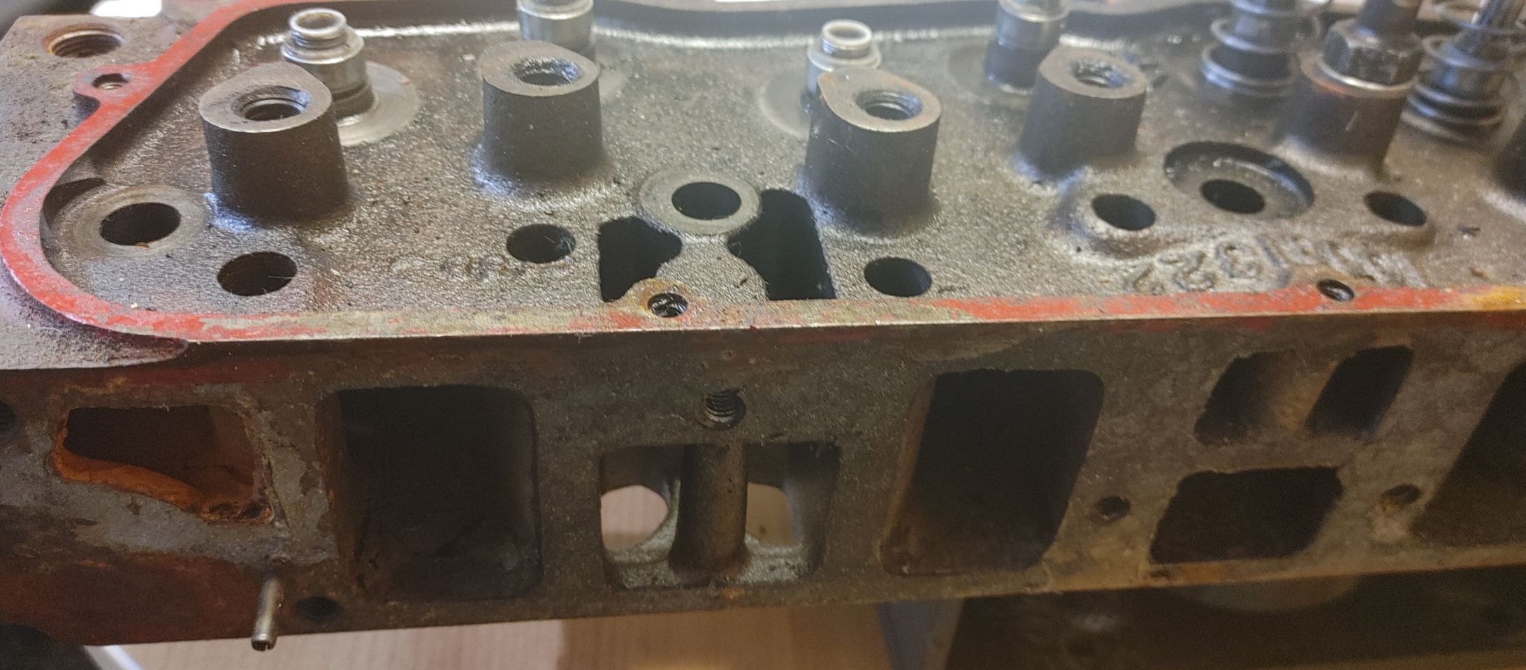

The ports on this head, Casting 10031322, has the EGR port cast in, with EGR holes in the center exhaust ports. The valves measure 2.020 Intake and 1.625 exhaust. all the exhaust ports have intrusions for the pushrod guide holes, the outside ports have casting bosses for the header flange bolt holes.

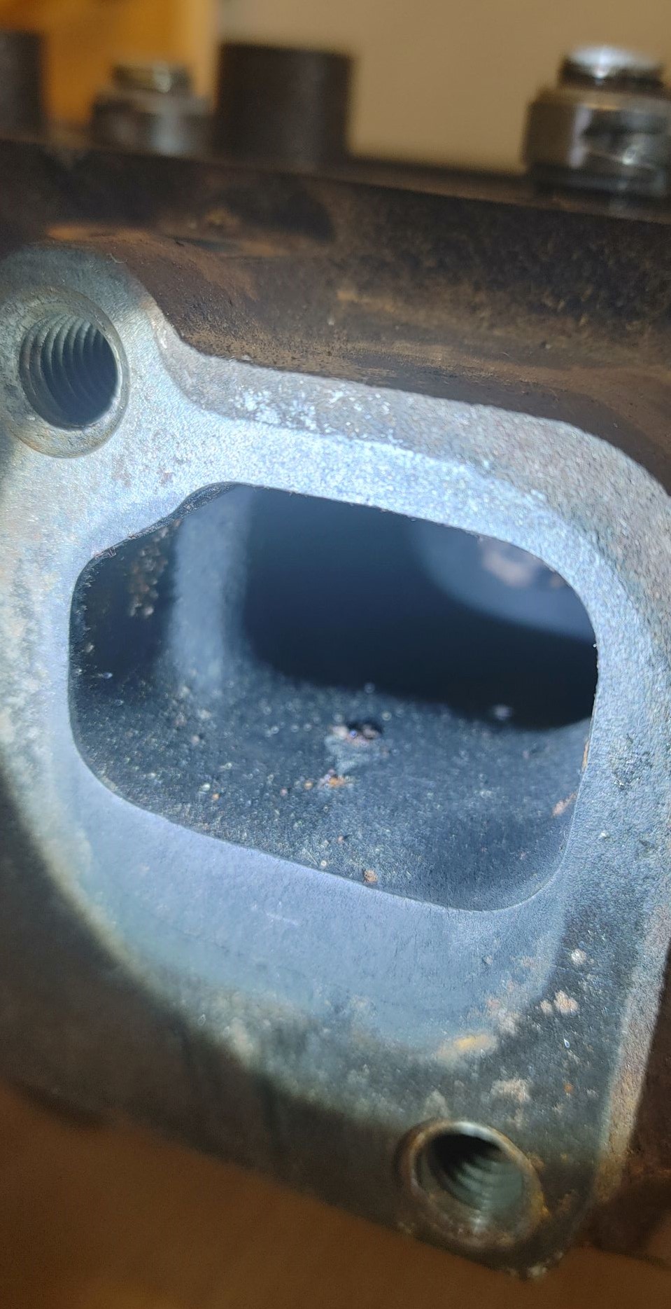

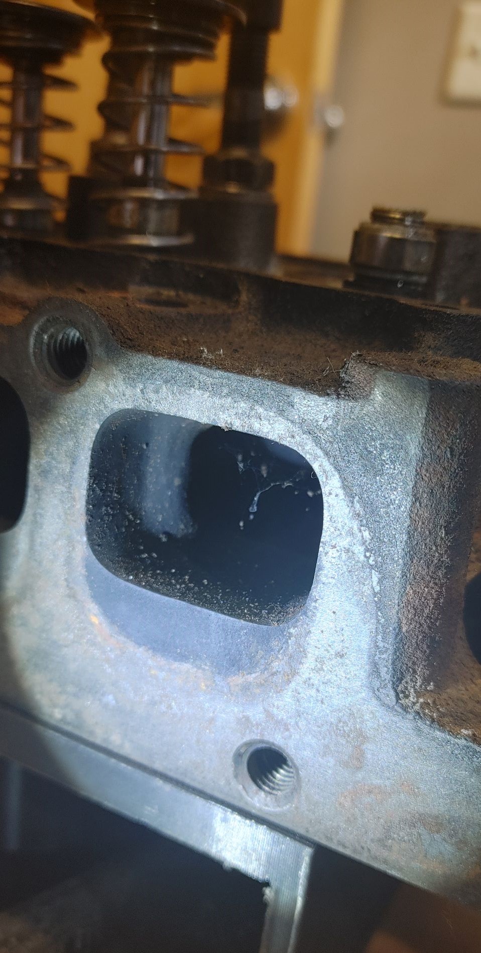

This head has been ported. It appears to be opened up a lot on the intake, but only for the first inch or so. The valve heads show a good amount of swirl in the carbon on the outside valves.
The intake ports on the outside have a large radius that blends the port around the pushrod guide, and the center ports have a more aggressive bend there. The floors are pretty flat, with a quick radius to the valve opening. I will cc the heads after I flow them, but I can tell, compared to my bare 10049801 head, the cross sectional area is much greater in the iron head.

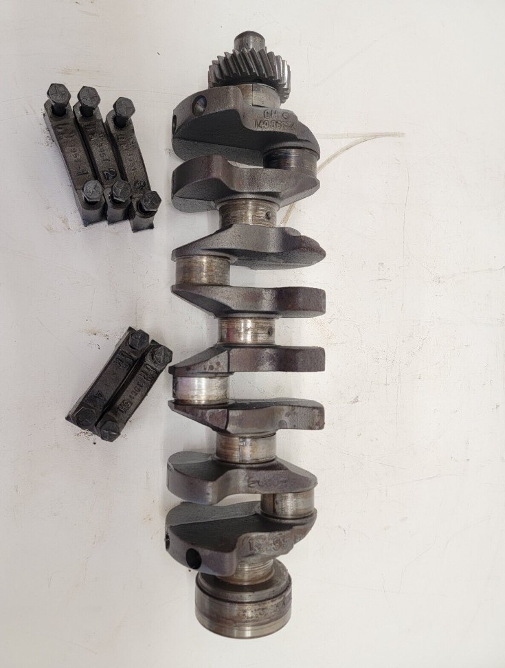

They show up for 200$ shipped on ebay, clearly need some journal cleaning.
Looking elsewhere I was eyeing some 6.200 long with 1.85 journal connecting rods on ebay for a song, with very lightweight pins. only $100 shipped, but are they still usable and straight? I can offset grind almost up to the 3.5" of the marine cranks on the SD4 crank and save a whole lot of weight.

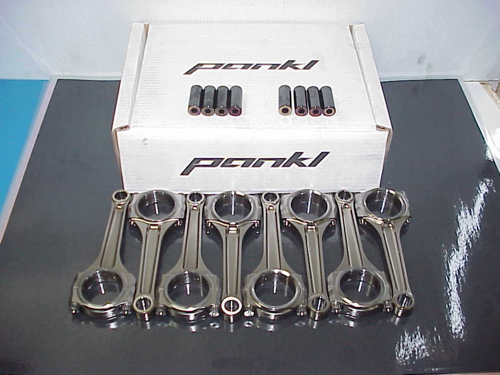

I'm going to try those Nascar rods, I will stick with the SD4 crank I have to find a shop that is willing to offset grind for a 47mm journal, I should be able to get up to the 3.5" stroke and be at 3.0L
Such a nice price, 102$ shipped, even if I have to rework them to straighten the bushings, I will be ahead of a new set.
My LQ1 rods, reconditioned because the shop said they were bent after installing the ARP bolts, were $80 a piece, plus the 65$ for ARP bolts, I was out $550, for stock PM rods.

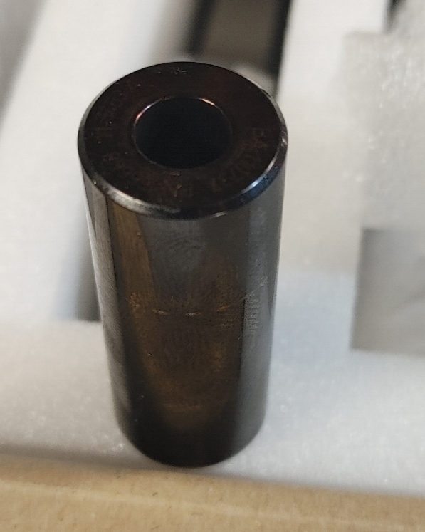

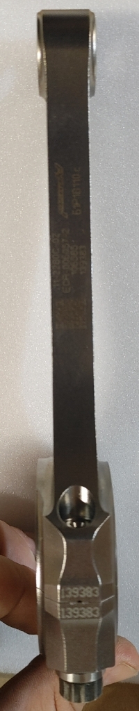

We have 8 good used Pankl I-Beam Connecting Rods with Casidiam Coated Wrist Pins.
6.200" Long -1.975"(for the 1.850" rod journal size)-.903" Wide on the Big End
.700" Wide on the Wrist Pin End
Wrist Pin Size is close to .708"
.537 grams with 3/8" Rod Bolts
I don't have weights of the crankshaft right now, SD4 crank is still in the block until i make space to pull the short block from the car. And I haven't found any info on the marine crank weight, but the parting line looks cast, the last counterweight shows a fairly shallow line, SD4 parting line looks like a forging.
Marine crankshafts existed when the SD4 was introduced, OMC 3.0L 181 engines were released in 1978. Pontiac decided still to have a forging made for the racing engine program, It has radiused counterweights, and SBC width journals .940", the marine has 1.035" width journals.
These Nascar rods should play nice with my SD4 crank better once ground, Once I find a shop and send them my crank I can see what my stroke limit actually is, Maybe I can match the marine 3.6" or end up somewhere between 3.4".
All better than 3".

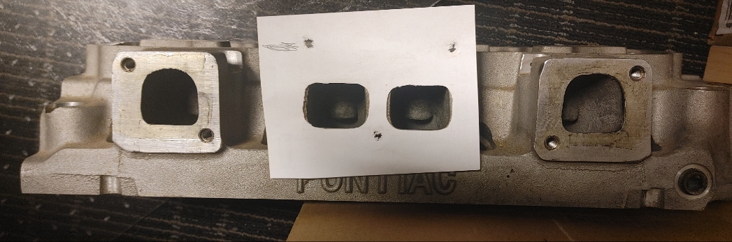

Iron '322 traces over the '801 heads. Exhaust is raised and larger than the iron versions. The intake, as ported, is much larger in cross section than the '801, I will really be interested in the flow differences and efficiency as I port it.

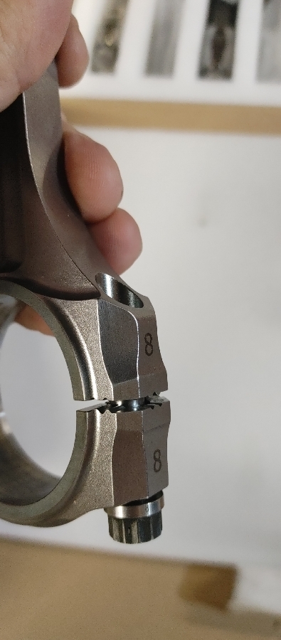

Just playing with some rods.
