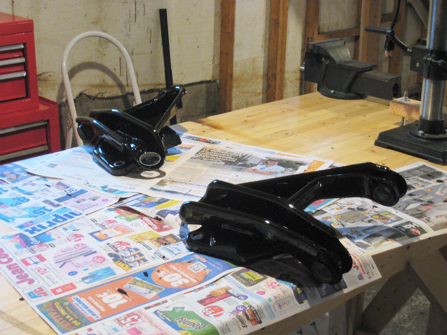

Last night was my third date with this woman; after dinner, we each painted an LCA in my basement. That was pretty cool to meet romantic and car project objectives in one go. She was good at meeting (exceeding) my painting specification for the LCAs.
I think she unlocked a cheat code in getting me to like her

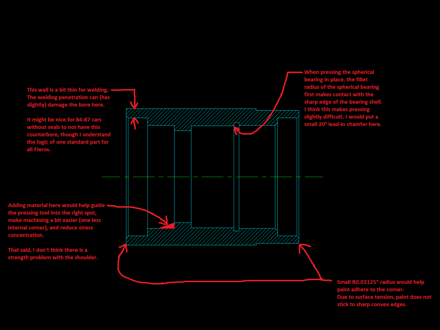

Wall thickness of the seal bore under the weld:
I had some issues with this in my installation as well. It's a compromise. Once I measure the eccentricity required by the '84-'87 front suspension, I may be able to find a seal that can tolerate that amount of eccentricity. And yes, it is more convenient--and cheaper--to use the same part for early and '88 cars, especially since that's what GM did as well.
Bearing tool guide taper/chamfer:
I see your point and I could add that to the next batch.
Radius on ends of weld journals:
I could do that as well. (Is the wall too thin or not? LOL)
Lead-in chamfer for bearing installation:
My drawing specifies a 45 degree lead-in chamfer, but the ID of the clearance bore on the outboard side of the snap ring groove limits how large the chamfer can be and be effective. The snap ring doesn't need support on that side, so I *could* have the chamfer take out some of the wall of the snap ring groove. There is a small (I think 45 degree) lead-in chamfer on the OD of the bearing race as well. Did you have any problems starting the bearings straight?
The interference fit with the bearing diameter is not very large, the preload torque for the installed bearing being the eventual metric for the "right" interference.

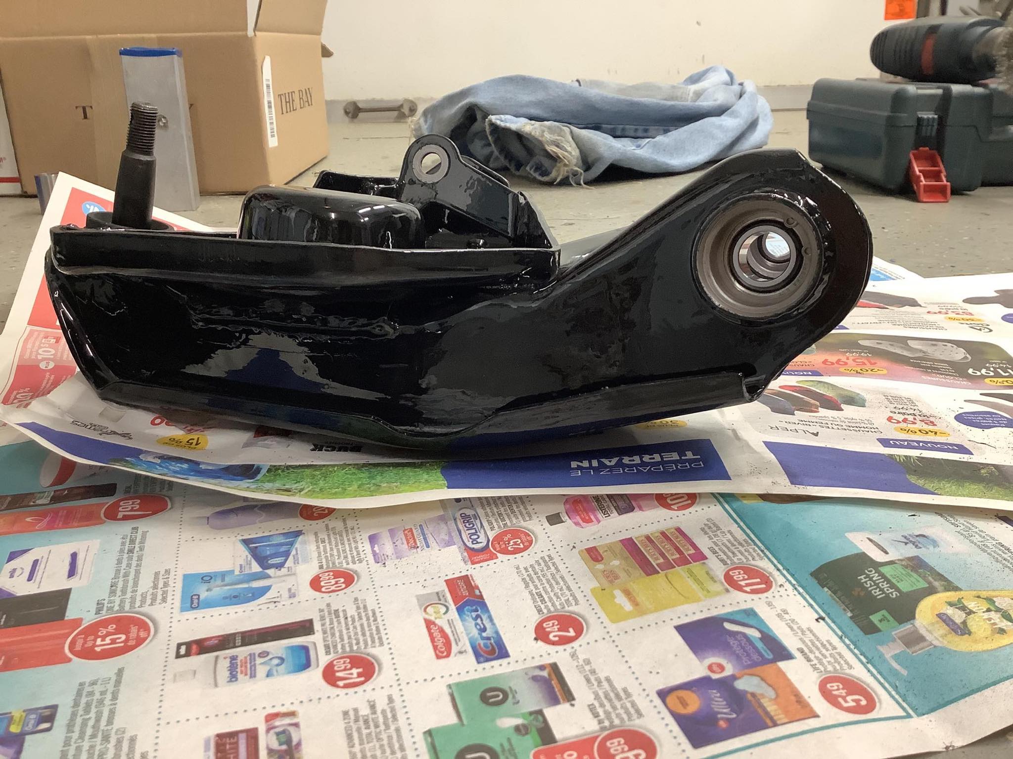

I finally installed the bearings into the '84-'87 rear control arms I had welded and powder coated
Here's one with the snap ring that retains it. The press fit is rather light in order to keep the preload torque in a range that it reasonable for a suspension pivot. Most of these are in the 30-40 inlbs range. The bearings are easily installed with a bench vice and the installation tool I designed.
Yes, there is a gap between the tips of the snap ring and the ball. However, that doesn't really matter much, since these bearings won't see any misalignment. The worst that could happen would be that the snap ring lobes would score the ball a tiny bit, but that part of the ball would never be under the race, so meh.
With the supplied Rotor Clip stainless steel snap ring, installed rounded-edges towards the bearing, there was more than adequate clearance between the snap ring ears and the ball.

I'm setting up for the next batch, which means revising the drawing. Time to incorporate this great feedback.
For some reason, I had it in my head that the OE bushings installed from the front. This doesn't make sense, because braking force would tend to unseat the bushings from the control arms. Actually measuring the control arms (again!) makes it clear that the OE bushings are installed from the rear. Thus braking loads tend to seat them more firmly in the control arms. D-Ohh.
- Correct orientation of bearing seat relative to control arm
- Lead in chamfer for removal tool access
- External radius for paint adhesion
- Lead in chamfer for bearing installation(?)

Technically, if you want to spec the chamfer large enough to ensure that there always will be a chamfer (very small chamfers may not appear in the final part), the chamfer could go out to a slightly bigger diameter than the bore "outside" of the bearing bore, as the snap ring is never pushed in the direction where it would have to bear against the chamfered face. But, this is a detail; I'll leave this area to your discretion!The Dark Side of Will wrote: ↑Mon Feb 19, 2024 10:40 am I have a lead in chamfer in the bearing bore specified at 45 degrees, but only out to the ID of the bore "outside" of the bearing bore.
Correct, that is what I meant.The Dark Side of Will wrote: ↑Mon Feb 19, 2024 10:40 am You are thinking in the sense that the axial dimension of the chamfer will be greater than the radial dimension?
