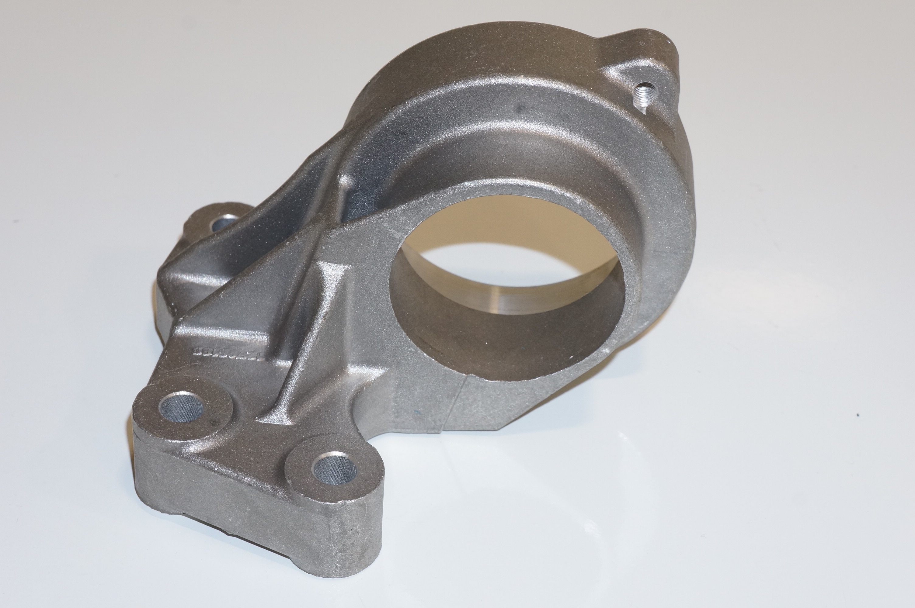

So..... the carrier bearing I'm using is for the late 2000's Saab 9-3 Aero V6 turbo with F40, see below:
https://www.esaabparts.com/static/image ... 795185.jpg
This bolts right up the LFX/LLT etc.. but not exactly to the LF3 / LF4 due to the turbo oil return being offset behind the lower right bolt hole in the bracket. I removed the lower right bolt mount from the bracket but not sure if I need to tie in another support to the block. The only 'easy' way would be to tie in the two bearing retainer bolts(longer of course), one is visible on the right side of the image back to the block. Although my tig skills are improving I've never welded cast aluminum which is pulling me down the bolt / tie-in path.
I'm not too familiar with the forces exerted on a carrier bracket / bearing.
My only other option would be to cannibalize the XTSV carrier bearing bracket, which does bolt to the block but is way out of alignment and much further offset from the block than what the F40 intermediate shaft requires, and tie that into the block.
Thoughts?
