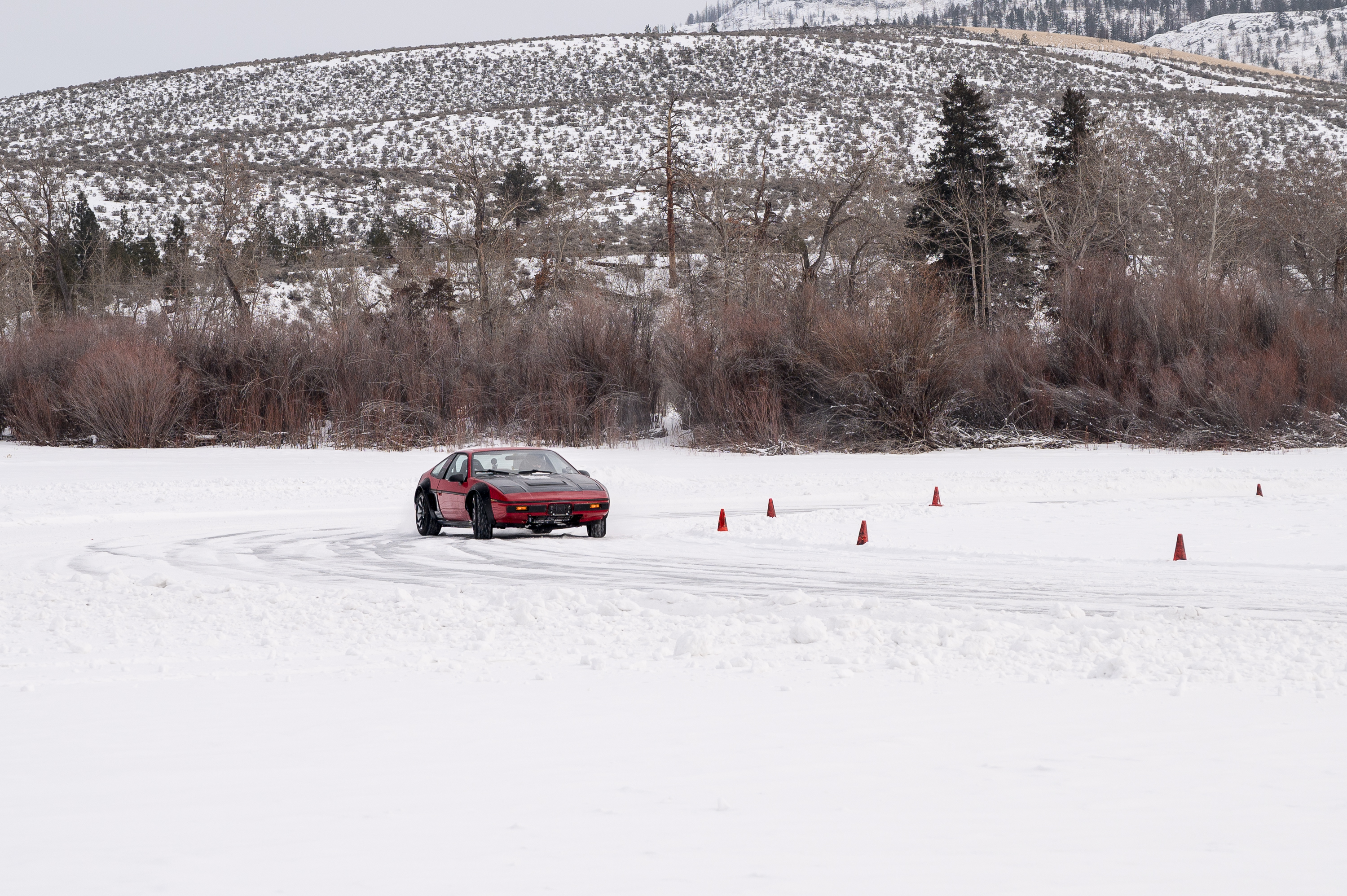

With that she was on the road again. Did a few hours of successful shakedown, and then it was time to swap tires hit the highway for the first real competition outing - ice racing! I'll start a thread in motorsports to give full summaries of the competition days, but the car performed pretty well and had no major issues (the largest problems were a coolant cap vibrating loose, and that the startup fueling is not totally dialed in on the engine tune yet, so convincing it to fire up at -15C was a bit of a challenge)
The highway drive up revealed a couple things as well - one, the car is very loud inside at some harmonic rpms. That might be due to the very stiff poly motor mounts, so swapping those down softer is on the list. The speed sensor isn't working for some reason, so I was relying on GPS speed, and also the reverse lockout solenoid is not wired up, so shifting into 6th was occasionally accompanied by unpleasant gear noises, so I tried to minimize the number of times I did that.
Mandatory pic of sliding around on the ice:
