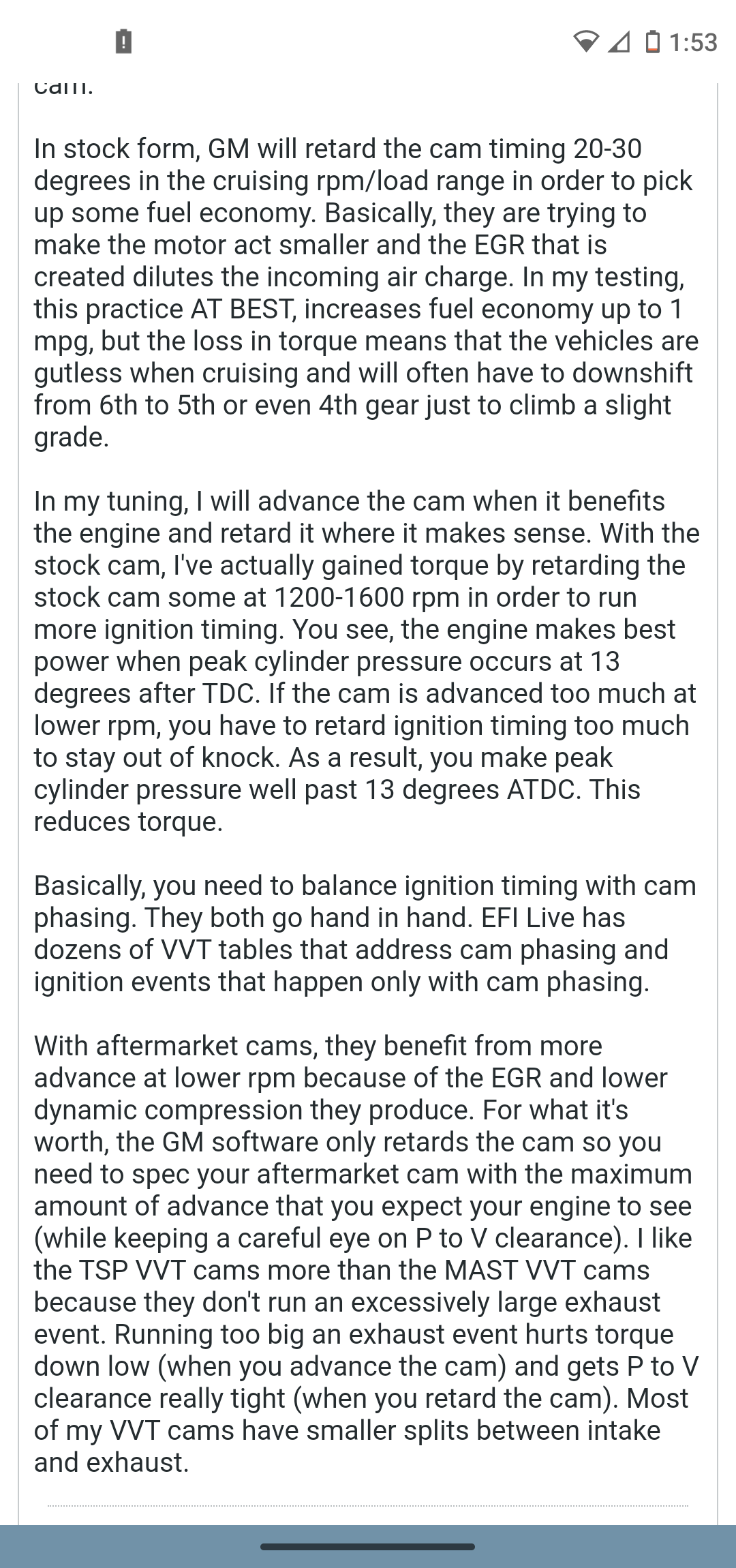

The following opinion is based on years old data, so YMMV:
The selection of valve events that allow LS/LT engines to pass OE emissions requirements is pretty narrow. This is why those engines have low original specific output and wake up so much with bigger cams... the OE cams are restrictive for emissions reasons. VVT allows greater flexibility in meeting emissions, and broadens the torque curve. The emissions aspect is the primary reason, though. Remember that even direct injection is used for emissions and fleet fuel economy reasons, not power.
So if a bigger fixed cam can meet or exceed torque output of the factory VVT setup at all points, why go to pains to keep VVT?

Vvt angles have to be dialed in at every rpm. If you can swap in a non vvt, make more low end tq.and high end HP, over a tiny vvt cam, and you don't have to tune all the vvt, and you spend less money, it's a no brainer. THATS why there wasn't a big market for them

Upgraded vvt cam ,but phase limiter has to be installed. Lost tq and HP all the way up to 5200 rpm. Just like going from a non vvt stock cam, to a 220+ duration non vvt cam.
