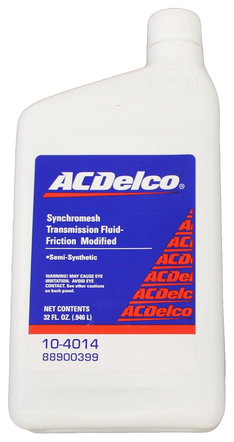

GM Synchromesh with friction modifier: GM PN 88900399; Delco PN 10-4014
32 floz container
