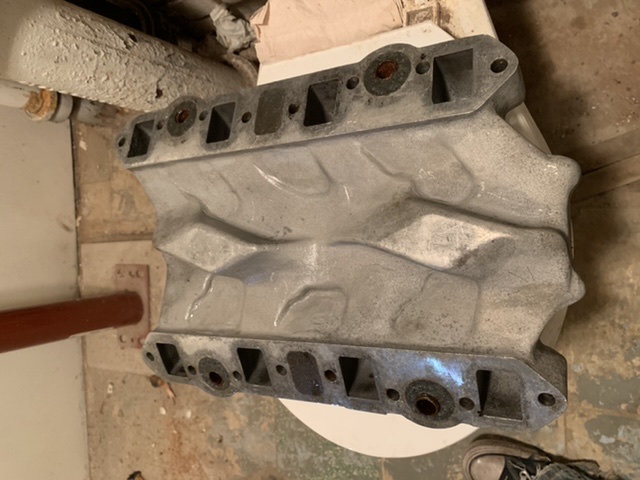

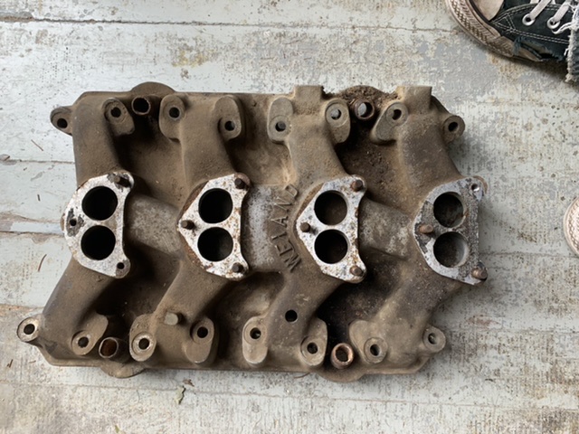

I did a Desoto hemi intake and it worked, but I had to flip the part to get all of it.
A 3x00 intake fits in one shot.

Looks fun. Great 8 Pack! What did they call those? A DeSoto Hemi would not have PCV + EGR grime inside it though
I'll check the dimensions... the Northstar intake may be too long, since it has the throttle body on the end. Also, if it's in the tank horizontally, it needs to be rotated around its long axis to get all the air out, so the tank needs to be fairly deep for that.
