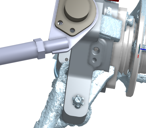

The above swaybar endlink image is actually part of a set of images I took for scanning. The 3D model looks like this when sharing space with the new knuckle.
I've been bouncing back and forth between integrated and bolt-on steering arms. Since clearing the swaybar at full lock requires reworking the steering arm I'm going to do another design iteration with a bolt-on arm and see how things look. I would really like to be able to swap out the stock style arm for a clevis to use a rod end with but if I end up making these for others I don't want to force that decision.
Re: '88 wheel bearing and hub upgrades
I like the idea of the bolt on steering arm, it adds an additional tuning point that you can use to improve the car.

You can keep the one piece design and the production process you'd envisioned by keeping the arm straight, but moving it outboard. The outer tie rod boss would then be a projection in the inboard direction from the "flat" steering arm. Incrementally heavier? Yes, but it solves both the packaging and production difficulties.

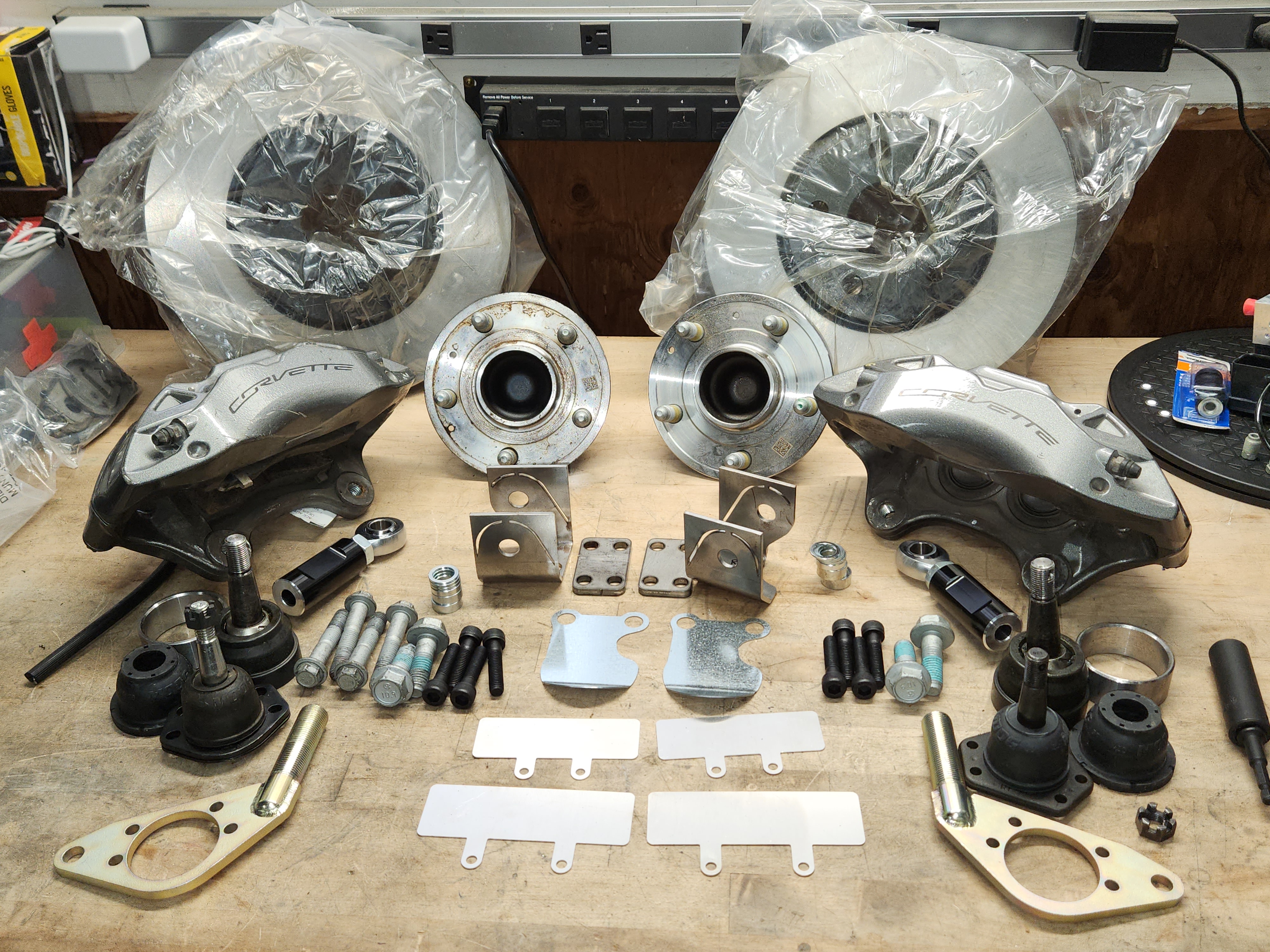

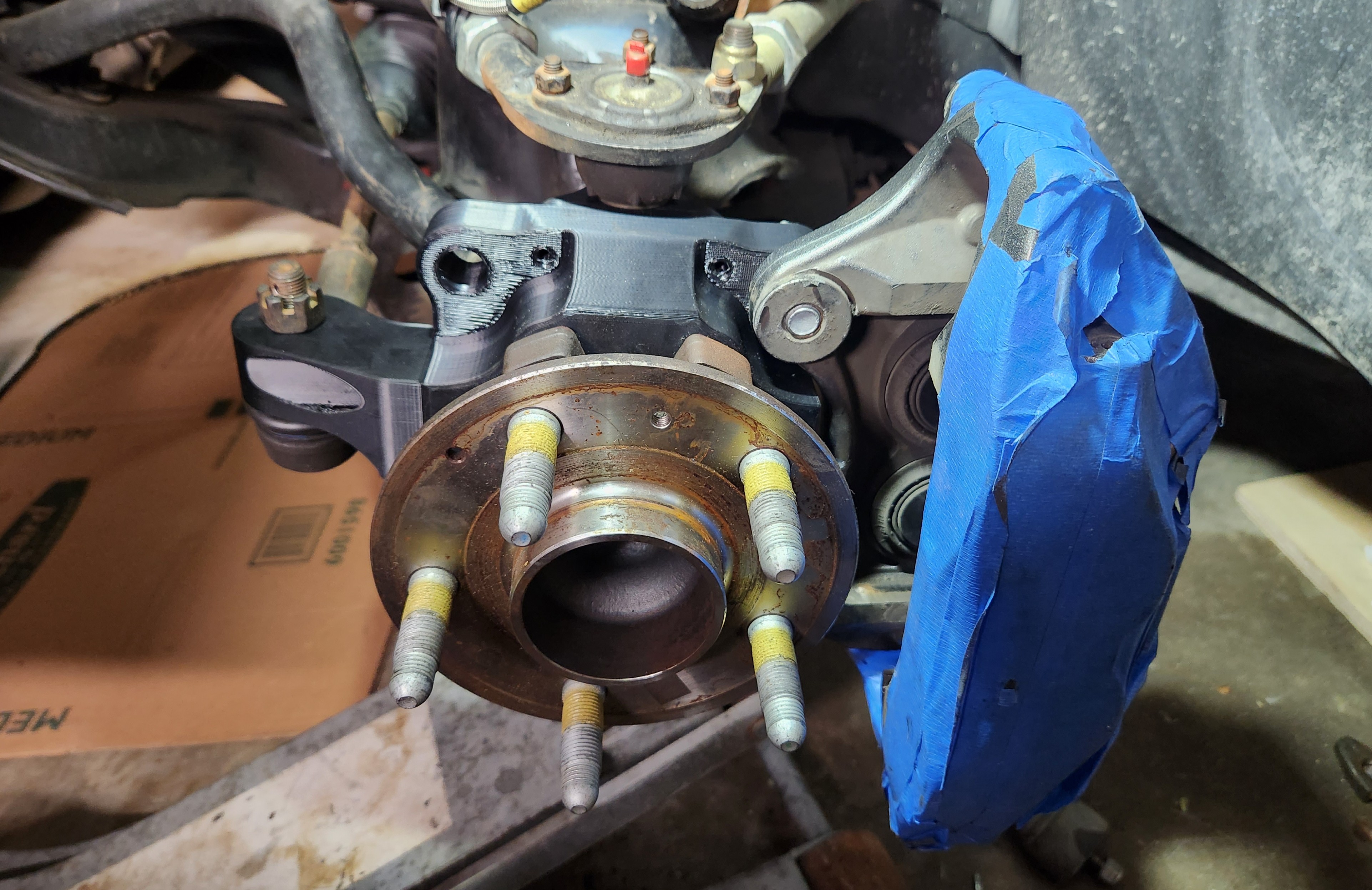

Successfully test fit the C8-based knuckle! Same part can be used on left and right sides, just a different steering arm. I have arm designs for rod ends (with adjustable bump steer) and a stock taper-style arm which you can see here.
Outer tie rod and UBJ are for a C4 Corvette. The outer tie rod fits on the stock Fiero inner. The C4 UBJ shares the same bolt pattern as a K5208 upper ball joint but has a longer stud taper to work better with an aluminum upright. Lower ball joint is K6145 with a steel taper adapter sleeve to increase the surface area bearing on the lower ball joint boss. K6145 style BJs are available with various stud lengths as a geometry tuning aid.
Hopefully will have some metal parts before spring.

Yeah the K6145 is a press in style but larger OD than the Fiero ball joint. 1210-109 here: https://www.qa1.net/assets/uploads/docu ... ess-In.pdfThe Dark Side of Will wrote: ↑Mon Dec 26, 2022 5:40 pmGood finds on all!Series8217 wrote: ↑Sun Dec 25, 2022 6:55 pm
Is the K6145 the one we were talking about recently (I think we were talking about recently... Can't find the convo now...) that does not fit the factory lower arm?
Yep I am using the same pattern orientation as the C8 knuckle. The bolt pattern nicely straddles the upper and lower ball joint bosses.I had occasionally been mildly frustrated by trying to package a 3 bolt bearing flange. Is the rectangular pattern oriented vertically like that on the Corvette knuckle?
The 3 bolt C5/C6/C7 bearing is a problem for the Fiero knuckle because one of the bolt heads wants to go straight through the LBJ boss.
Speedtech ran into the same problem with their forged AFX knuckles (C7 bearing) since they wanted a symmetrical design to save on tooling costs. Their solution was to drill a hole in the wheel hub flange and install the bottom fastener from the hub side. So you have to keep specially modified hubs around for spares. Not a huge downside but it's not really elegant.
In my earlier design I rotated the pattern and came up with a workable layout but it necessitates a handed design and one of the bolt heads wants to share space with the swaybar endlink at full lock.
I'm working on finalizing the bolt-on steering arm then I will send out some RFQs.

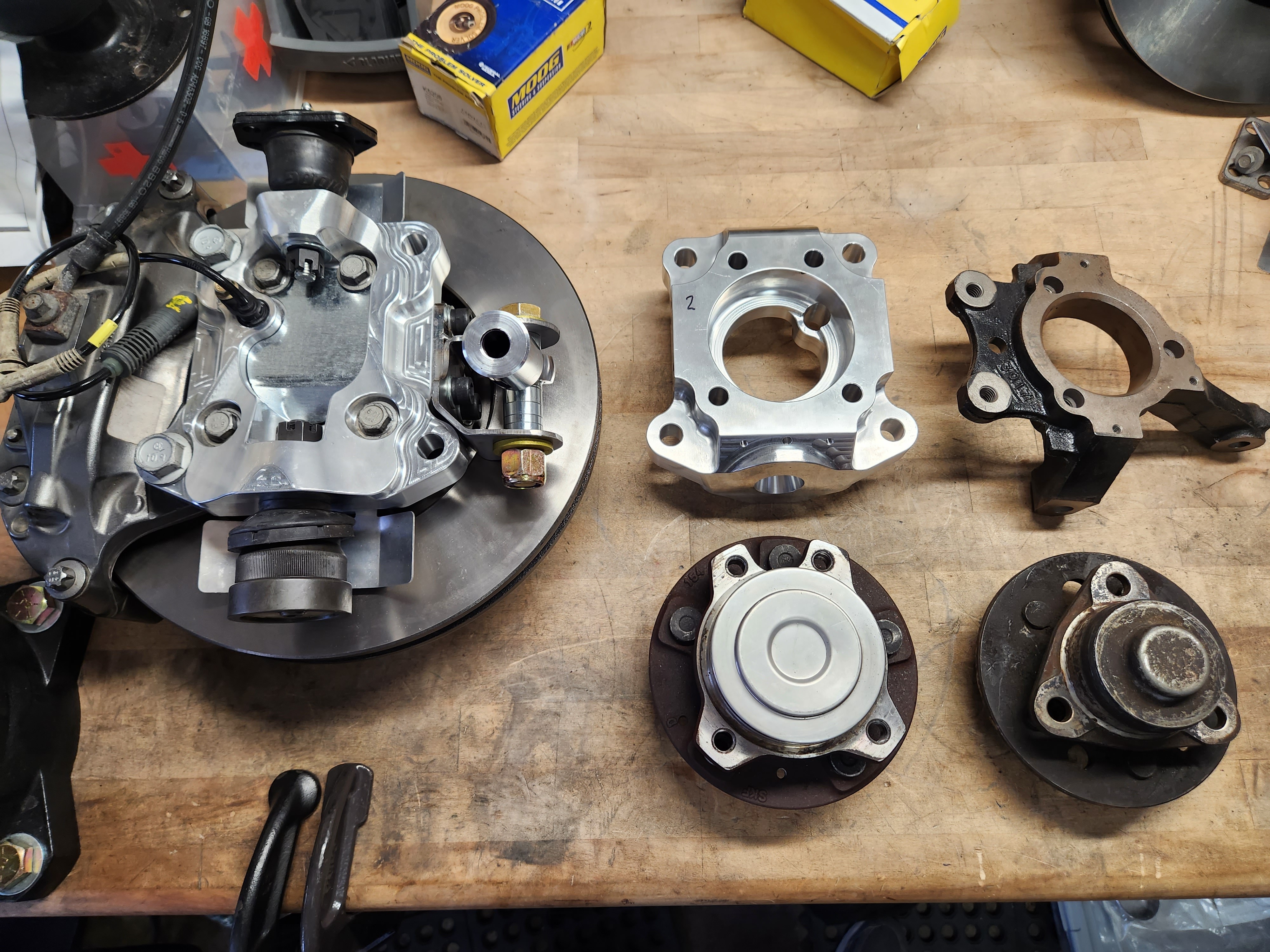

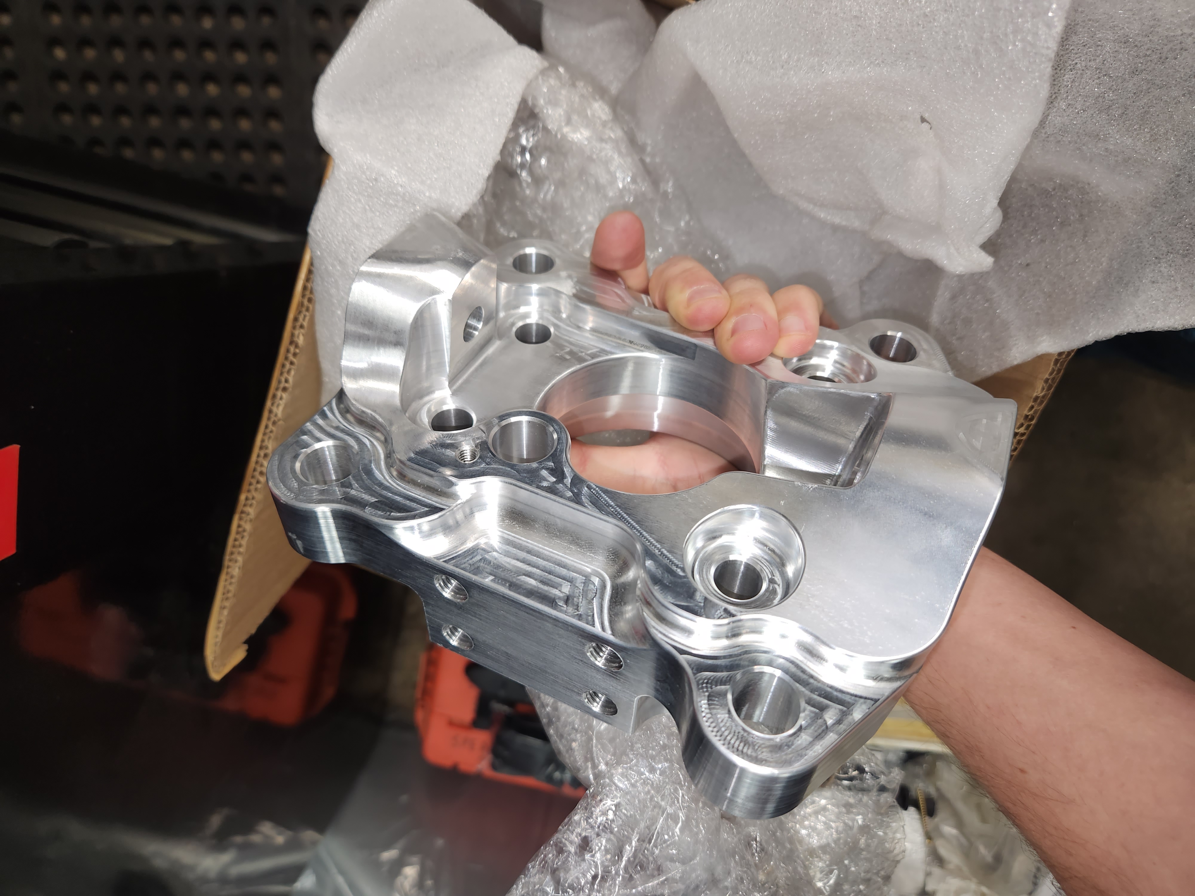

Things are getting real...
The first prototype billet uprights for the 88 Fiero have arrived.
Feature highlights:
Massive wheel bearing strength upgrade as well as stronger ball joints. Inexpensive 4 pot Brembos (Camaro6, C7, and C8 Corvette), 5x120 bolt pattern for wheels (BMW fitment with hubcentric rings). Brake rotor size options from 12.6 inches up to 15.5 carbon ceramic with no adapters required other than rotor centering rings for some options. Bump steer is fully adjustable using spacers. Ackerman can be adjusted by changing the bolt-on steering arm.
Feature highlights:
