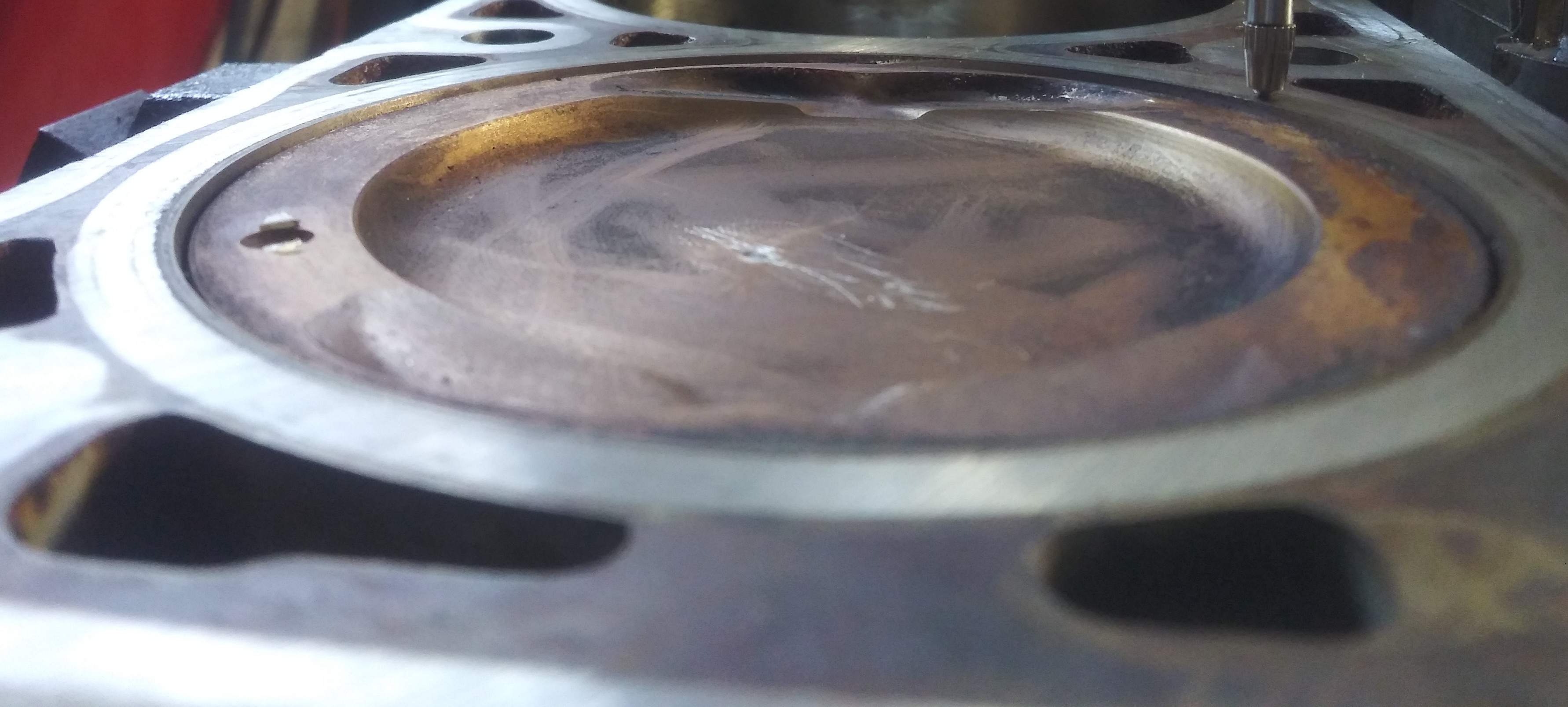

I took this pic a while back. This is a stock 3900 piston. It was tough to get an accurate measurement but it was around .036 in the hole give or take.
I measured a non factory headgasket with approx .057 crush with some feeler gauges.
There are some drop in forged ls1 pistons that will work on factory rods for anyone wondering. Aftermarket hypers too if available.

Shaun41178(2) wrote: Sat Jun 12, 2021 6:11 pm 20210508_191822~2.jpg
