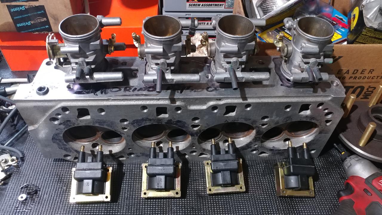

Maybe I will collect beer cans for a few months (practically free), build a 3d printer for $500, print a form in plastic, build cheap furnace for $100, mix some sand and clay for $20, build a flask from scrap wood, and use 4 2.8 throttle bodies for a sub $800 ITB setup,
But, I can buy some Chinese ITB's on fleaBay for less than $700 and cut, weld. grind, repeat for less money still.

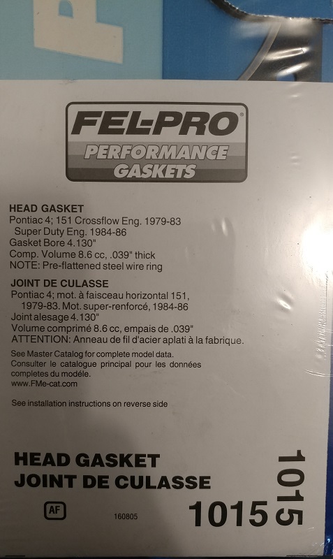

Ive been havign the itch to get to work on this during spring. I found the SD head gasket on summit for $44. No MLS gaskets available off the shelf that I could find.

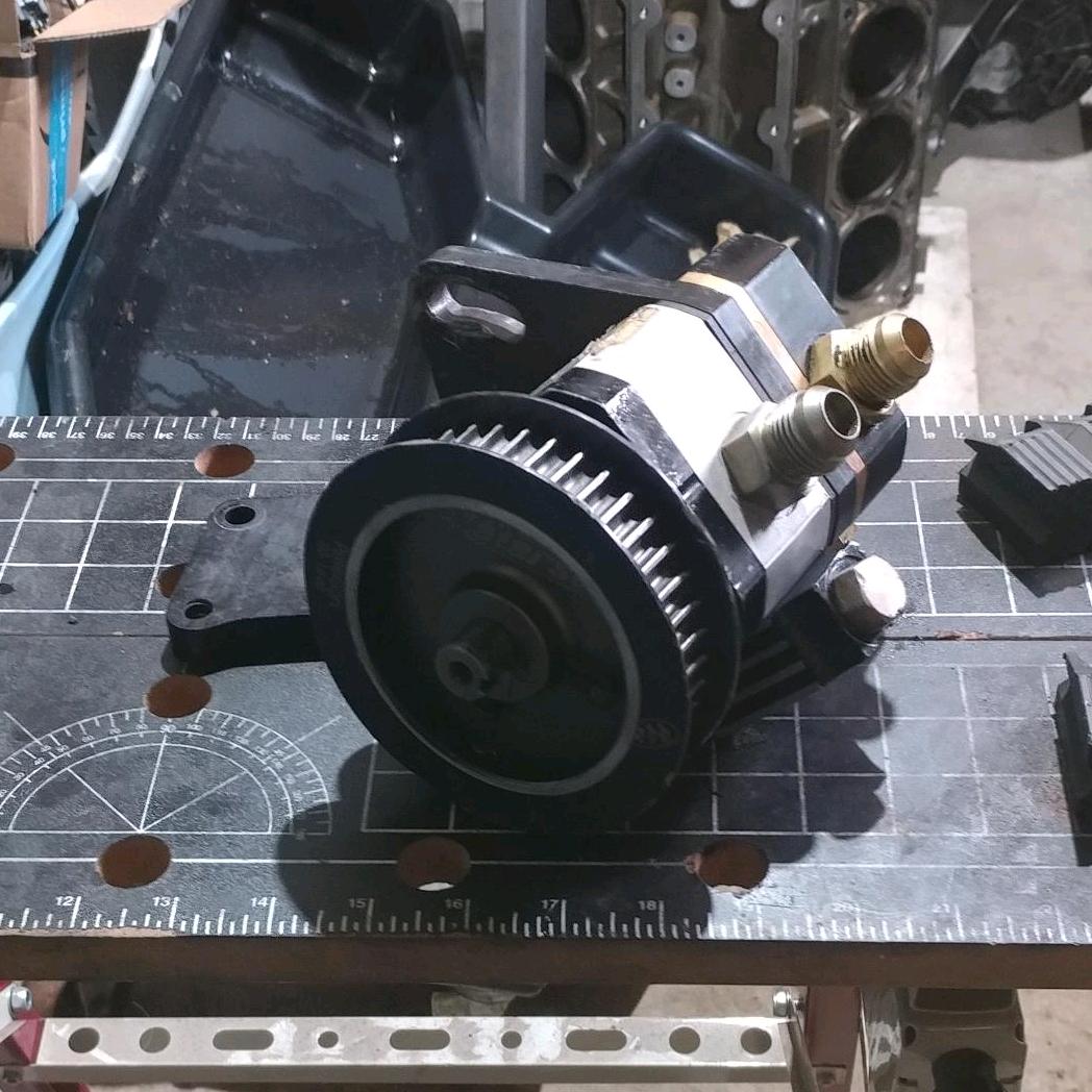

I found a reasonably priced 2 stage oil pump on ebay last week.

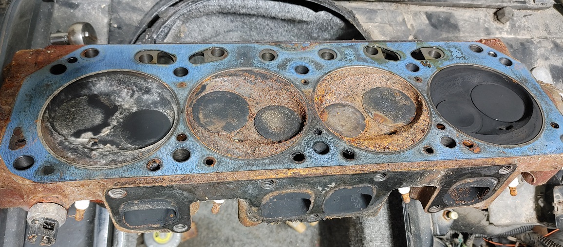

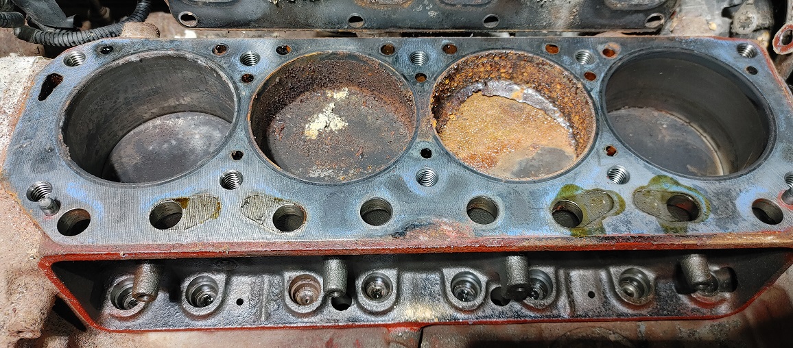

Finally Pulled the head off.
Not Pretty.
Valves are 2.010 Intake, and 1.6" Exhaust
Lifters where Hydraulic Flat tappet, beside one having some rust on the cup all the sliding surfaces looked clean.
No pistons show signs of damage, but the bores are scuffed bad, and the obvious pitting on number 2 and 3.
The bore measured 4.015 with my caliper.

Ill be calling the local engine shops to see about sleeve costs.
If that's a bust, I've got a 2.8 V6 for this car.
The differential is also broken in this thing too. There is about 1/4" of play and in the axles and the spin completely independent of each other.
