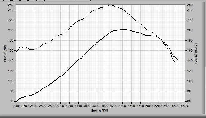

It's gonna run a microsquirt amp. Vvt is being deleted for simplicity of swap
I have yet to see anyone who kept vvt with an micro or megasquirt do a Dyno to see where their power peaks.
However j upon did dynod his with his modified vvt and it wasn't dialed in correctly. I believe power fell off before 5k rpm.
Tuning vvt on a dynod will be too costly. Lnj cam peaks around 54-5600. Vvt peaks at 5900 on gms provided Dyno chart. We are not giving up much by eliminating vvt.
We are also ditching that dual vane upper intake and going with the lz4 upper. Oh no! "But the vane allows more low end torque!". The 3.9 produces enough low end already people.

Shaun41178(2) wrote: Wed Nov 29, 2023 8:51 am It's gonna run a microsquirt amp. Vvt is being deleted for simplicity of swap
VVT doesn't change peak power much... it just broadens the torque curve. That is worth something. Area under the curve is one reason Teslas are faster than ICE cars with similar power/weight. I agree that there's a point of diminishing returns, especially if a mechanism is complex and trouble-prone, like many manifold flap actuators can be over time.

J upson who knew his vvt cam was not dialed in correctly but dynod anyways just to show what can happen. This was a gtech style road Dyno. Drastic power drop.

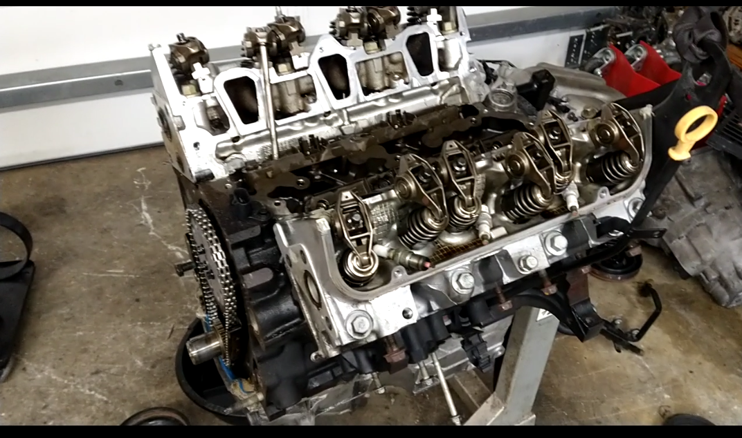

Here is the current state of the engine. Lnj cam in, ready for some reassembly.
