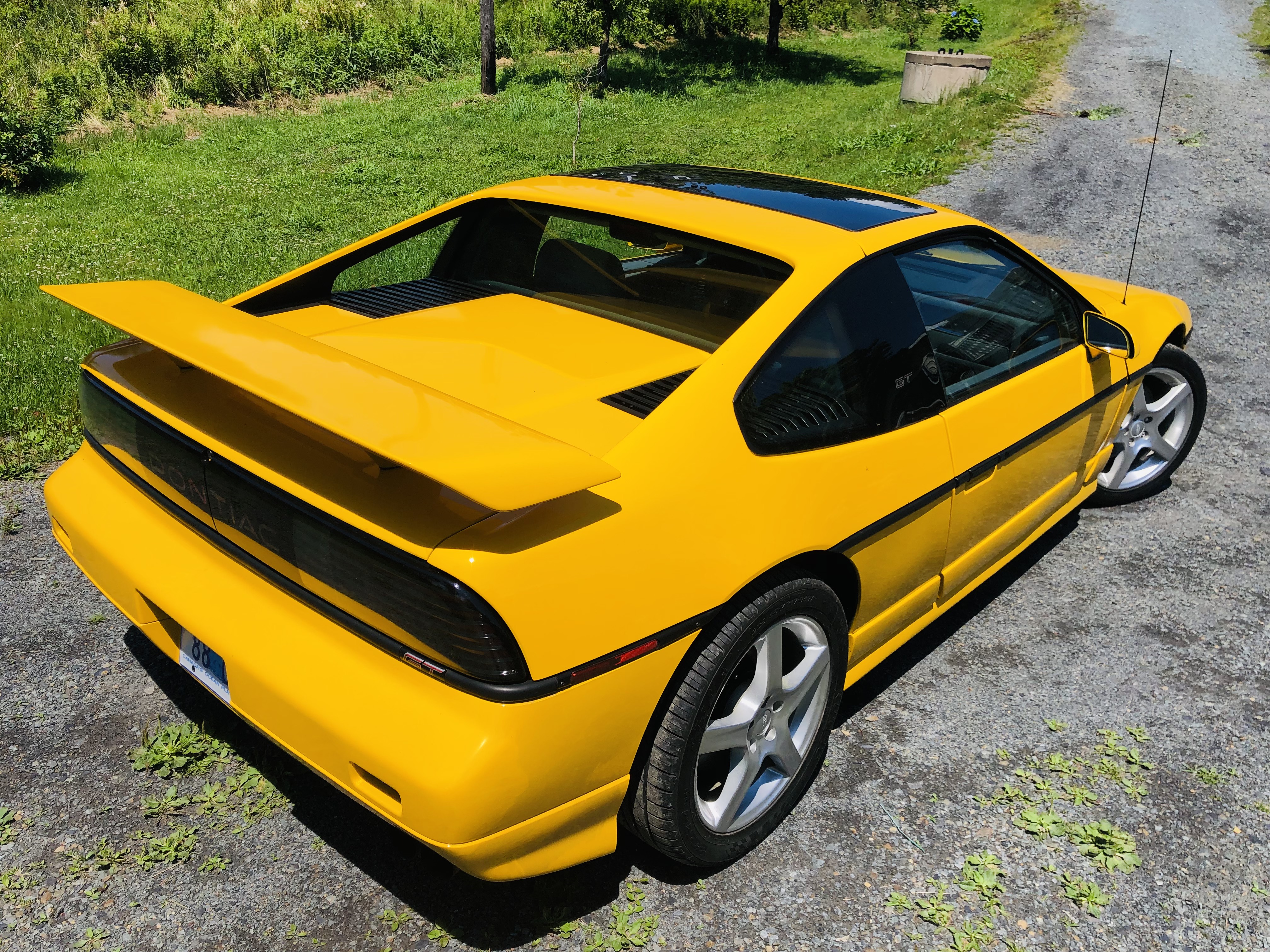

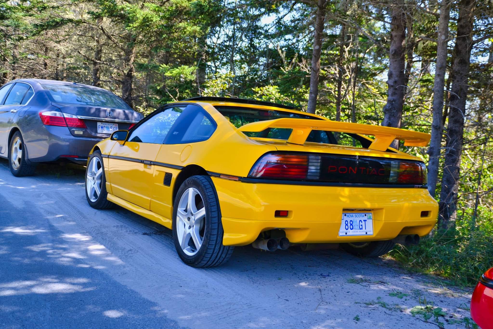

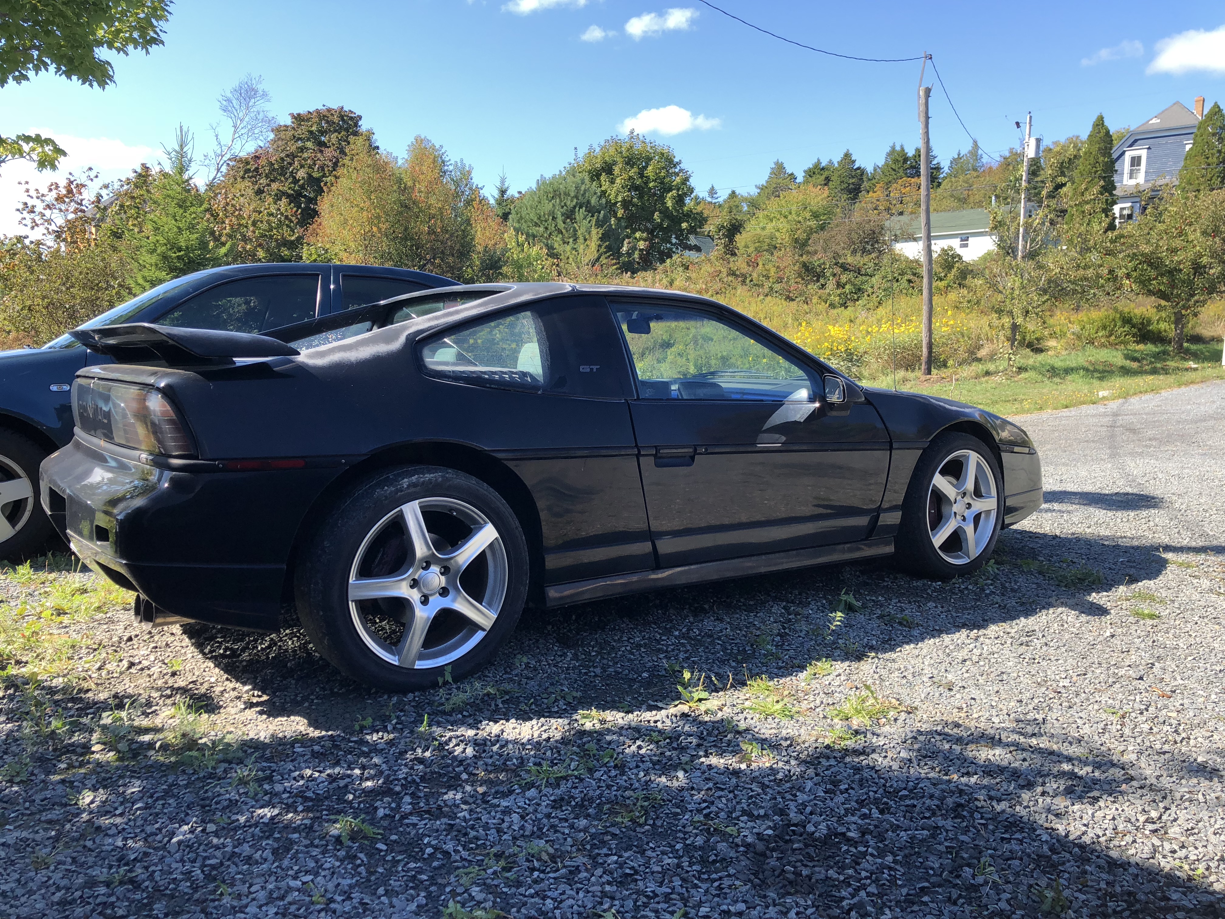

So after a long time, like 8 years now this hooptie has been just sitting off to the side letting the elements destroy it, I did drive it very little back in 2014 but since then the collection of Fiero's became more of junk sitting in the way than anything else and I came to the realization I wasn't going to put both back on the road so debating between the 88 GT T-Top and the 88 GT with the 3800NA swap I sold off the T-Top and kept the 3800 swapped one. It was the better overall car.

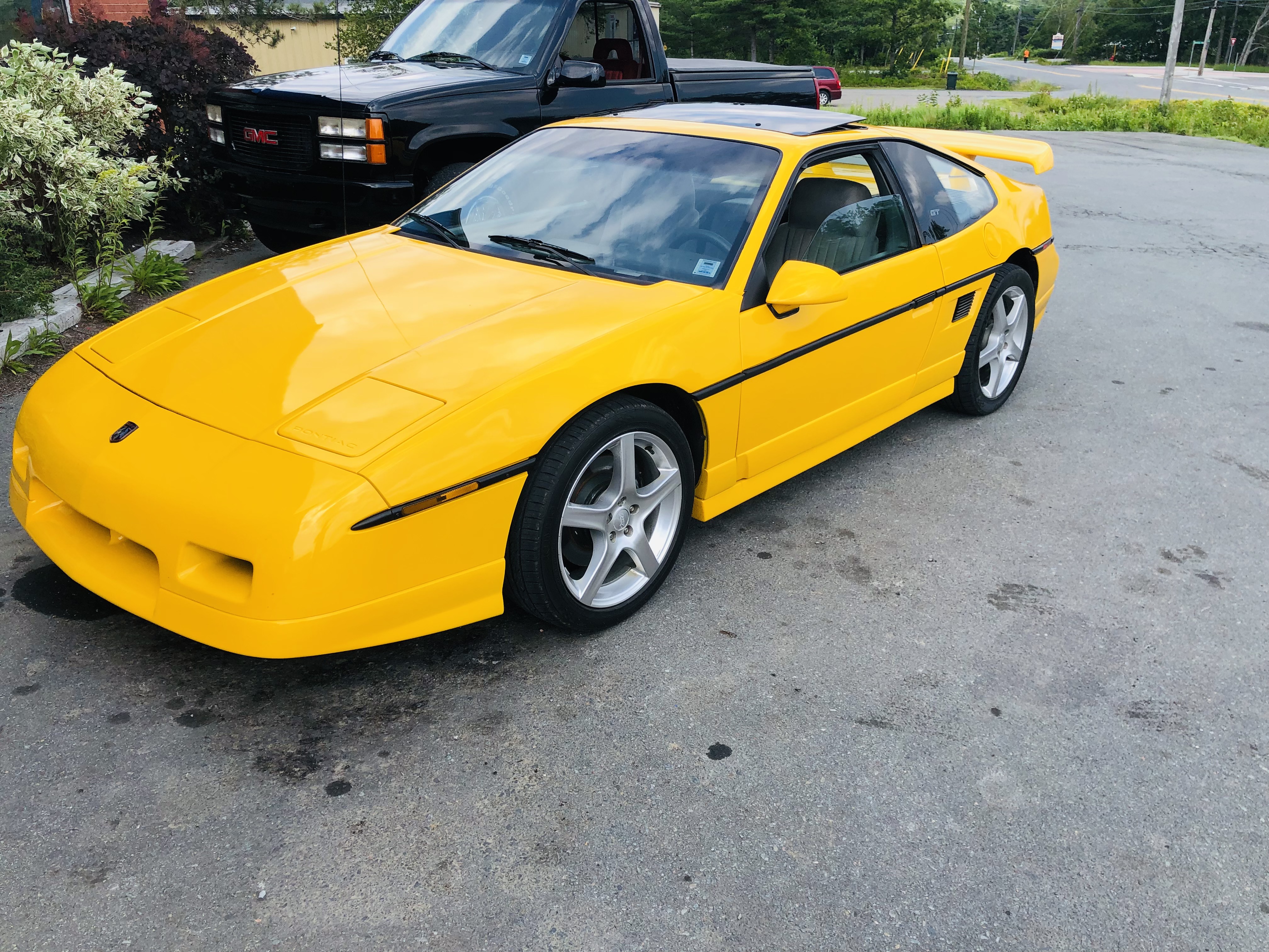

This spring I decided to finally make a nice Fiero, one last hurrah! so after way more money than I planned to put into it getting it as close to new as possible it's almost there. I got it to a point where I didn't feel ashamed driving a raggedy ass car. While not finished yet I have been driving it and am surprised how actually decent these shit boxes are once you address the worst bits ( 70's Drive train, brakes, tires ).
Here's what I had to work with, a Badly weather deteriorated paint and windows, 20 year old tires... usual shit.
And here it is at this stage
The Paint is pretty good but it needs to go back for some redoing but I told the guy I'd drive it for the summer and he could have it back through the winter when it gets slow. I guess I'm being too anal at this point.
Geez what did I replace? Alot. I'm not gonna be that guy that lists everything right down to the air filter.... I put the 12 inch brake Rotors on it and the S10 Brake Booster which doesn't make it brake harder but that booster does make the brakes feel like a modern car which is a bonus in my book.
I did replace the Brake hoses after this pic

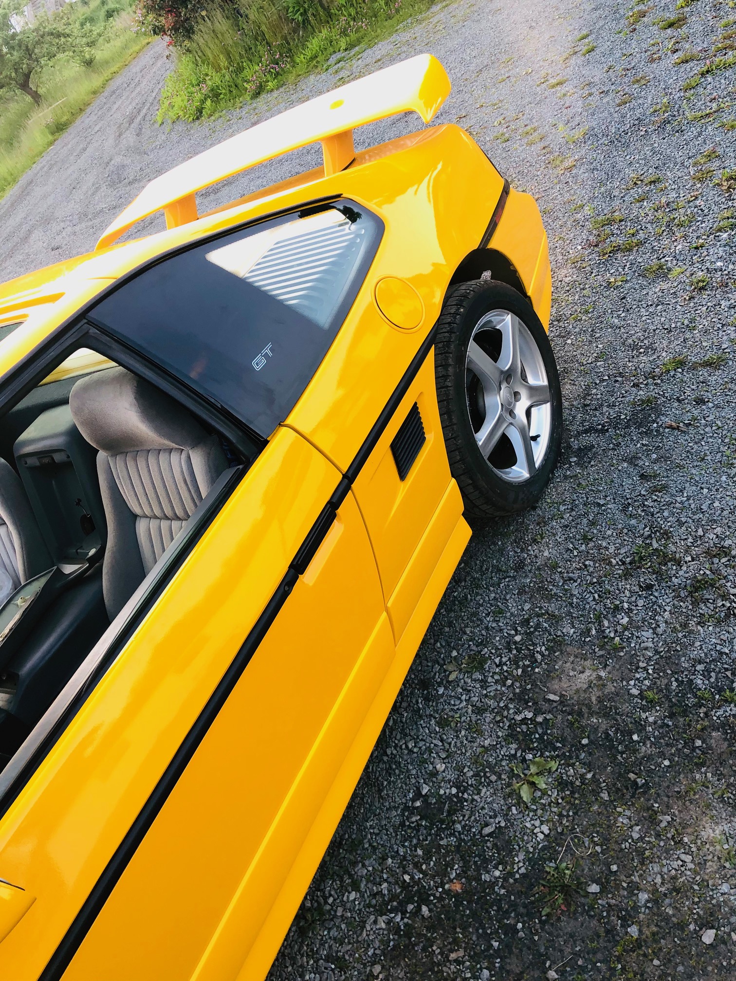

I used 1/4 windows off of Ebay which look really good, I got the clear ones, it gives the car a clean look
I bit the bullet and got Keith Goodyear Tail light lenses, No these aren't cheap but they are worth every penny, these are a extremly high quality product. Very Happy with this purchase. Also you can see in this pic I had a still arched wing squirreled away forever to use.

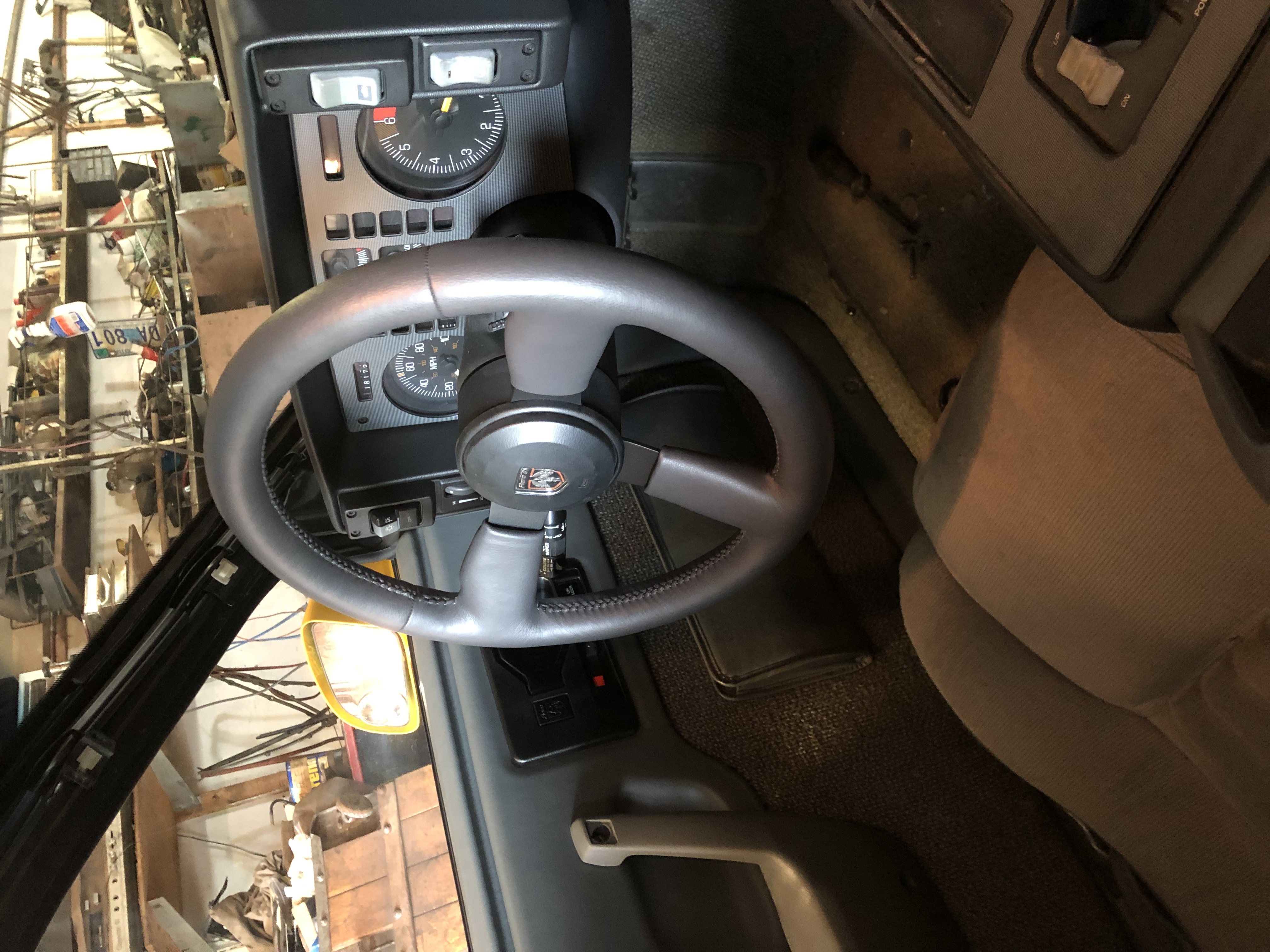

Another pricey item but again worth every penny is a Alex Babineau Recovered Steering wheel with extra padding, I opted for the 3x padding. This steering wheel alone is by far the single best upgrade to the car in my opinion, gone is that comically thin old ass steering wheel from 1970 and something that feels like what you find in a modern car.

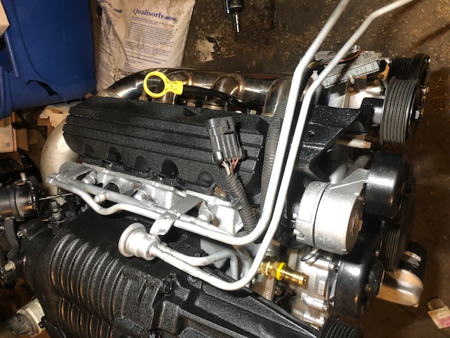

Well my swap has been slowed by a combination of lazyness and customer cars, anyway thought I'd post my home brew fuel rails.
Re: 88 L36 swap
Wrinkle finish on the blower and valve covers looks sharp... will be hell to keep clean, though.
