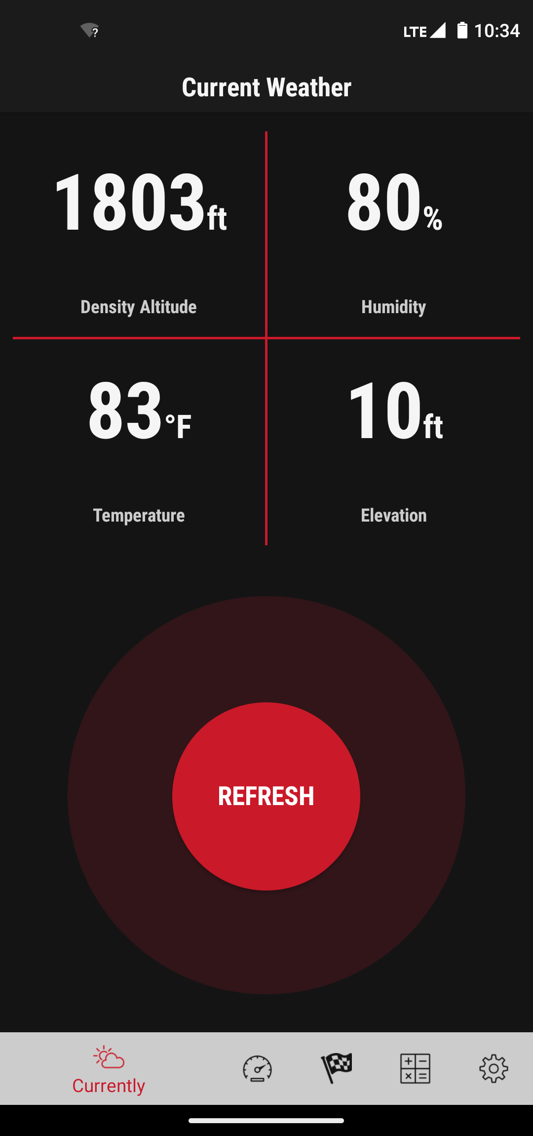

My butt Dyno was was close. Here was the D.A. Dyno room showed 88 degrees F.
