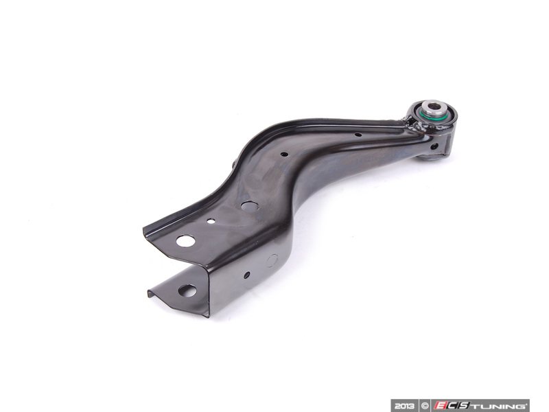

The 850CSi front control arms look like this:
Maybe ZF tech support can get me their part number for the ball joint on the right end.
This is the E31 8 series upper arm with inner ball joint installed. It takes a 12mm bolt and from the photo still looks like ~40mm OD.
So I guess I need to spend some time on the phone with NHBB on Monday about which of their sealed spherical bearings is appropriate to my application.
