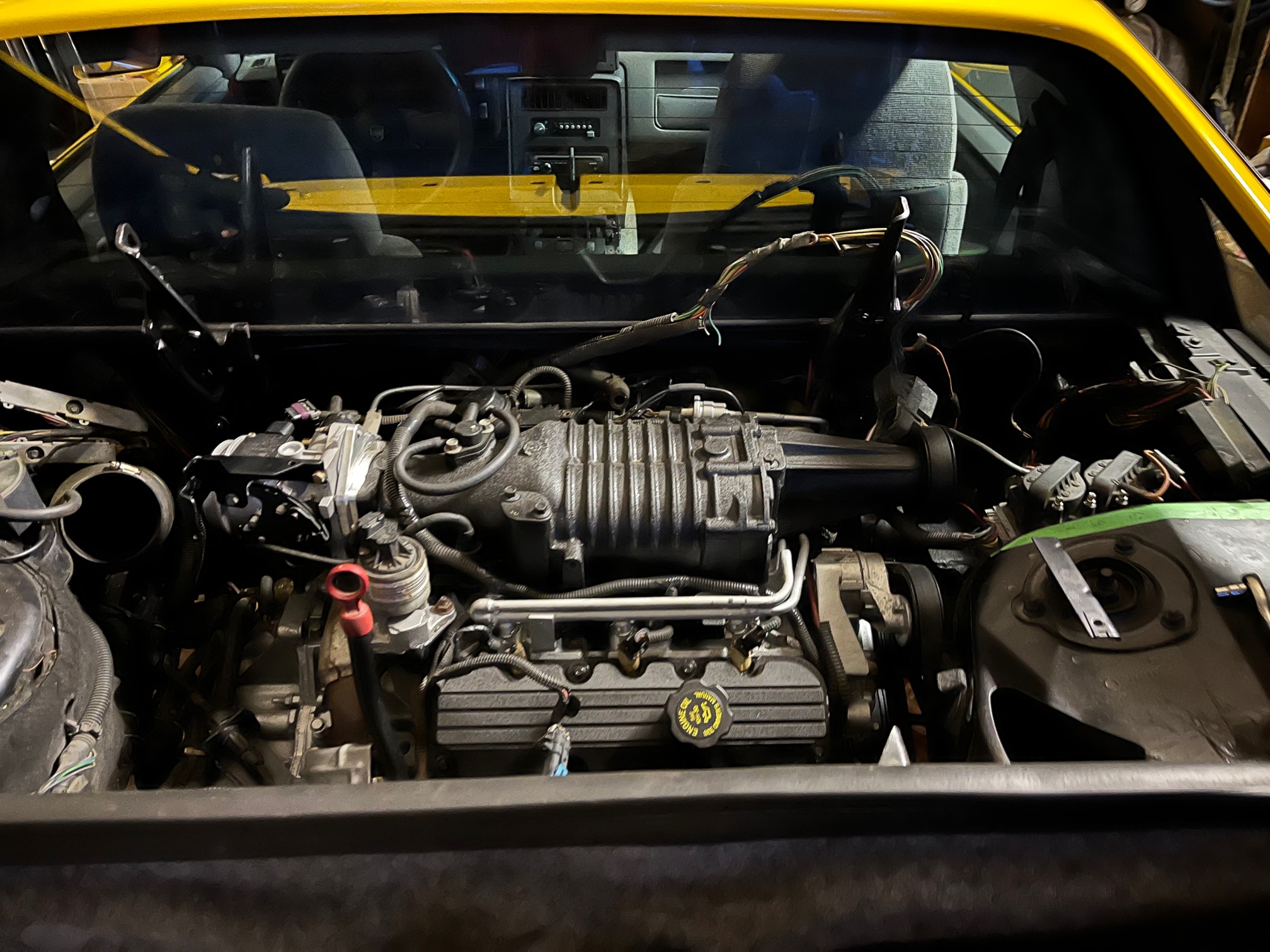

The rails normally go over the blower right? Looks like a pretty smooth execution, nice job!
Re: 88 L36 swap
Ya the do, up and over crossing several times, looks like a spiders web in stock form.ericjon262 wrote: ↑Fri Aug 05, 2022 7:45 pm The rails normally go over the blower right? Looks like a pretty smooth execution, nice job!
I can post some pics of how I make these utilizing the stock fuel rail and some 3/8 and 5/16 steel tubing. It's really not hard at all once you commit to chopping up the factory rail.

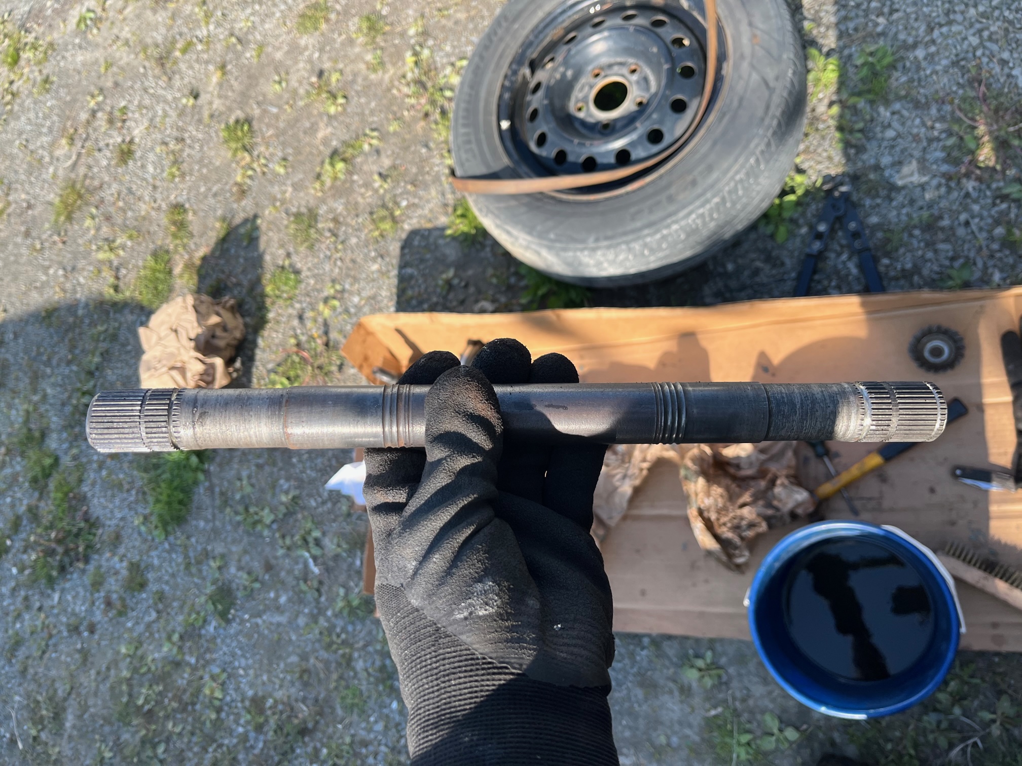

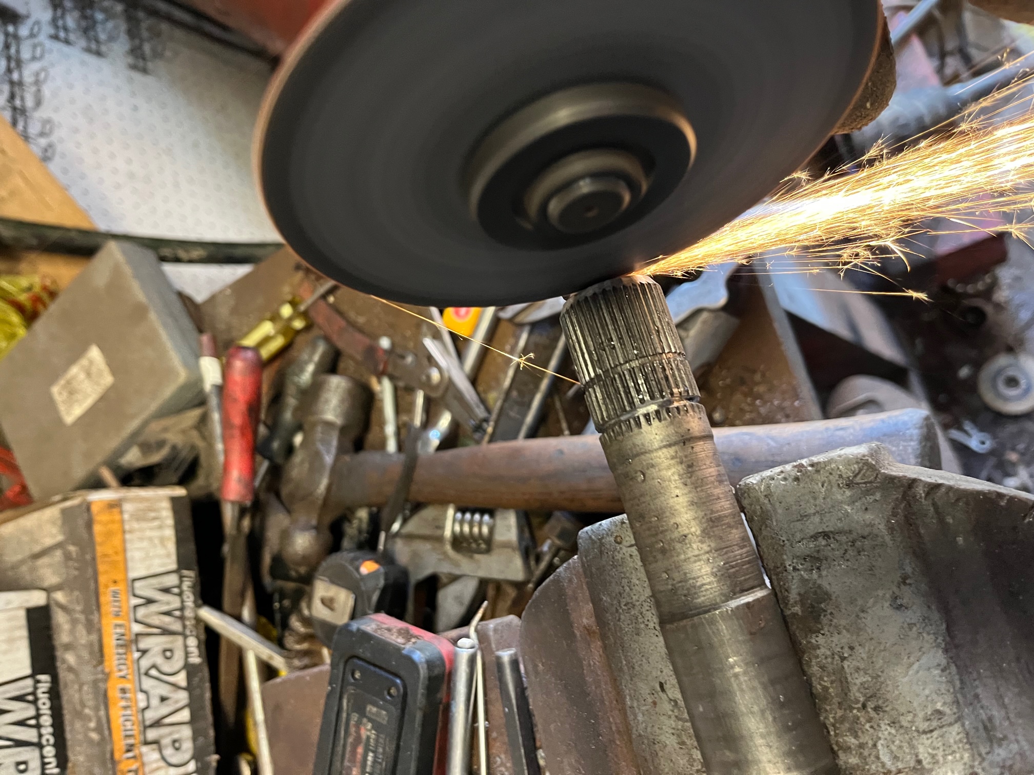

When you fucked with 6 different axles for 5 hours and yet your shortest concoction is at least an inch longer than what worked with your last swap, I don't know if it was impatience, desperation or frustration, probably a bit of all 3.
Shorting an axle 1 inch with an angle grinder
- IMG_4198.jpg (1.06 MiB) Viewed 11070 times

Re: 88 L36 to L67 swap
Does it bolt in place of the NA version?
How much rework has to be done?
The Same mounts as the NA/ Non- HD trans. Only one slight mod to the rear transaxle mount as the rear lowest left pick up hole is off set depthtwise on the Non-HD where as it flush with the rest on the HD, just knocked the spacer off the back side of my mount and it fit flush. Other than that the mounts bolted right up and it dropped right back into the cradle.
Had to do some work to the harness, not to add anything but had to lengthen a number of connectors as the Supercharger with the throttle body adapter placed things farther apart plus the area by where the battery goes got super busy with the belt drive and had to relocate all of that and change the battery cable set up.
And of course the bloody passenger side axle raised my blood pressure..... Some changes to my accessory belt drive, actually it is less complicated now all I had to do was swap the 3 inch tensioner pulley with a 4 inch one and all those problems were solved. My exhaust system didn't change, thankfully The Regal engine I originally had in there as it is the same W-body platform as what the ZZP powerlogs are made for, this created another different in the transaxle dipstick tube placement, so I robbed that out of the regal trans to sort that.
I should make note, in reality I did not have to change the harness as in add or remove anything that wasn't there nor do any re-pinning because I talked with Ryan- Sinister Fiero before hand and he was able to tune my PCM to work with my installation as is.
No major rework of the install but I changed alot of little things that I did previously and thought I could do it a little better.
