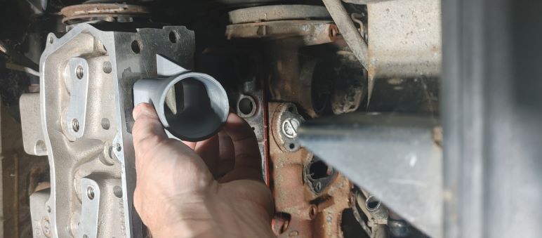

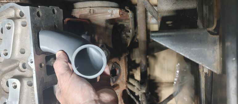

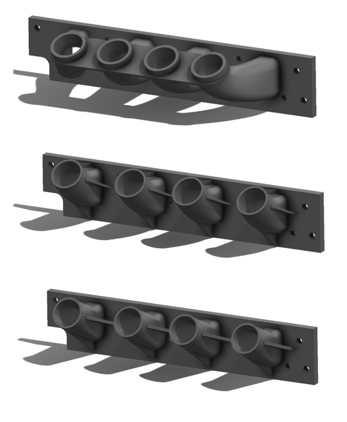

I'm printing some runner geometries to flow test after the Iron Head is tested in the coming weeks.
my older first iterations is a shorter transition from 46mm ID to rectangle, and 30 Degree incline to the port.
The 2nd option is a 45 Degree incline with a full length 46mm ID to rectangle transition
and the 3d is 60 degree incline, with a lateral 30mm bend to bring the centerlines of the 45mm ID to 80mm Center to Center for the ports, this would allow the gen-1 'busa throttles to be used without modifications, this is the worst case outside runner, inners have a 15mm bend.

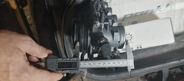

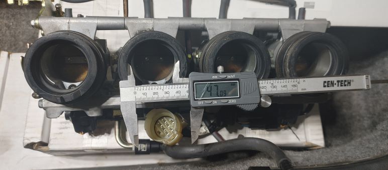

Did some test mock up with the Suzuki throttles.
These are Gen 1 GSXR1300 throttles, They may be too small for the application as is. Some Measurements:
They start at a 50mm bore, and neck down to a 42mm at the base of the manifold connection. The rubber for the manifold is sized for a 47mm connection. I should be able to bore the throttle bases open to 45mm, I'm not sure if that is still a large enough opening.
The SD4 port opening, unported, is 34mm x 54mm, that is 2.84 sq-in, and the '801 head lacks the pinch point of must 2 valve head designs, leaving the throat as the primary restriction, a theoretical 90% throat diameter at the valve, for a 2.1 valve with a 5/16 stem, is 1.89", with an area of 2.72 sq-in, I'll say this would be the maximum port area possible after porting.
A 42mm Dia bore only has an area of 2.14 sq-in
A 45mm Dia bore only has an area 2.47 sq-in
A 50mm Dia bore has an area of 3.04 sq-in
It's obvious to me suzuki tapers the throttle body for venturi effect at the point of fuel injection to increase atomization. If I bore they throttles to 45, I will reduce the effect, but most likely benefit from a restriction upstream of the port, But a full 50mm bore would require new blades, Hilborn sells throttle blades for around $30, do they fit these Kehin Throttles? Doubtfull, but maybe they could be made to work?
My alternative is some Chinesium DCOE pattern 50mm throttles from Amazon, more money and work than the Hyabusa units, but cheaper than anything else out there at $130 for a two barrel unit. I may just get one to look at up close.

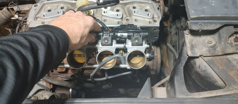

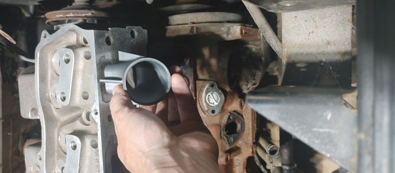

The measurements with the '801 head on stock mounts are:
11" to the firewall, and 5.5" to the base of the deck "vents" (solid units on the car currently)
I will most likely ditch the dogbone and mount, but the 'busa 80mm center to center spacing could clear it, the 60 degree up turn provides adequate clearance from the trunk wall. 45 may fit, but 30 doesn't look hopeful.
Looking at my stance as the car sits, that axles point slightly upward, I could rotate the engine a little forward on the crank center to raise the axle centerline, gain some clearance and ever so slightly shift engine weight forward.

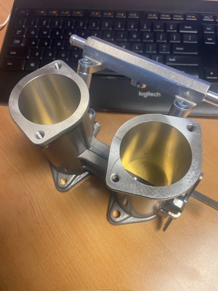

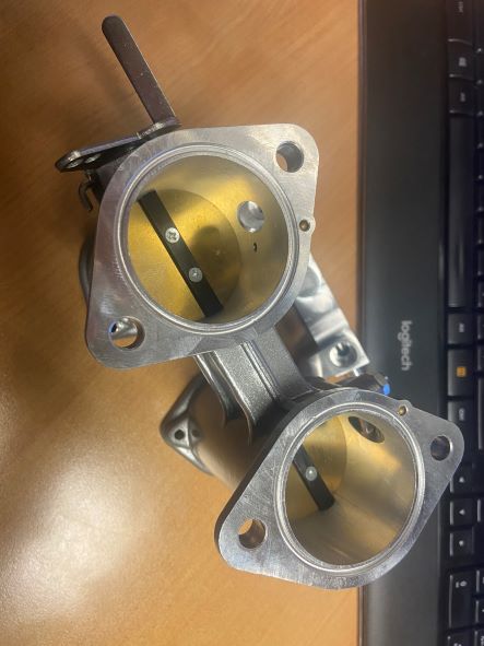

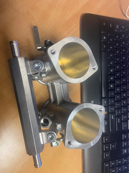

I bought 4 of the 48mm bore DCOE pattern throttle bodies.
They seem nice. Straight bore at 48mm, sealed shafts on the on the outsides, idle bleed adjustments, mounting studs, orings, and fuel rails included. All for $89. They do offer 50mm units for $135.
48DCOE bottom.JPEG (40.29 KiB) Viewed 22625 times
48 dcoe top.JPEG (41.31 KiB) Viewed 22625 times
48 dcoe bottom.JPEG (38.47 KiB) Viewed 22625 times

Not Kinsler.
Amazon, mega alibaba/wish.com vibes.
https://a.co/d/bInukYR
