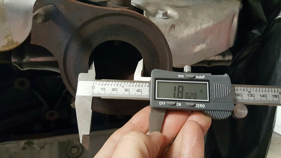

crappy exhaust manifold. For some reason, GM thought it a good idea to stuff 3.9 liters worth of exh into a 1.8 inch hole. This is the merge where all 6 cylinders come together in the trunk side manifold when mounted in a fiero. Porting can get it out to about 2 inches, but the walls are thin. There are options(not headers) but require fabrication
Re: 3900 headgasket on 3400 head and other lz9 info
wow, that is tiny... I think each manifold off of my 3500 had a bigger discharge, and that was for just 3 cylinders. why are headers a no go?
Flanges for headers used to be made but I don't think so anymore. I'm in contact with someone who has a set that is looking at having them duplicated.
The other option is to run a different trunk side manifold from a g6 and fab up a new merge collector of a larger ID for both banks still using the factory crossover
