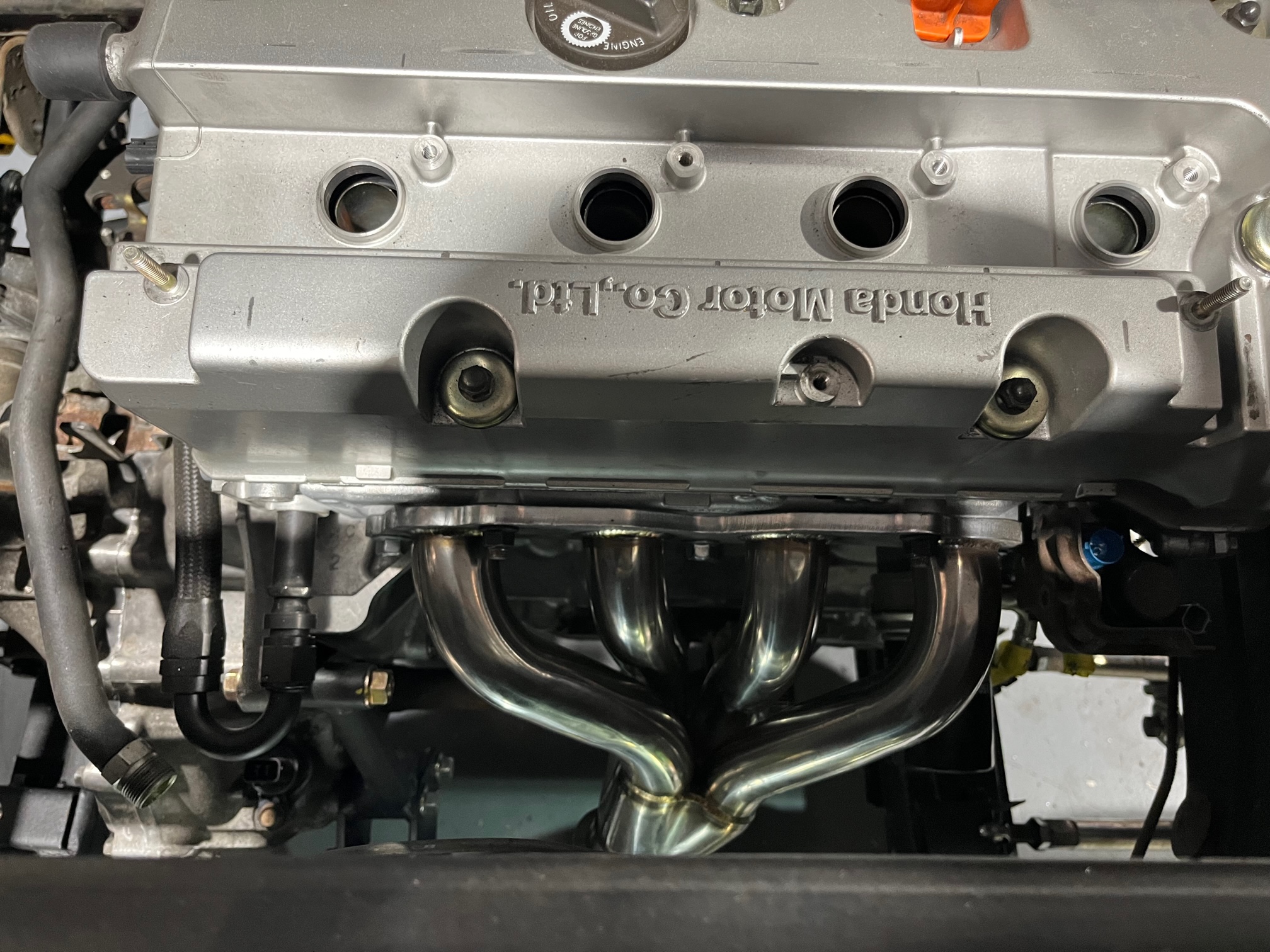

Engine in the car! Lots of room for activities in the bay with the 4 cylinder.

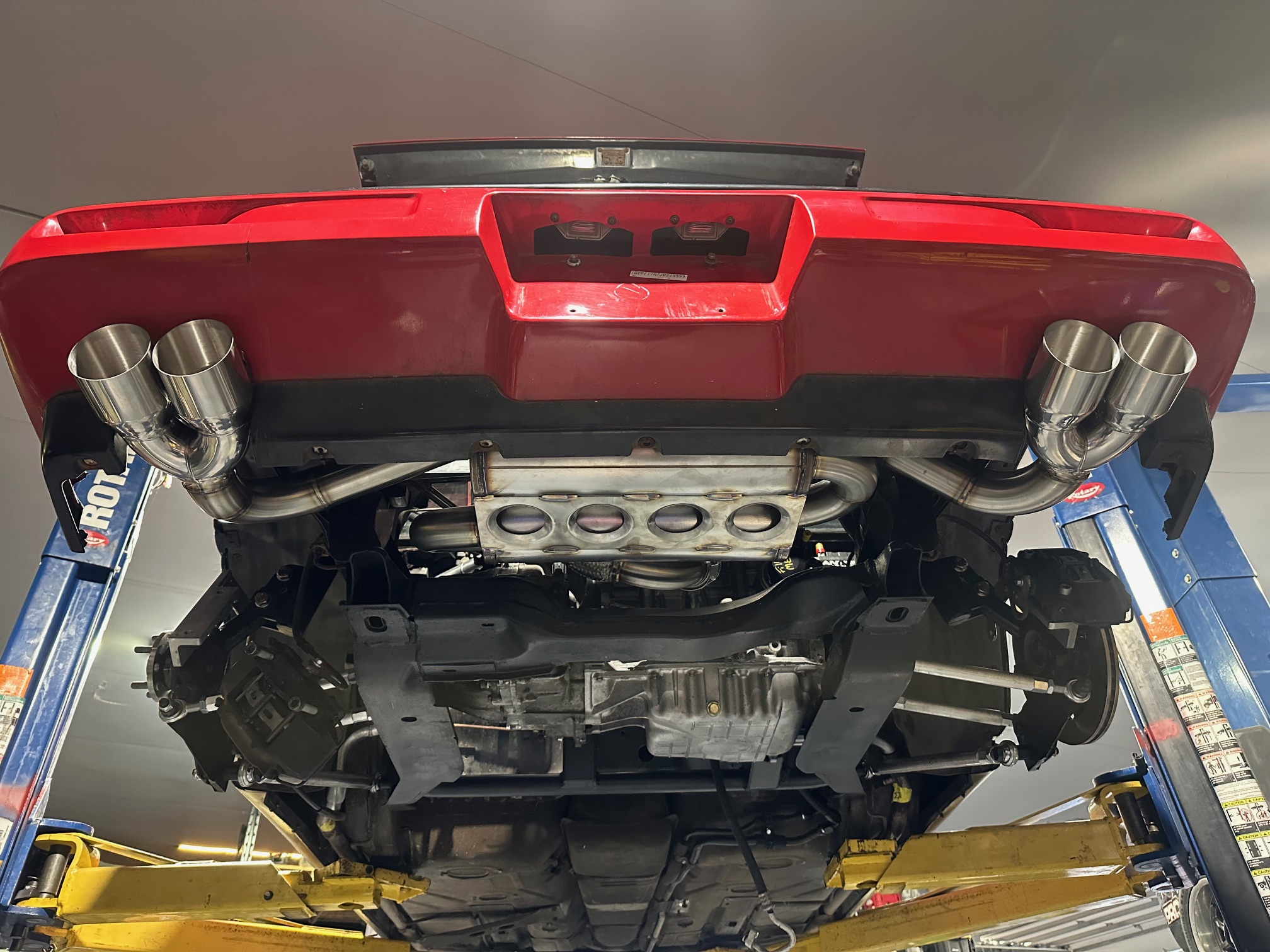

Exhaust progress. Header is on. The bottom of the trunk is cut out for room for mufflers. I'm not a fan of obnoxiously loud race cars but also want good exhaust flow so the only solution is BIG free flowing mufflers. The one towards the rear of the car has an exit on either side so I can have quad tips still.

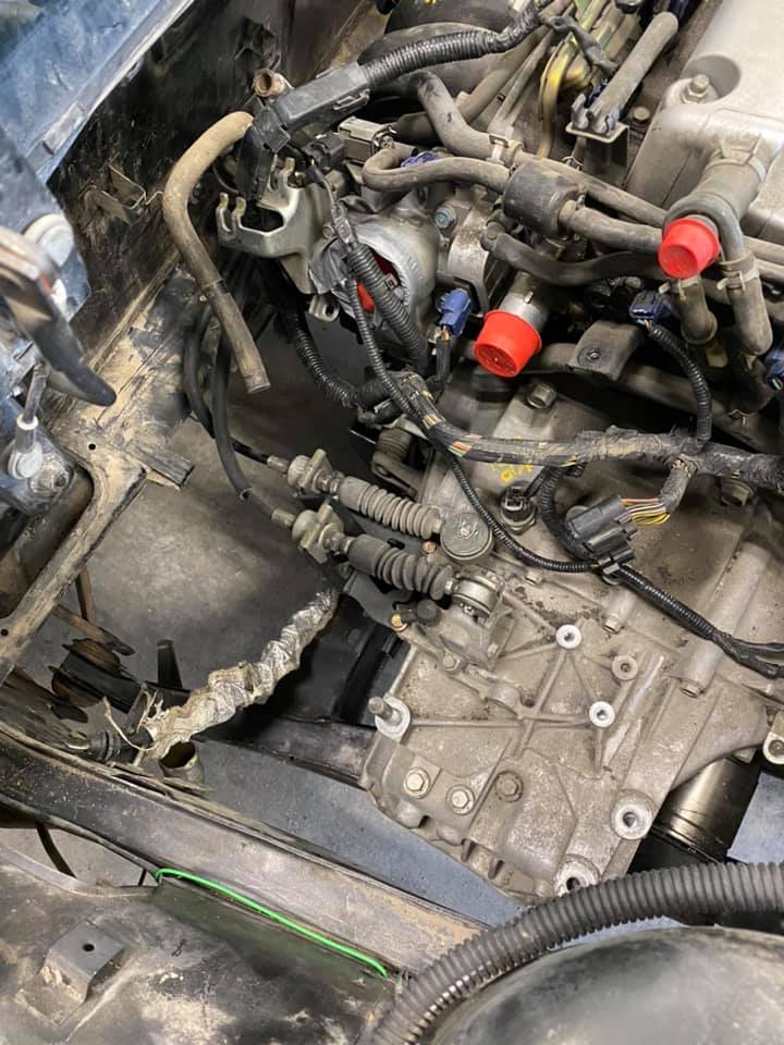

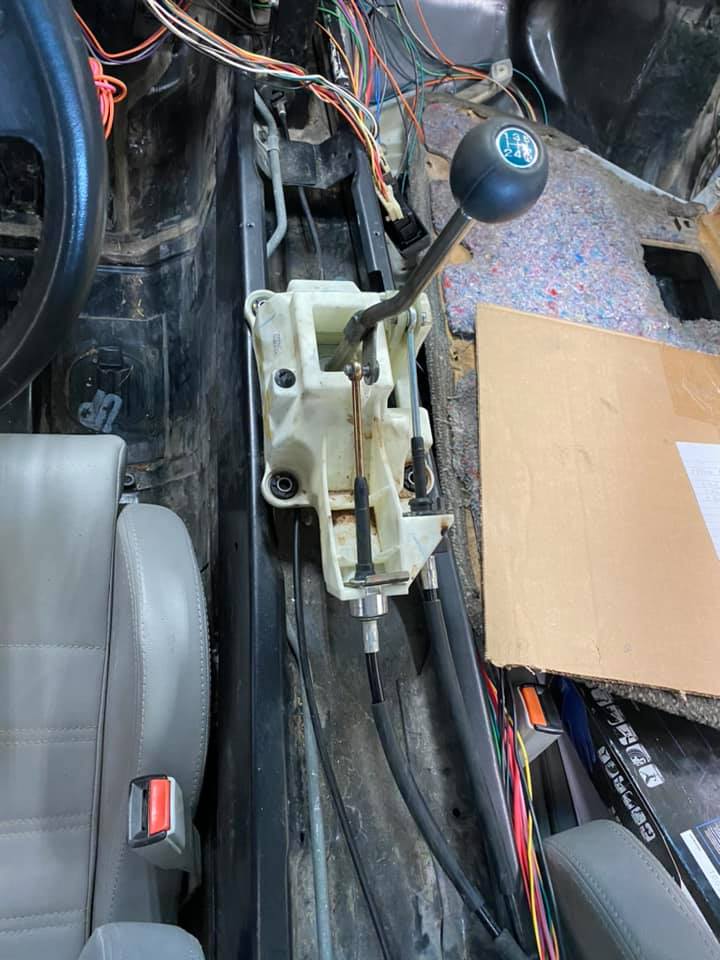

Looking more into it, it seems like what others have done successfully is flipped the stock honda shifter around so the cables come out the back - that lets the cables come at the transmission from the firewall side with the normal shift pattern
I'll test fit that up first and see what happens.
Some pics that other people have taken:

That looks like a good solution with minor fab. I have been considering using an oem shifter and cables from another car for my LZ9 F23, VW shifters are another good option as the shifter has a ball pivot, and I have been considering a Honda shifter and cables as well. I will need to modify the trans side of things obviously to make them work with the Honda or VW parts. Any chance you know what cables and shifter are being used in the pics you posted?

zok15 wrote: Tue Nov 21, 2023 1:16 pm That looks like a good solution with minor fab. I have been considering using an oem shifter and cables from another car for my LZ9 F23, VW shifters are another good option as the shifter has a ball pivot, and I have been considering a Honda shifter and cables as well. I will need to modify the trans side of things obviously to make them work with the Honda or VW parts. Any chance you know what cables and shifter are being used in the pics you posted?
The ones pictured are from a 5 speed K series car, most likely an Accord or base model RSX.
Mine is a 6 speed out of an RSX Type S, and I'll be attempting to use the stock shifter and cables from that car. Will report back!

Elected to go with a Hybrid Racing K swap shifter instead of trying to make the stock RSX box work. It was going to be too hacky to get that plastic thing to mount up (too wide for the tunnel) and the Hybrid racing one was on a black friday deal. Still using stock cables and flipping the braket on the transmission side, that looks like it'll all line up.
Exhaust is done and looks great (in my completely unbiased opinion). Only remaining thing is I'll probably need some kind of heat shield on the bumper plastic but we'll see once the car is running.

I can't take credit for the exhaust work, much as I'd love to - it looks professionally done because it was done by professionals :-D . I am a very bad welder and don't have the right equipment so any metal fab is being handled by a local shop up here in Vancouver BC

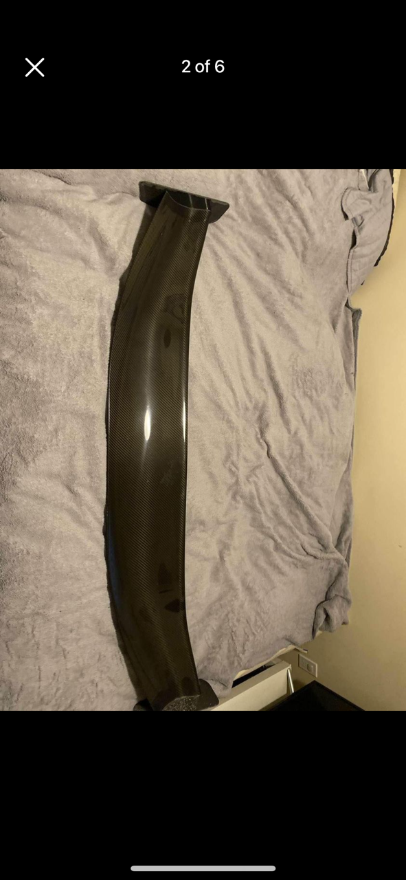

I also managed to snag this off a local for much much less than retail - an APR GTC-300 Wing. So, another thing on the to-do list.

Jalisurr wrote: Fri Dec 15, 2023 2:07 pm Exhaust is done and looks great (in my completely unbiased opinion). Only remaining thing is I'll probably need some kind of heat shield on the bumper plastic but we'll see once the car is running.
I'm melting my bumper with less exhaust heat and more clearance to the tips. Add the shields and don't melt your bumper!

Series8217 wrote: Thu Feb 22, 2024 5:39 pm I'm melting my bumper with less exhaust heat and more clearance to the tips. Add the shields and don't melt your bumper!
Good to know - heat shields are definitely on the list before the first track shakedown then. There's a track day school on April 5th that I'll be instructing at so get free track sessions during the breaks - I'm really hoping to have the Fiero running to do a first shakedown that day. I think it'll be doable so long as the dyno isn't booked solid.

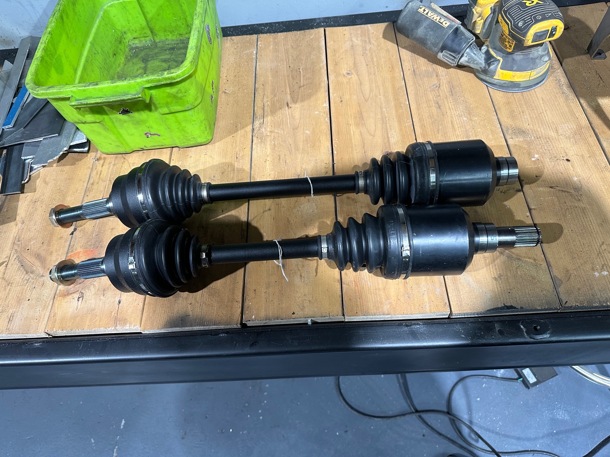

More progress - Driveshaftshop axles have arrived and fit up nicely

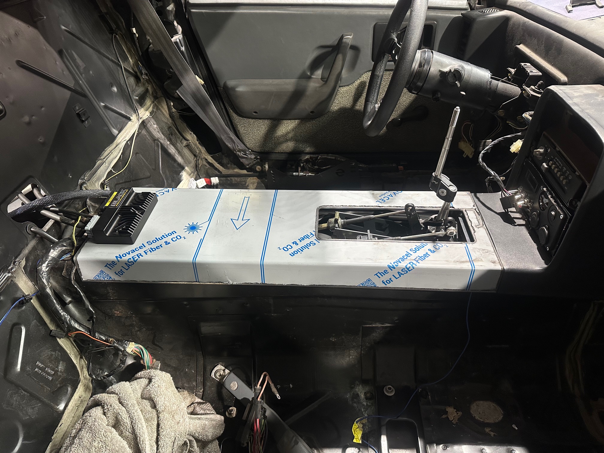

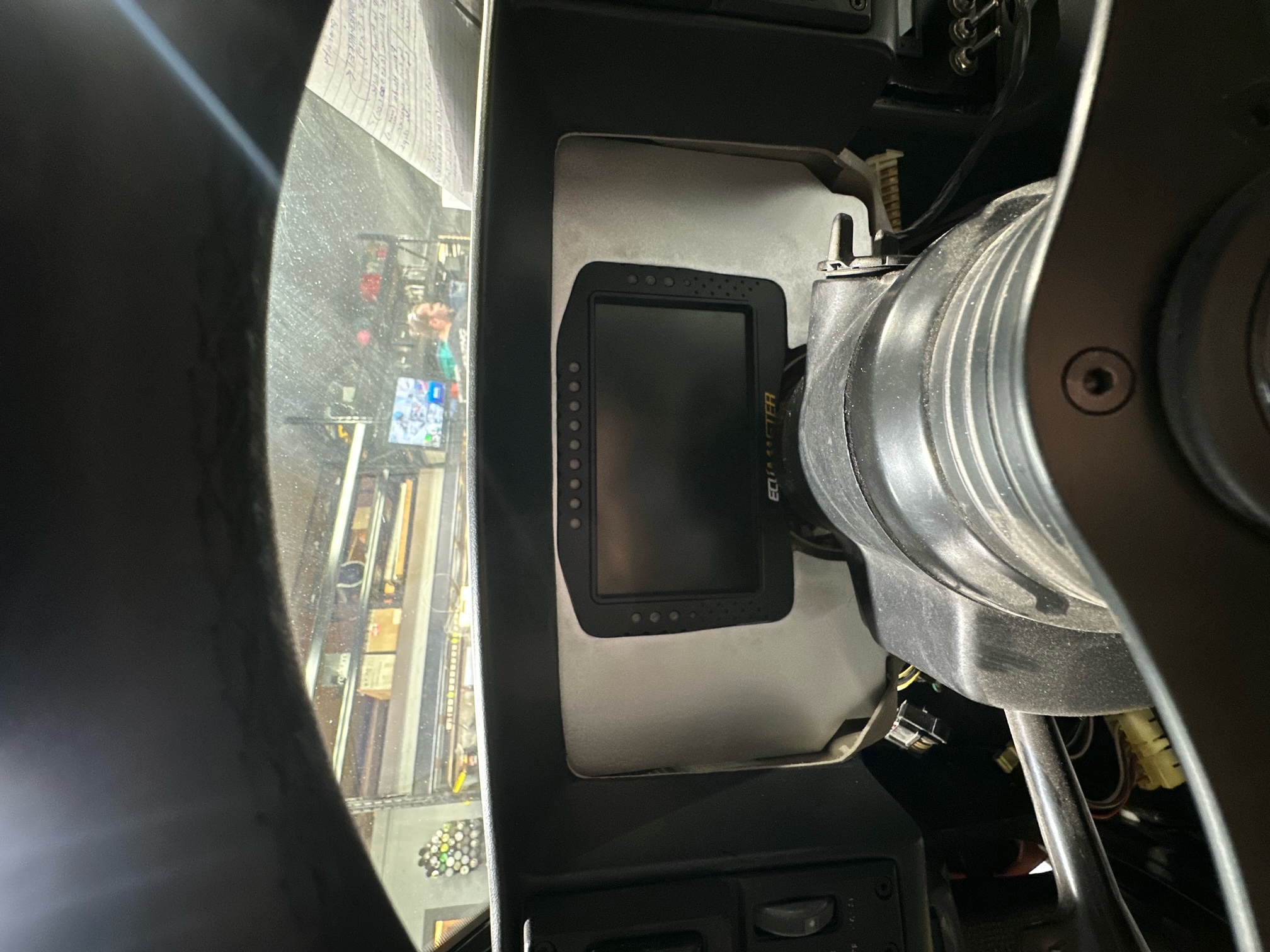

Also getting the interior sorted. Simple aluminum cover for the transmission tunnel, and a mounting bracket for the digital gauge cluster because I don't feel like making the stock gauges work.
