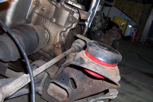

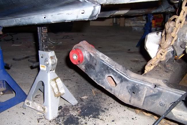

Installed the poly cradle bushings tonight and that made a huge mess burning out the old ones...
Also, I got the timing cover back on with the new water pump and a new poly-bushing reinforced steel motor mount.

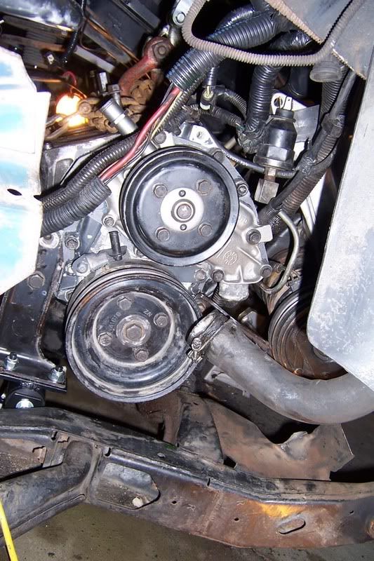

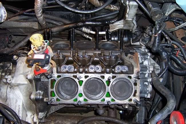

Poly Cradle bushings are in, timing cover and water pump are assembled, cradle is bolted back in to the car and the new brake calipers are installed and bled.
I got the wheels put back on tonight and put it back on the ground for the first time in a while.
I cleaned up the block to get ready for the heads. Also got the new Crane lifters lubed up and installed and the new ARP head studs. All ready for the ported Falconer Racing heads.
There is not much else that I can do to it until I get the heads finished up next week.

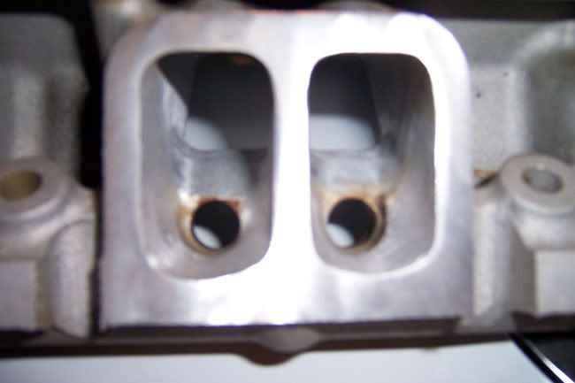

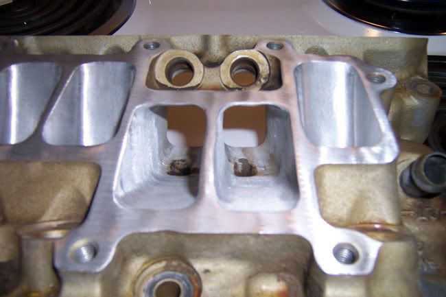

And this is what I had done to my lower intake manifold:
I had the CSI port plugged up completely and the whole thing ported.
I should get the new upper intake manifold in about a week and then it can be started.

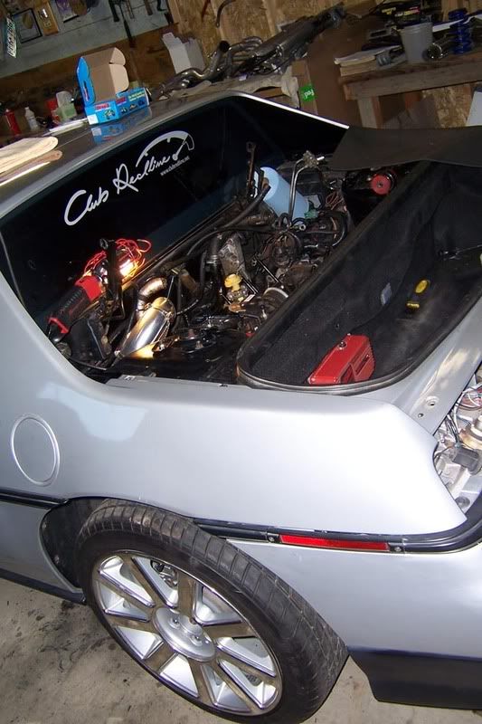

The custom ecu chip showed up today and I put it in and reassembled my Fiero. Looks nice in there. :)
Also, I got my new 24 lb/hr fuel injectors. I got a set of 8 for $180. They have been rebuilt completely, then cleaned and flow tested.
S O M E D A Y my heads will be finished and I can put the engine back together... :fart:
