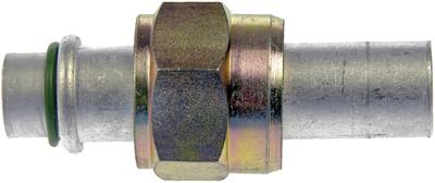

In looking at it some more, I think I have a configuration that will work.
I'll use these:
The Dark Side of Will wrote: Sun Nov 11, 2018 4:17 pm
Two of these:
http://ecatalog.smpcorp.com/fs/#/vehicl ... 600?type=s
7/8-14 thread size (steel)
Plus this:
http://ecatalog.smpcorp.com/fs/#/vehicl ... 210?type=s
7/8-14 for 1/2" hose.
and this:
http://ecatalog.smpcorp.com/fs/#/vehicl ... 612?type=s
7/8-14 for 5/8" hose
And if I need to put some extra length in, I can cut these up:
http://ecatalog.smpcorp.com/fs/#/vehicl ... 332?type=s
5/8" hose splicer elbow
OR
http://ecatalog.smpcorp.com/fs/#/vehicl ... 330?type=s
1/2" hose splicer elbow
I could even work from scratch with a Dorman 800-963:
https://www.summitracing.com/parts/rnb-800-963
