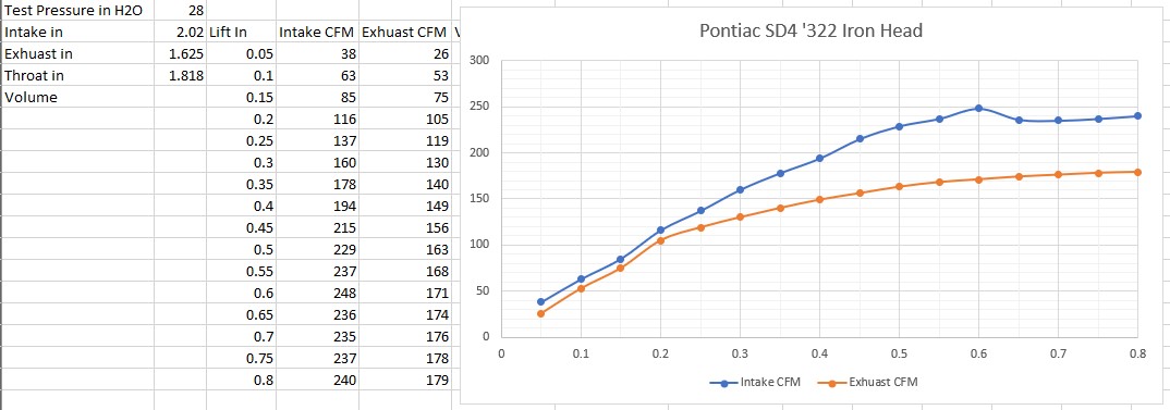

Iron Head flow numbers.
Ran on a SF-750 @ 28" H2O
New graph Below.
New graph Below.

- Posts: 8736
Re: 1984 SD4 Resurreciton
That's pretty good flow

I think the flow stalls after .500 lift because the short side radius is very abrupt. I also think some work on the valve seat may help, it has a simple 45 degree seat and valve currently.

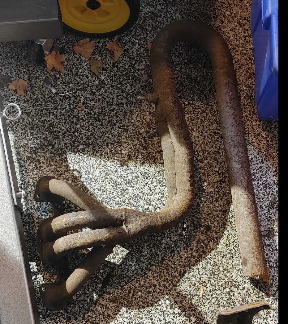

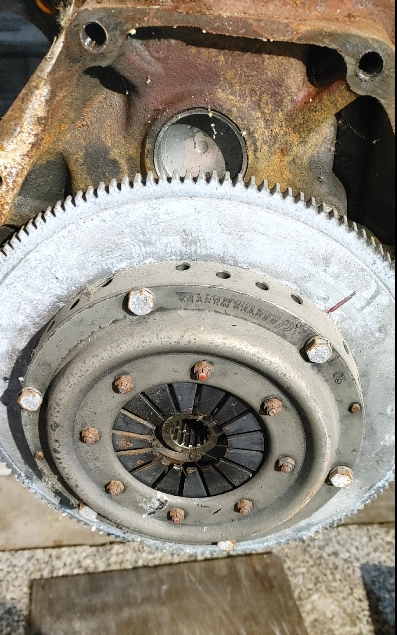

I pulled the shortblock from the car tonight.
I was always wondering what kind of clutch was used. What a nice surprise.
The 4-2-1 header looks salvageable mostly surface rust. but I think the primaries will be to small for the 801 head.
- twins.jpg (232.63 KiB) Viewed 18794 times
- Header.jpg (946.73 KiB) Viewed 18794 times

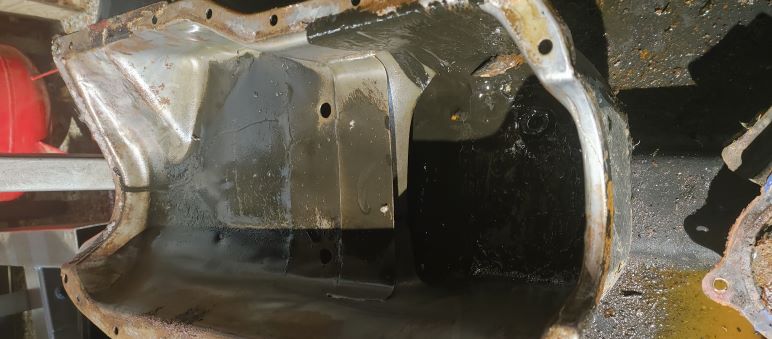

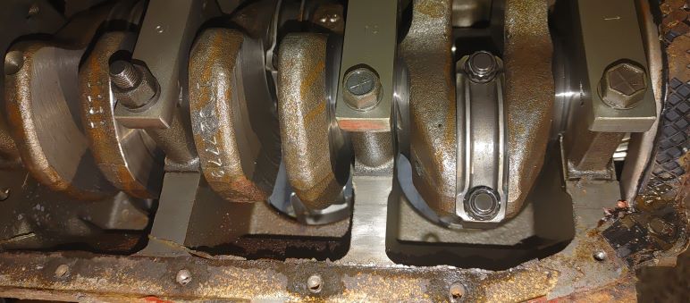

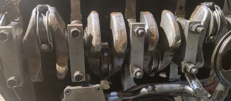

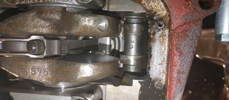

I pulled the pan off last night.
1. Lots of crud.
2. I have never seen journal braces like these
3. No obvious signs of stress, cam journals look a little rough, but not ruined.
I suspect based on the deposits in the cooling jacket, someone ran BARs leak in the coolant.
Nice rods, but the pan is on the sludgy side.
Looks like the oil pickup is welded? Was the bracket modified to make up for the extra thickness of the main cap toppers?
Going to have the block tanked?
I've read that Ross pistons tend to have stiff skirts that beat the cylinders up and oval the bottom ends of the bores in the perpendicular direction over time.

The pump pickup isnt welded, just RTV and sludge. It is bolted to the cap straps, it must have been modified when built. The engine also has the large sump Moroso drain back oil pan. Ill have to pull off the shelf and snap a photo on the Canton dry sump pan I have.The Dark Side of Will wrote: ↑Thu Oct 27, 2022 9:04 am Nice rods, but the pan is on the sludgy side.

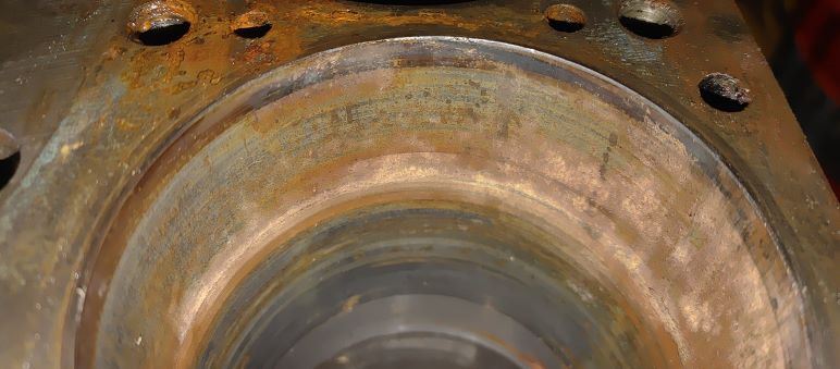

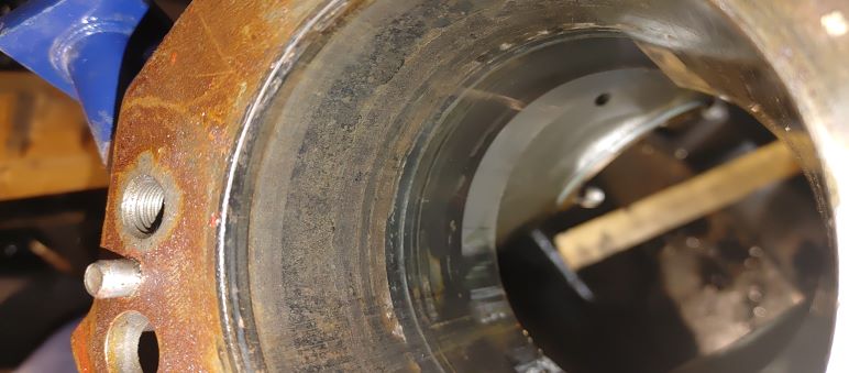

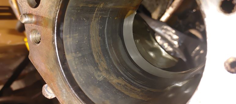

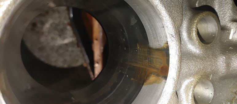

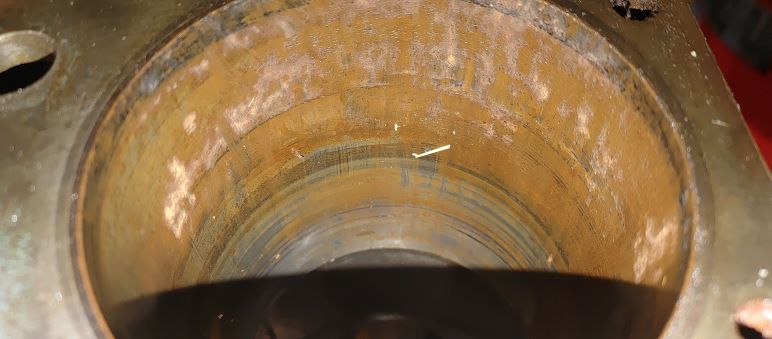

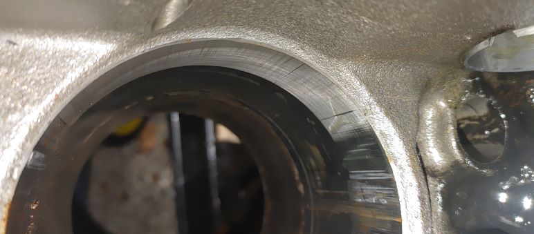

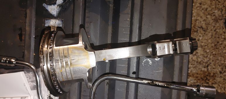

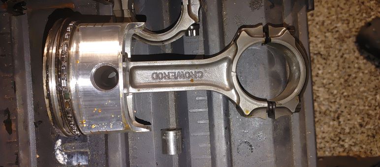

Pistons where pounded out of the block Sunday afternoon.
- piston 1a.jpg (58.68 KiB) Viewed 18714 times
- piston 1.jpg (49.91 KiB) Viewed 18714 times
- piston 2.jpg (47.7 KiB) Viewed 18714 times
- scuff 1.jpg (42.59 KiB) Viewed 18714 times
- bore 1.jpg (36.88 KiB) Viewed 18714 times
- bore 4.jpg (44.91 KiB) Viewed 18714 times
- scuff 3.jpg (42.68 KiB) Viewed 18714 times
- scuff 2.jpg (46.21 KiB) Viewed 18714 times
- bore 2.jpg (47.88 KiB) Viewed 18714 times
- bore 3.jpg (41.48 KiB) Viewed 18714 times

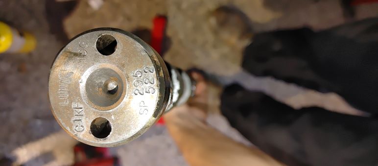

OId Camshaft, I emailed Lunati for information.
I assume the name means cam is a 295 Duration @ 522 peak lift. I would like a cam that goes to at least .600 lift, hard to find flat tappet cams that high, but Isky offers one.
Solid roller is a huge jump up in lift and duration.

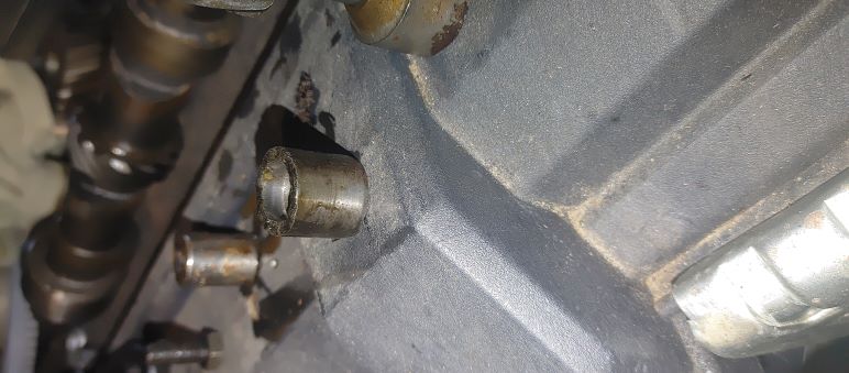

The oil pump is seized, pulled it out and part of this bushing came with, I think that may be the failure mode of the engine, that or the pistons froze in the block first: I test fitted the head with the 1.7(Im thinking they are) roller rockers. I'm not sure they will work. The pushrod cup to fulcrum distance seems to short, the exhaust pushrod wasn't happy sitting in either cup of the lifter or rocker. The studs were also too long (even shorter per the SD4 build guide) and the pushrods are too short, since the surface is supposed to be raised .3" per Pontiac.

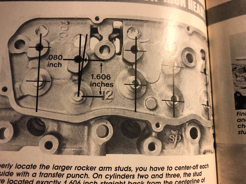

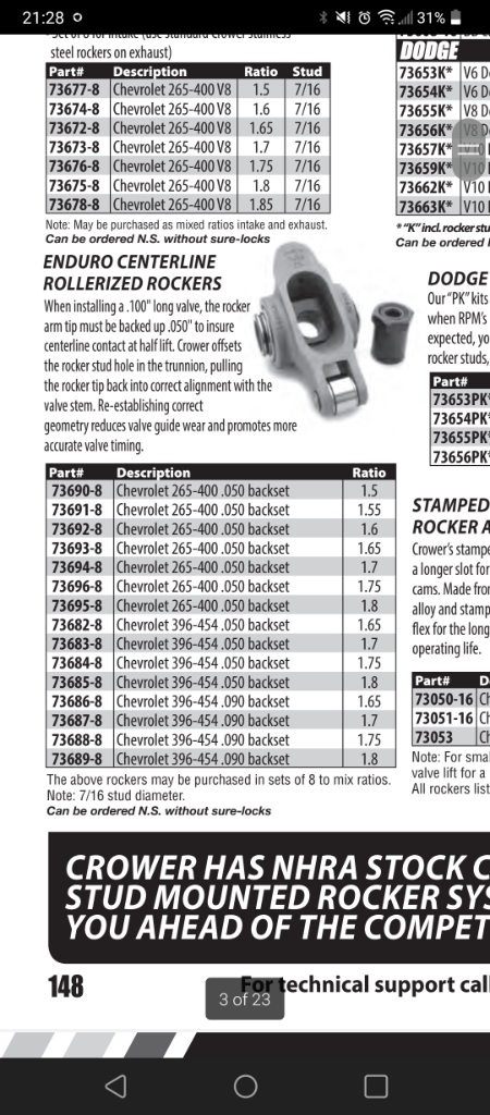

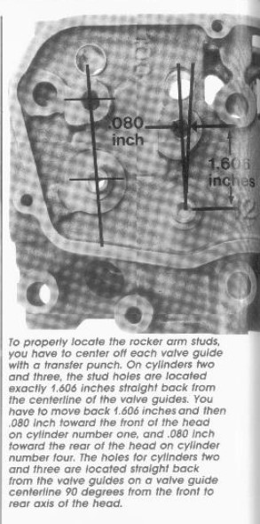

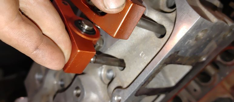

I may have found the right rockers for use on the duke heads, if the information is all true through the 801 head. It been confirmed, mostly, up to the aluminum 437 head. Most manufactures have dropped the Duke from their catalogs, but BBC roller rockers have been used on the duke heads.
1.606 is the distance from valve centerline to the rocker stud.
A BBC rocker length is 1.650, Crower sells rockers with a set back for longer valves, .050 would be the bet fit, 1.6" from valve center to stud center.
I would like to use a 1.8:1, Crower PN 73685-8. for use with an ISKY Cam PN 951292 (292 Dur, .577 Lift w/ 1.7) Netting a .611 total valve lift.
Then on to the stroker woes. Not all SD4 blocks are equal. Mine is a very early (1983-1984) block, as the GM program matured the block changed. Block cast with Super Duty, instead of SD2.5 on the side appear to have different internal stuff going on. Almost all have roller cam bearings, and 5 journals. They also have longer piston sleeves.
Not mine. It is cast SD2.5, has a factory 3 journal cam bearingss, and the sleeves measure at 5 1/8 with a tape.
Pictures from fastindyfiero's turbo build show a deeper sleeve than my block at the base inside, by at least 1/4-3/8 of an inch, this makes sense as the Fiero moved from GTU to GTP-Light, it became a 3.0L and stroke grew to 3.625"
Now the math:
Factory Duke Deck height: 9.175" w/ 3.25 Stroke on 5.7 Rods = 0 deck Compression height of: 1.850"
Ross piston build:
5.125 sleeve-3.25 stroke -1.85 CH = .025" in the hole for the pin. Why did Hot Rod recommend a 5.7 Chevy rod with this block, when factory 3.00" stroke was on a 6" rod? The piston pin is barely still in the hole, and I'm sure the piston has beat the bore up.
Stroker Maths:
Factory Duke Deck height: 9.175" w/ 3.48 Stroke on 6.2 Rods = 0 deck Compression height of: 1.235"
5.125 sleeve-3.48 stroke - 1.235 CH = .410", That is better, and maybe something a piston mfg can deal with.
