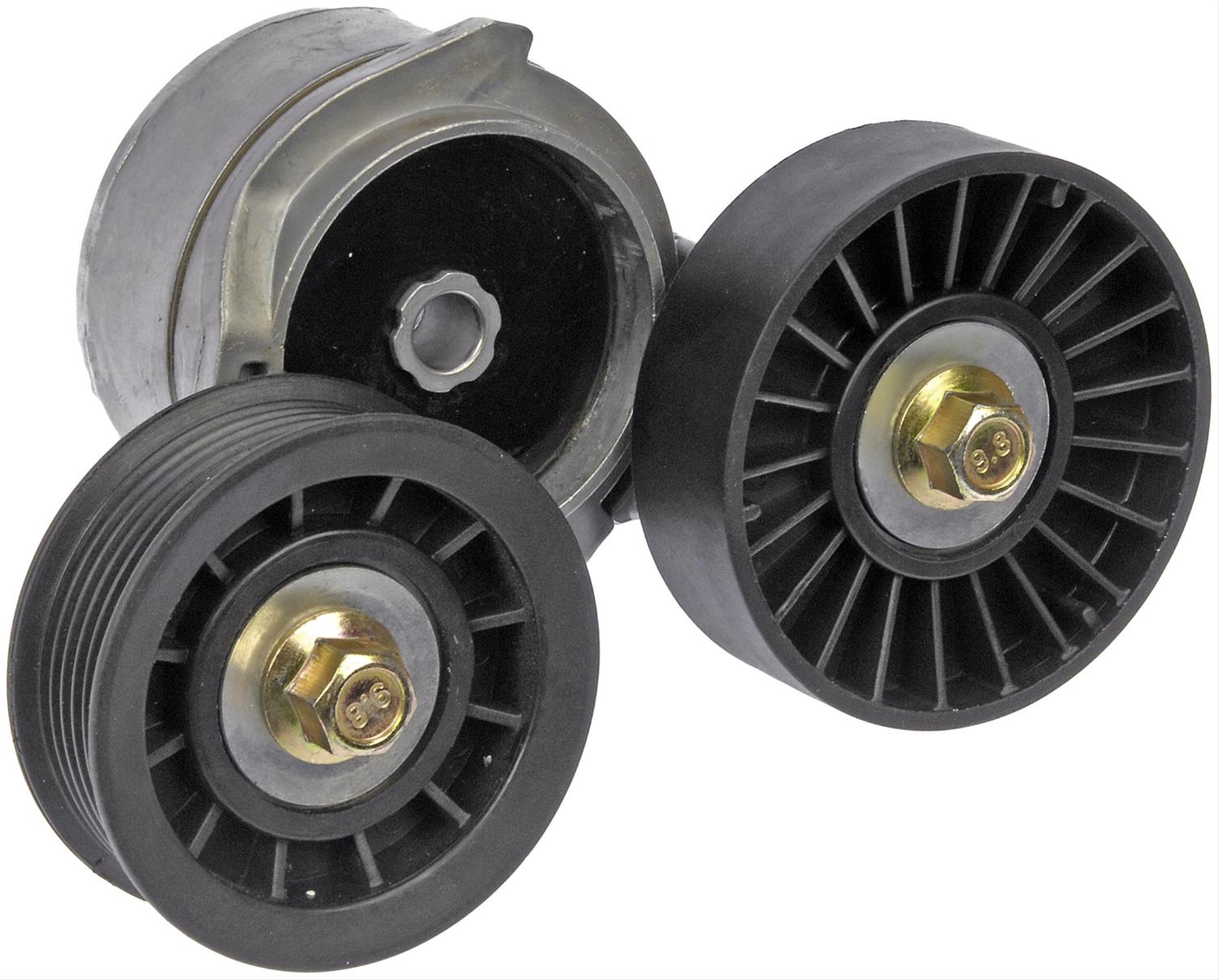

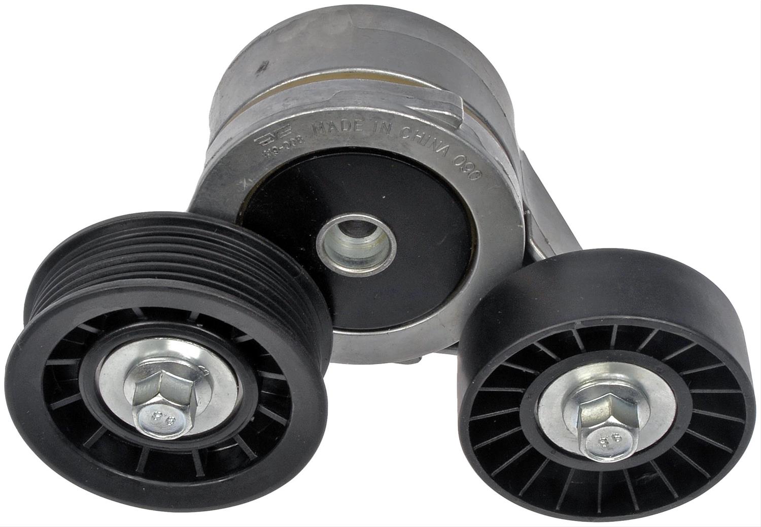

My PS delete accessory belt routing isn't the greatest. I could watch the alternator output drop due to belt slip as the engine RPM cleared 5500 or so.
I've put some thought into how to reorganize it, and I'm pretty sure I'll be able to do it with a TWO pulley spring tensioner.
With the right packaging, I may even be able to keep the belt totally below the battery so I don't have to worry about any interference between the belt or pulleys and the tray.
Here are a couple of candidates:
Dorman 419-010: https://www.summitracing.com/parts/rnb- ... /overview/
Dorman 419-214: https://www.summitracing.com/parts/rnb- ... /overview/
Those two are the front runners due to apparent packaging requirements, but here are a couple of backups:
Dorman 419-008: https://www.summitracing.com/parts/rnb- ... /overview/
Dorman 419-001: https://www.summitracing.com/parts/rnb- ... /overview/
I hate to put Made in China stuff on my red blooded American hot rod, so here's a BMW candidate too:
