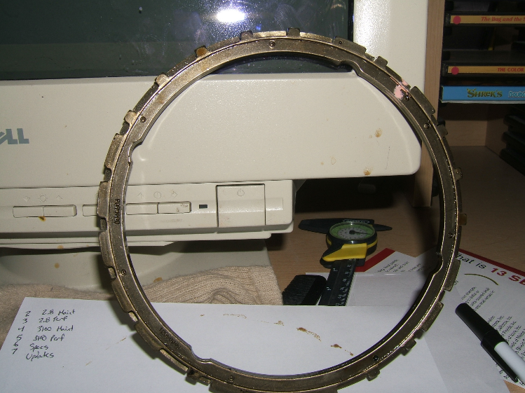

just a thought, but the LX9 uses the same 24x reluctor as an LS1, and is pressed onto the crank, you could remove an LX9 wheel and install it onto your N* crank and then you don't need the box.
Re: The Mule rides again (sort of) - pics.
Have pics, dimensions or a PN?
The forged crank from the supercharged engines is only about $400 at long-time-customer pricing from the dealership... and it's 58x.
Also, I'd have to get the indexing right.
The Dark Side of Will wrote: Fri Jan 10, 2020 9:24 pm Have pics, dimensions or a PN?
I don't have any dimensions, but here's a picture.
