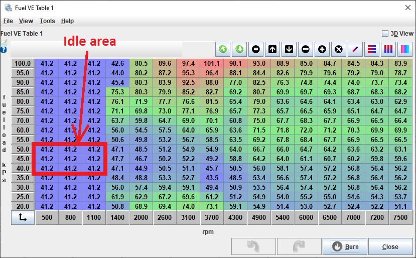

This statement struck me as bizarre, so I downloaded your *.msq tune file from the other forum to understand better.
Looks like you have exactly the same VE values in the idle area:
Eric VE 2D.jpg (215.71 KiB) Viewed 6409 times

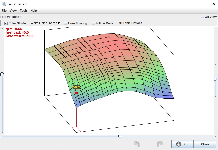

Same table viewed in 3D:
Eric 3D VE.jpg (112.46 KiB) Viewed 6409 times

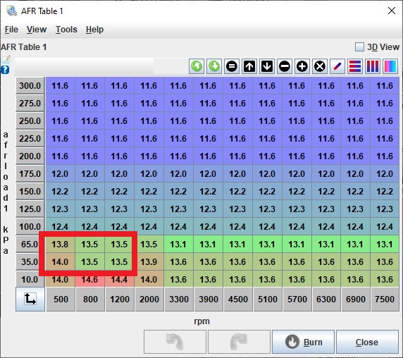

Commanded AFR, with idle area in red rectangle:
Eric 2D AFR.jpg (127.2 KiB) Viewed 6409 times
The Dark Side of Will wrote: Thu Feb 17, 2022 7:50 am AFR should be flat through the idle table.
At the moment, AFR in the idle area cannot be constant due to two reasons:
1. Engine VE varies with RPM and load, but the VE table (in the idle area) is constant. Therefore, the VE table (as it is today) cannot accurately model the actual airflow.
2. Commanded AFR is not constant in the idle area.

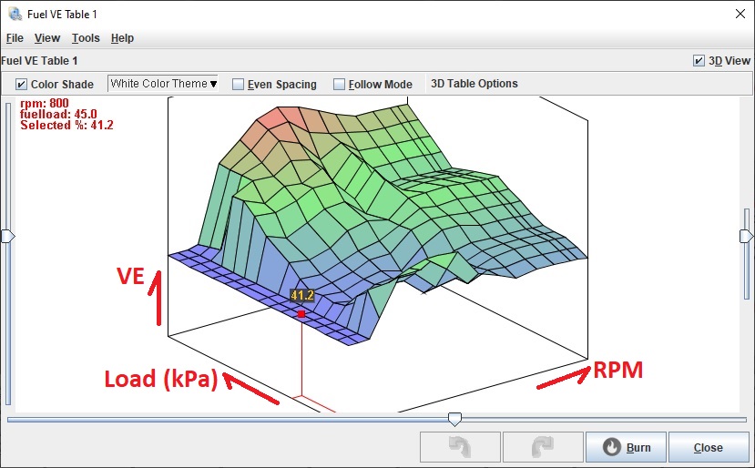

I would recommend it switching it on, so that the VE table is only modeling the volumetric efficiency, without having the target AFR baked into it. When includeAFRtarget is activated, with a properly tuned VE table, you can simply change the AFR by changing the commanded AFR, without having to revisit the VE table.
Your VE table is currently a horror show. Discussion of dead times, ignition timing retard, idle RPM, those are details that don't matter with the current state of your VE table.
VE is generally a smooth function, so the VE table should reflect that. In something such as a VTEC Honda with lobe-switching, I suppose you might find a crease in the VE table at the switchover point.
Here's my Fiero's table:
Pat 3D VE.jpg (126.72 KiB) Viewed 6409 times
The red cursor is at the idle point. There is nothing particular about the idle point. The VE table attempts to model VE accurately for all conditions of MAP/RPM.
For idle stability, it is not sufficient for the VE value at the idle point to be correct. The gradient of the VE table in the idle area must also reflect the gradient of the engine's VE.
To transform the VE table into a good representation of the engine's VE, you should use the VE Analyzer Live in TunerStudio as you drive around. Try to hit as many cells as possible in near "steady-state" conditions. I generally pick an RPM (keeping constant RPM by left-foot braking), and then slowly open the throttle with my right foot to move through the cells.
The VE table as computed by the automation won't be perfect. It will be spiky, and some unreachable areas won't be tuned (for lack of data). So, manually adjust the table so that it looks smooth, while trying to imagine what the true VE function may look like beneath the noise. Do some logical extrapolations to areas of the table you weren't able to reach.
It's an iterative process; you won't get the table like mine on the first go. With each iteration, increase the "difficulty" from Easy, to Normal, then to Hard in VE Analyzer.
In the final iterations of VE table refinement, you should datalog (always trying to hit each cell in near-steady-state) over a bunch of different conditions. Hot/cold, humid, dry. The final VE table correction should be based on this average data over different conditions. MegaLogViewer can compute a corrected VE table based on multiple datalog files. Manually review and smooth if necessary.
Generic values of injector dead time will be OK for your initial roughing-in of the VE table, but before getting to the final stages of VE table refinement, you should characterize the dead time for your specific car.

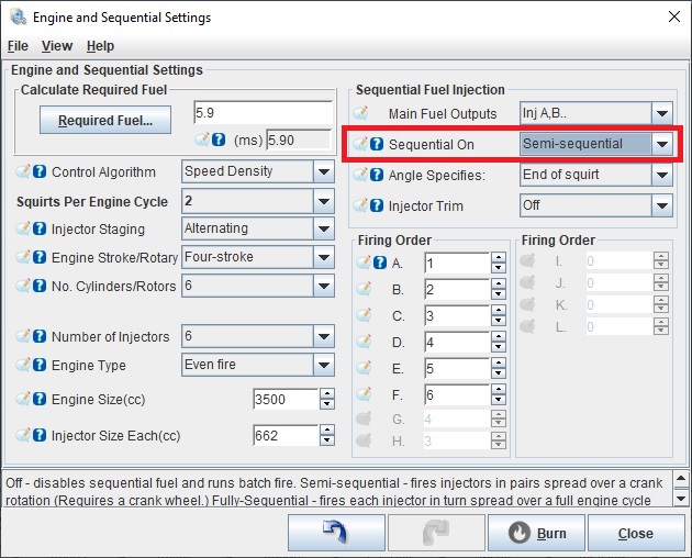

I thought you had a MAF sensor? Why aren't you using it? It saves the fuss of getting the VE table to model the engine accurately.
Eric Settings.jpg (118.71 KiB) Viewed 6409 times
What is Semi-sequential?
How many times does each injector fire per 4-stroke cycle?
The VE table is flat in the idle region, and above/below, with closed loop fuel correction turned off, the AFR table shouldn't be making changes to fueling. I did that so I would have one less variable changing things while I tried to get the car to idle consistently.
pmbrunelle wrote: Thu Feb 17, 2022 8:45 pm
1. Engine VE varies with RPM and load, but the VE table (in the idle area) VE is constant. Therefore, the VE table (as it is today) cannot accurately model the actual airflow.
Speaking of AFR, you're not running includeAFRtarget?
most EFI applications I have used in the past (granted, use was limited) performed calculations similar to what was described by not including target AFR, having the VE table control fuel, so I stuck with that, or at least I think that was my mindset at the time. include target AFR sounds simpler by the way you describe it.

pmbrunelle wrote: Thu Feb 17, 2022 8:45 pm Eric Settings.jpg
That's the way I interpreted it, currently MS3 doesn't support my crank and cam position sensor arrangement for actual sequential injection.
