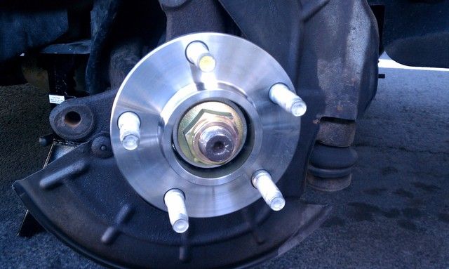

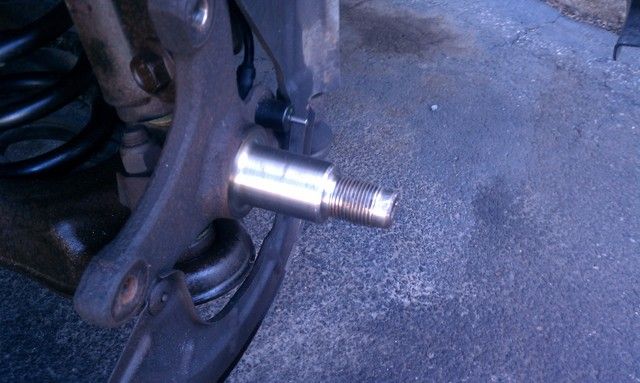

The '88 Fiero front knuckle has an extremely limited hub bore size (~70mm) -- the '88 Fiero bearing is really the only one that fits in it. However, it's a generous amount of space for a bolt-on spindle.
Consider a straight spindle shaft like on the 1994-2004 Ford Mustang front knuckle:
These hub shafts accept a bearing/flange assembly with a 5x114.3 bolt pattern.
The hubs are relatively inexpensive ($50 to $90 including bearings) and are extremely durable. Wheels with the 5x114.3 pattern are common and available in a variety of offsets from ~30 up to 63mm.
A spindle could be fabricated which bolts into the '88 front knuckle and accepts the Mustang hub, or something similar. The only custom parts required would the bolt-on spindle itself and possibly a new brake caliper adapter. Obviously the rotors would have to be drilled for 5x114.3 as well, but that isn't a new operation since larger-than-stock rotors are probably already being used from another vehicle.

I acquired an SN95 (1994 to 2004 Mustang) knuckle and hub. I don't have a big enough axle nut socket and the auto parts store is closed now, so I'll have to take it apart tomorrow. However, I was able to make some preliminary measurements, and it looks like the best offset I could hope to achieve with a fabricated spindle is +12 to +15mm over the '88 Fiero knuckle. That's really going to be too much to fit the wheel package I want, and it's also too much to get any other Fiero people interested in buying them (so I can have more made and recoup some of the costs).
The C6 hub offset is only about 7mm longer than the '88 Fiero hub, so I think making a new knuckle to accommodate this hub is feasible. Unfortunately, wheel fitment is a big problem with this pattern. I can't find a 17x8 fitment with high enough offset in this bolt pattern. 17x9 and 18x9 are available with 50mm offset (TSW Interlagos). 5x114.3 is the better pattern for the front, since S2000 fitment has an extremely high offset (63mm). Many wheels have both the 5x100 and 5x114.3 patterns, which makes it likely that proper fitments can be achieved without mixing and matching wheels for a Fiero with 5x114.3 up front and 5x100 in the rear. That said, it does look like 5x114.3 will fit on the C6 hub.. I'm just not sure if there's enough room to get the studs in from the backside.

on the mustang spindle, the hub itself isn't that complicated of a part, could you just have a new one made (or redrill and existing one) for 5x100 or whatever bolt pattern you want? the hub isn't a wear surface so you don't have to worry about sourcing a replacement, just new races and bearings.

Mill the inside of the knuckle flat and bolt the spindle on from the inside... drop the inner bearing on the hub inside the original bore in the knuckle.

The Mustang has the right bolt pattern. The problem is the flange offset is way too high. It pushes the wheel out too far.

I thought about it, but I don't like the idea of supporting the spindle on the three bolts alone. I'd rather have a light interference fit in the bore. to help distribute the load.
