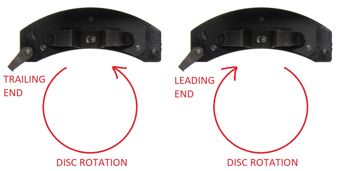

Is there a "best practice" regarding the position of the wear indicators?
Should they be on the trailing or leading end of a brake pad? Does it make any difference?
Brake Pads.jpg (94.98 KiB) Viewed 9506 times

IIRC, they go on the leading edge, in this position they tend to be more "nails on chalkboard" but I don't remember for sure. I usually just put them back the way the old ones came out, which is hardly scientific, but I've never noticed a problem either.

ericjon262 wrote: Sat Apr 11, 2020 2:51 am IIRC, they go on the leading edge, in this position they tend to be more "nails on chalkboard" but I don't remember for sure.
I took a pad in my hand, and I pushed/pulled the indicator on the disc (with the pad at an angle). I think the sound was a bit louder in the leading direction, but that was a really non-representative low (zero) budget test.

My question about the wear indicators is not so much a practical one, but it's more about knowing why I'm doing something, rather than choosing at random.

pmbrunelle wrote: Sat Apr 11, 2020 8:48 pm My question about the wear indicators is not so much a practical one, but it's more about knowing why I'm doing something, rather than choosing at random.
Sooo.... With the indicator on the trailing edge, the moment from friction with the rotor will tend to pull the indicator away from the rotor surface. With the indicator on the leading edge, the moment from friction with the rotor will tend to push the edge of the indicator into the brake rotor. Maybe the leading edge would result in louder sound because of the greater force applied?

From the weak group consensus, I put the indicators on the leading side.
