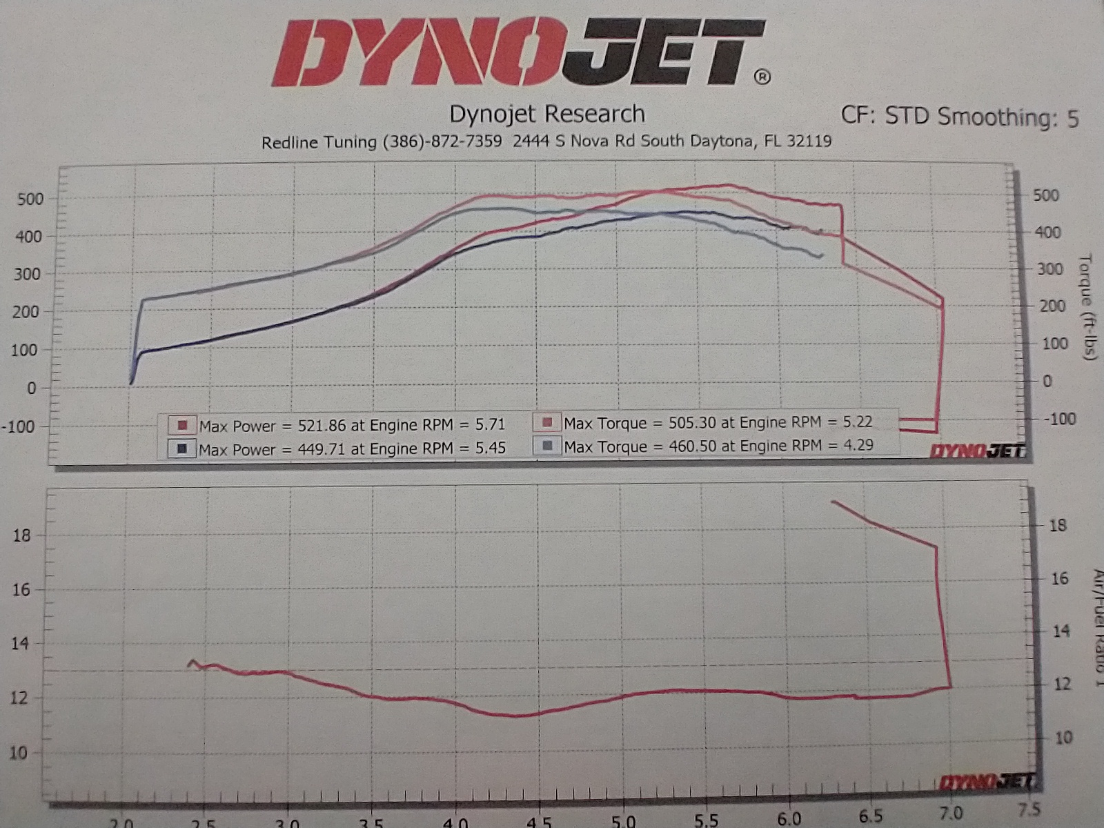

Dyno'd the 3.9 turbo on e85. Results
Posts: 8738
15.2 lbs of boost.
Peak HP at 5600.
Injector duty cycle near 95% at 6200 rpm running 830ccs at about a 56 psi base pressure
Timing above 5600 was increased from 15 degrees on 93 to 17 degrees on e85. 18 degrees netted less than 10 HP so dialed it back to 17.
Dyno on 93 was 13 lbs and 15 degrees timing.
E85 was a smidge over 15 as stated before and 17 degrees.
88 degrees and 80% humidity in Dyno cell.
Comparo between 93 and alcohol.

I don’t know much about e85 but pretty interesting how similar the curves are up to 4k or so and how the gas drops off in torque in comparison after there.

I didn't get a printout of it nor a picture but on the first run where I hit 492 HP, I pulled up my 450 HP 93 run to compare and the e85 Dyno on spool up was significant.
If I remember correctly the first pull e85 was around 30lb ft more tq at like 3500 rpm over the 93. I didn't get a pic of it but maybe someone else did. But I looked at it and it was significant increase even down low. I think as the car got hotter the gains weren't there as much.

Shaun41178(2) wrote: Sat Jun 18, 2022 10:33 pm I am hoping e85 adds 20 hp by itself. Cooler, denser charge as well as being oxygenated usually gives a decent bump with boost by itself without timing being added.
eHoward wrote: Fri Jul 01, 2022 8:39 am I don’t know much about e85 but pretty interesting how similar the curves are up to 4k or so and how the gas drops off in torque in comparison after there.
So below 4k, the turbo is spooling up (not at maximum RPM yet), and therefore the compressor discharge temperature is not at its hottest.
If oxygenation of the fuel was a factor, I think it would apply throughout the RPM range.
However, there is only a difference above 4k, when the air temperature is at maximum. The cooling effect (and hence denser charge) of E85 could be the most important when the intake air is hot, and not so important for lower intake temperatures.
So, from what I see here, it looks like the cooling effect has a bigger role than the oxygenation effect.

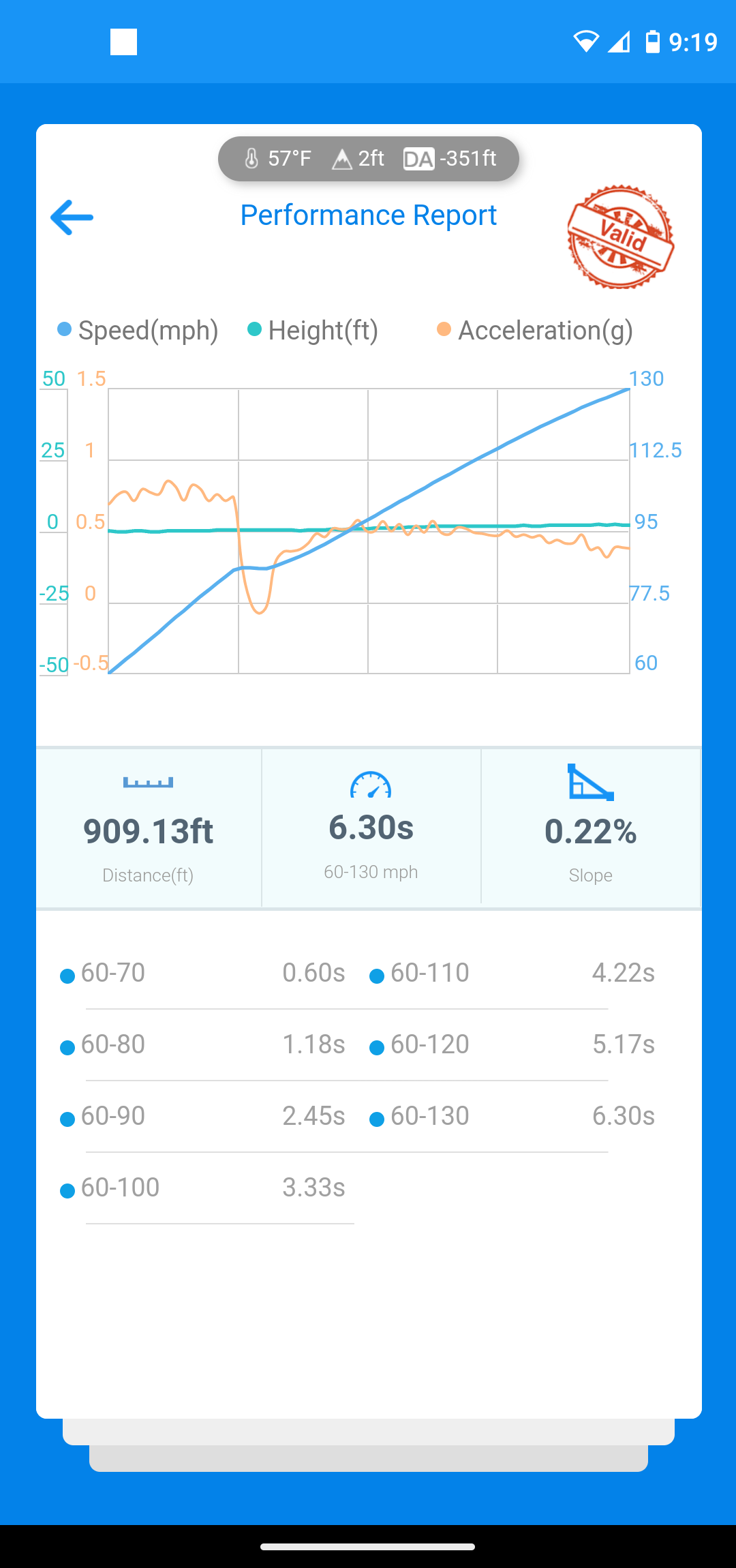

I figured I would add this new dragy 60-130 in this thread since I already posted one beforem. I might have posted this already here but I don't know where if I did.

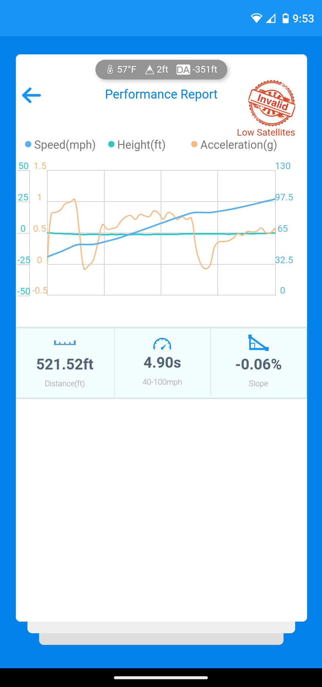

And a 40-100 which some people also do.
