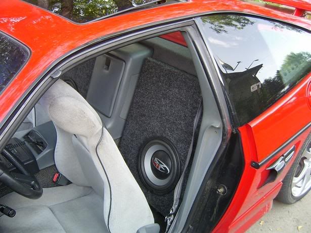

hey crzyone , got any plans as to how you did that precisley? ... i've got 2 10"s sitting here with an amp i bought off a dude at work for $120... the two JL audio 10"s will be more than enough for me bass wise. i just need plans for how to mount into the firewall...
crzyone
JDM Power FTW
Posts: 4654
Joined: Wed Nov 17, 2004 12:40 am
Location: Whitecourt, Alberta, Canada
Post by crzyone »
Yup, did a build thread on Old Europe
http://www.fiero.com/forum/Forum1/HTML/041889.html
