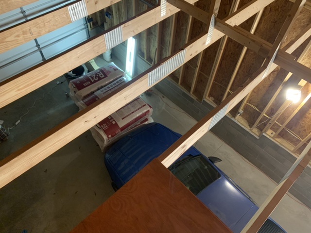

Looks like 2x6 wall studs?
You can alternate 2x4 studs on a 2x6 plate to result in better wall insulation. Too late now, though.
https://basc.pnnl.gov/images/2x4-wall-s ... ion-around
Re: The others
Interesting concept, but yeah, my walls are 2x6. The 12' ceiling and 2nd floor required it.

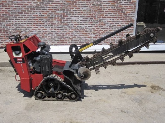

Paint!
They’ll rent one of these to just any random asshole! It goes fast. I should have only done a 2hr rental instead of the whole day.

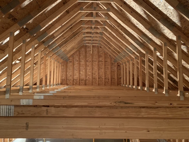

“Upstairs.” The ceiling is about 8’ in the middle.
The stapler hasn’t been the same since the fall…

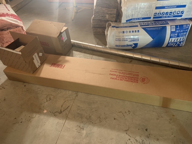

The heater showed up this week. Too cold to really do anything with it just yet.
Looks sort of like this when installed. A number of shops I go into have this style and they’re happy with the performance and economy.

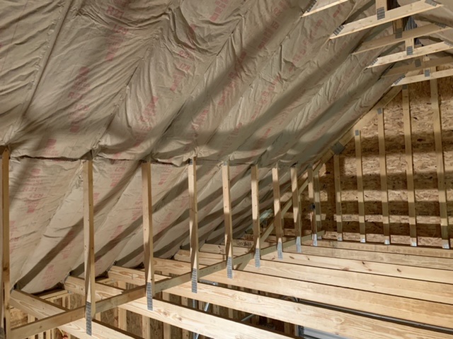

Looks like you don't have plumbing in the garage, so you won't have to keep the heat on 24/7 to keep things from freezing.
I know that attics are often left open with air circulating and the roof deck assuming ambient temperature.
How does it work with insulation covering the underside of the roof?
Re: The others
pmbrunelle wrote: Sat Jan 08, 2022 12:18 am Looks like you don't have plumbing in the garage, so you won't have to keep the heat on 24/7 to keep things from freezing.
No plumbing, but I'll keep it at a "sweater weather" minimum once done.
There are baffles sandwiched between the roof and the insulation to keep the underside vented.
https://youtu.be/KGLOsL_GuNo
