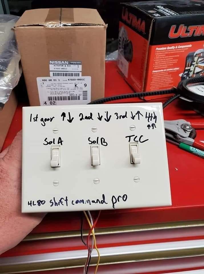

Maybe a feature request for Dynamic EFI?
Not being able to control a 4L80E seems pretty limiting for a system designed to install into hot rods.
That being said, if you invert one shift solenoid signal, then the solenoid tables are the same. The 4L80E has a PWM converter clutch solenoid, or something like that, but it'll run at 100% DC just fine.

The Dark Side of Will wrote: Sun Dec 05, 2021 9:05 pm Maybe a feature request for Dynamic EFI?
