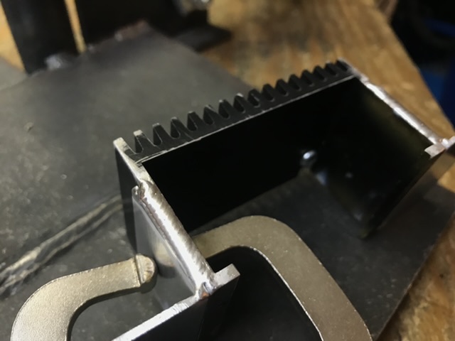

Lap joints are likely the best and easiest he can start with.
I’ve never used a variable-frequency TIG, but I hear they’re nice. 60Hz gets the job done though. I don’t really have any lap examples on my phone, but here’s a little variety that I’ve done with my Eastwood:

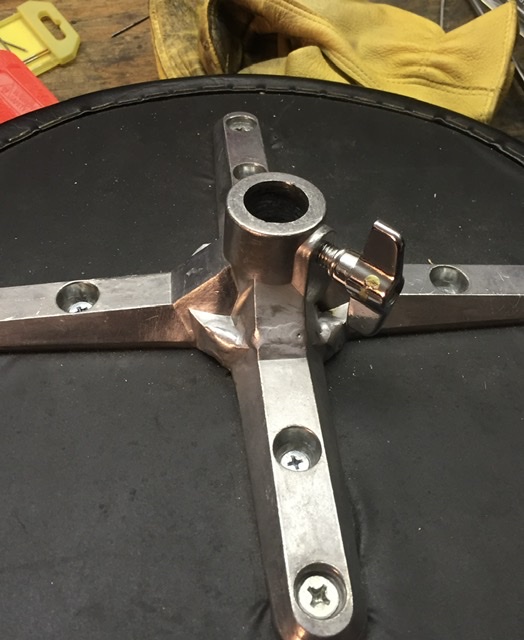

Unknown extruded
Diecast repair
Tube to cast
Apologies if I’m taking the thread too far astray.
