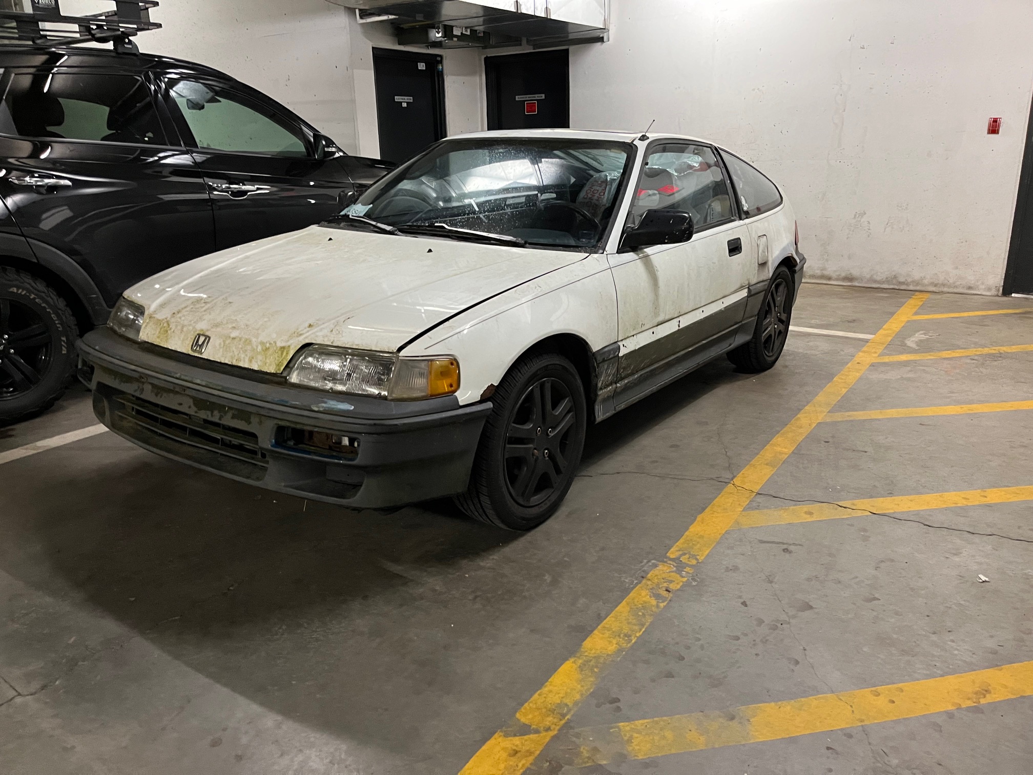

The candidate:
I picked up this 1989 CRX Si with just a hair over 400,000km on it which I was tipped off to by another member of the local racing scene. It had been sitting in a friend of his' gravel lot for several years and he was willing to let it go for a good deal. I checked it out and it was pretty much perfect for my needs. The interior was old but not trashed, the body was rough but only cosmetically, and most importantly the chassis itself was as rust free as I could hope for (plenty of rust on the fenders and rockers though). It needed a quick brake bleed, a fresh set of tires swapped on, a battery, new gas, and some coaxing on the first start, but I was able to drive it the ~40 minutes home. Then the fun begins!

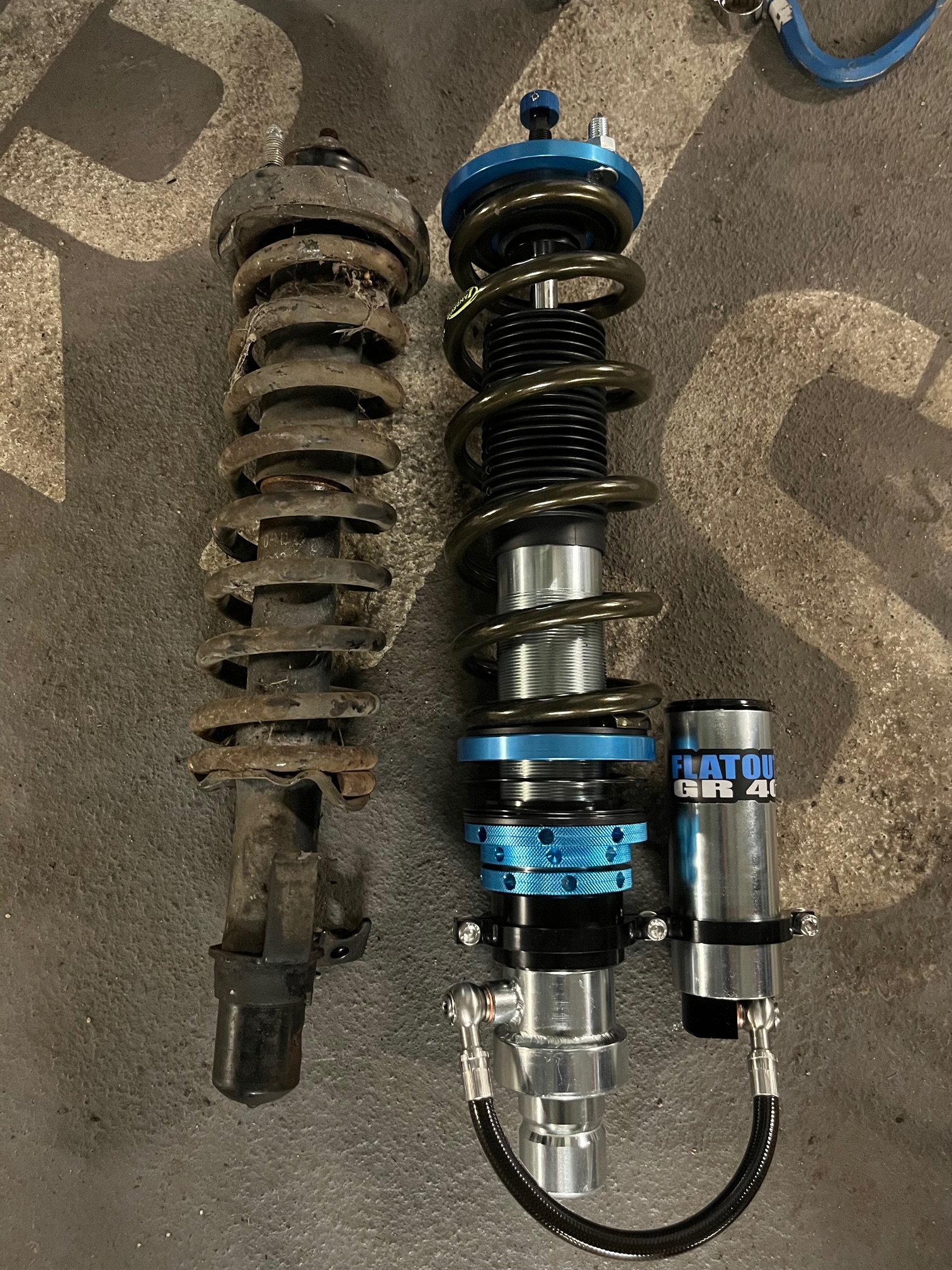

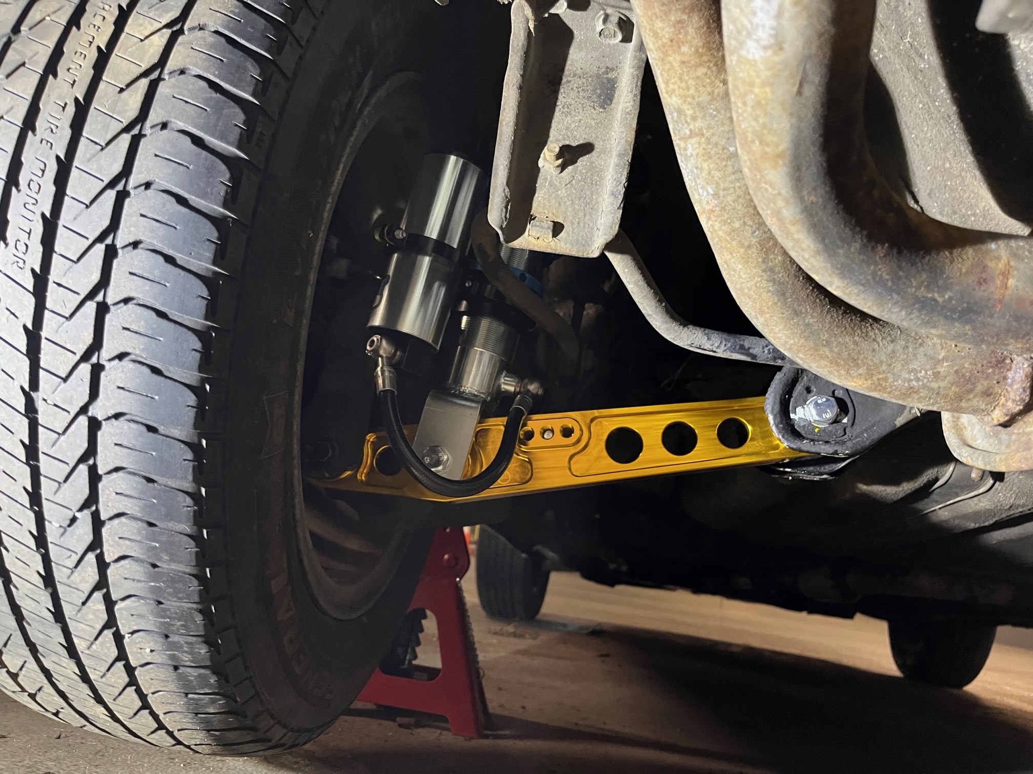

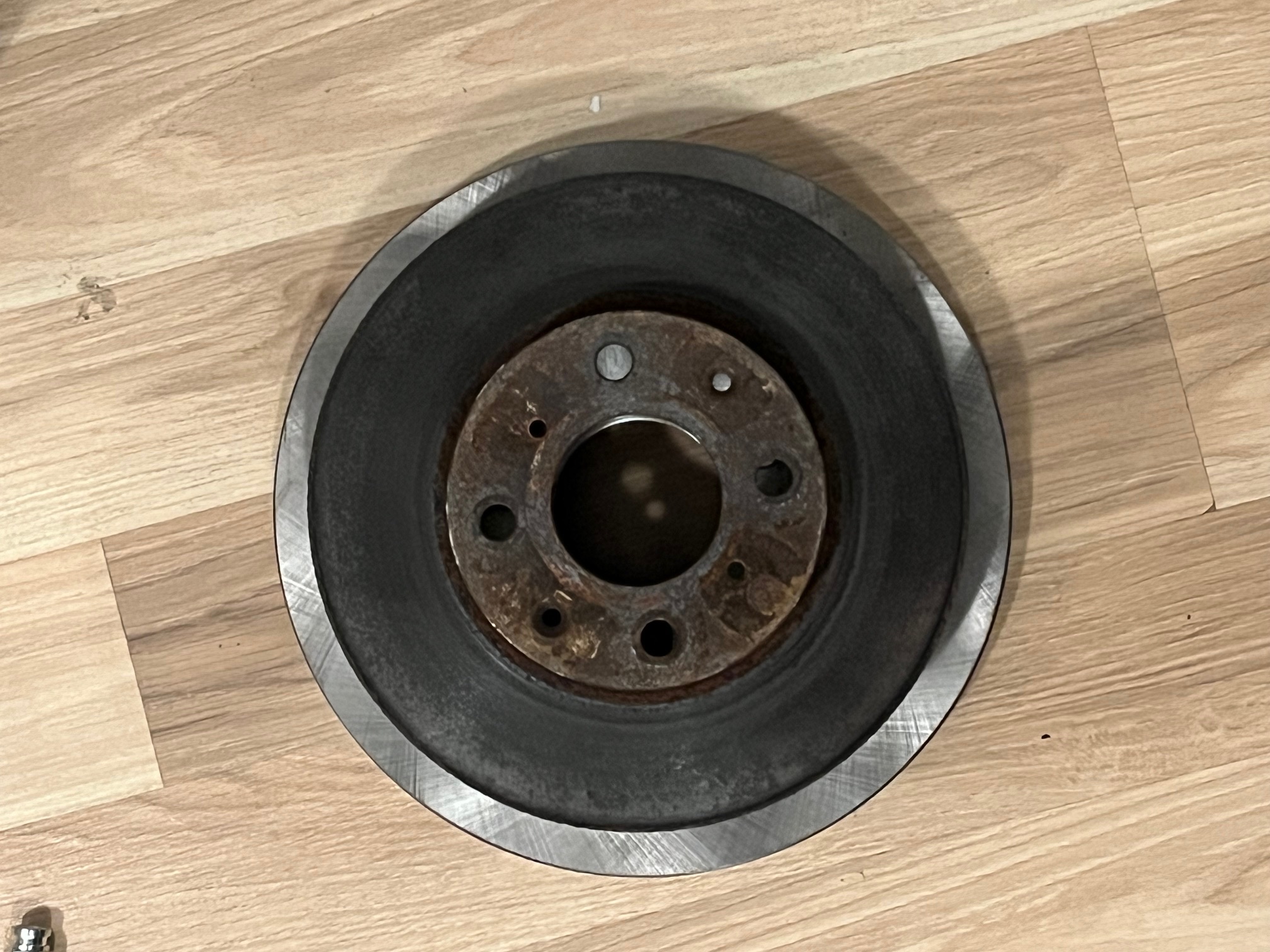

The first major upgrade for the car was the installation of new suspension. I've had good (event-winning) results with Flatout's GR40 line on my Subaru so when I saw they made them in Honda fitment as well it was an easy decision. They're relatively inexpensive and simple for rally-x suspension with external reservoirs and helper springs, with single adjustment in rebound only. Spring rates I went with after discussing with them are 225lb/in front and 175lb/in rear. Slightly softer in the front and stiffer in the rear than the stock 250/150 springs for better rotation and forward weight transfer under braking. I would have gone even softer in the front if I weren't going to be adding some weight with the new engine and transmission combo.

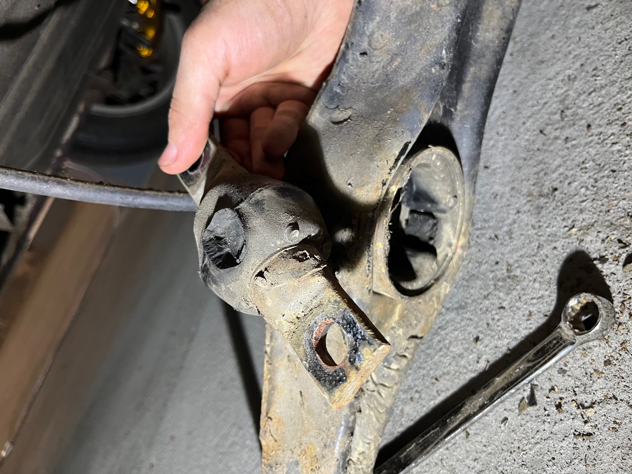

Replacing the rear suspension also ended up requiring replacing the lower control arms as the stock bushings were totally seized. These will get replaced again with the AWD parts going into the back so I just picked up the cheapest ones I could get quickly for now which happened to be an extremely blingy gold.
In the front I also refreshed the worn out ball joints and tie rod ends, and got the car a fresh alignment. Then I tossed on a set of used RE-71R tires in 205/50r15. Next stop will be to test it all out at an autocross

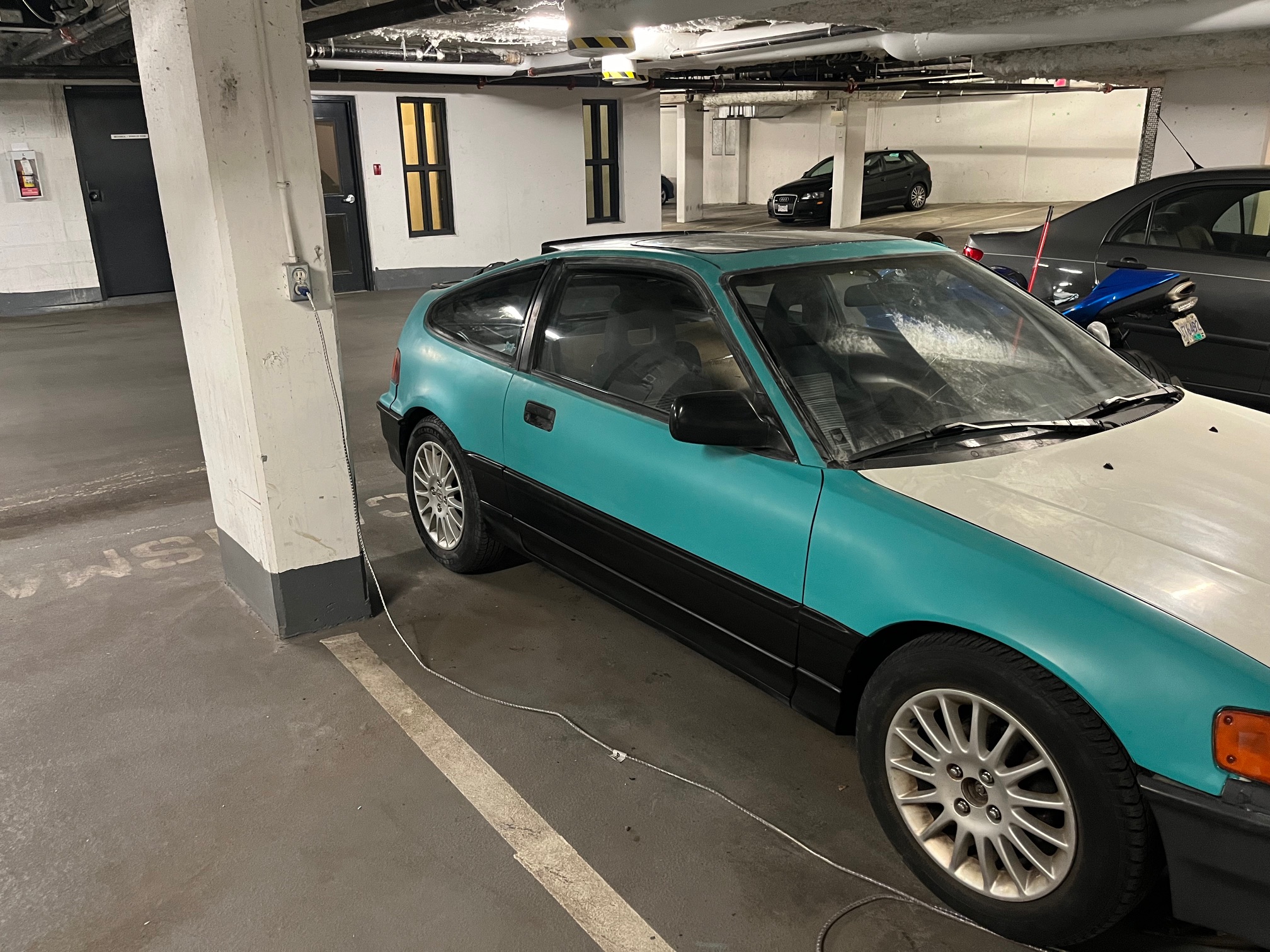

My next undertaking after the suspension shakedown was the most important of all - make the car look cool! But really, it was going to take some time to collect all the parts for the drivetrain swap and there was a lot of body work to do.
Most of the work was stripping the old (very thin!) paint down, discovering rust spots (many), and either sanding down minor spots or treating bad spots before applying rust paint as protection below my finishing color. I did some minimal bondo-ing over the rear fenders - there had previously been an excessively thick layer. This car needs to survive Canadian winter rallies and all the road salt that entails. A healthy application of fluid film into all the areas I didn't have direct access to will also help with that. It became obvious in this process that this car has had a few different people attempt rust repairs on it with various levels of competence in the past. Thankfully once again it seems the undercoating has done its job and kept the primary structure and suspension mounts of the car clean and rust-free. I sanded down a couple test spots to further verify and they were perfect.
My paint of choice for this car was Tropical Turquoise plasti-dip from the beltline up, and black bedliner from the beltline down. I chose these because they are easy to apply over imperfect surfaces, and easy to touch up the inevitable gravel impacts without sanding down panels again.

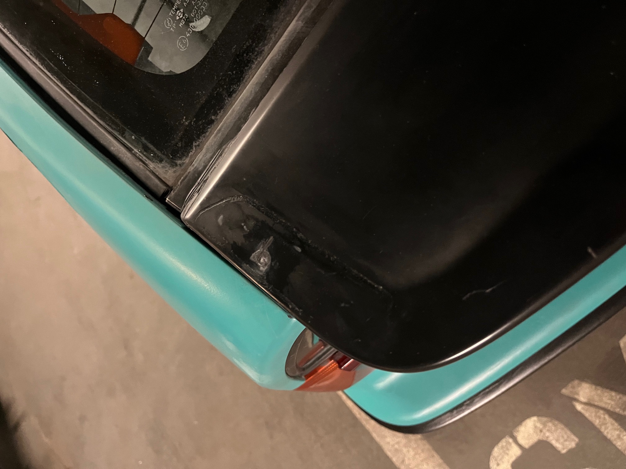

Equally important to paintwork is accessories! I sourced an aftermarket roof spoiler as well as an EDM (european, not dance music) rear spoiler. I got a good deal on the EDM spoiler as it had had some kind of large wing mounted to it in the past, so there were indents and holes on both sides from the pedestals. I cleaned that up as best I could and filled the holes with some black panel bond I had left over from the Fiero.

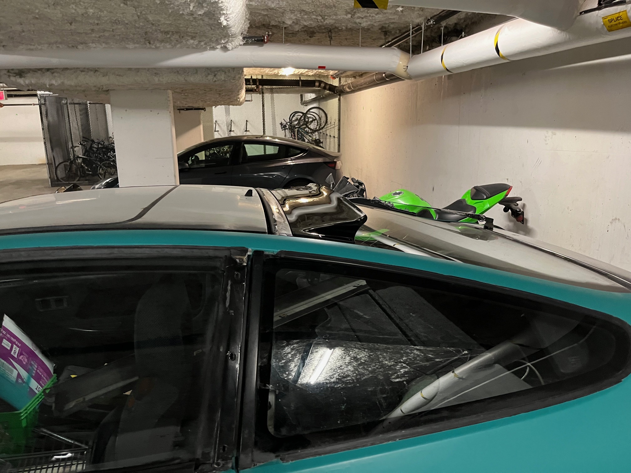

I also pulled out the stock (nonfunctional) sunroof mechanism and replaced it with a tinted polycarbonate panel from Y&S shields. Saved 26 pounds right up on top of the roof. I used some generic rubber weatherstripping and plenty of waterproof adhesive to ensure it doesn't leak. It's held up to a car wash without dripping so I think that was a success.
Finally, I also picked up some RokBLokz universal mud flaps (they don't make anything in CRX fitment! Shocking!) and rigged up some simple brackets to mount them up. At stock ride height they're around 3" from the ground - the car will be getting lifted 1-2" so this should be about the right height.
The end result looks much more rally car from the back. Still need to do something with the front but I've got ideas.

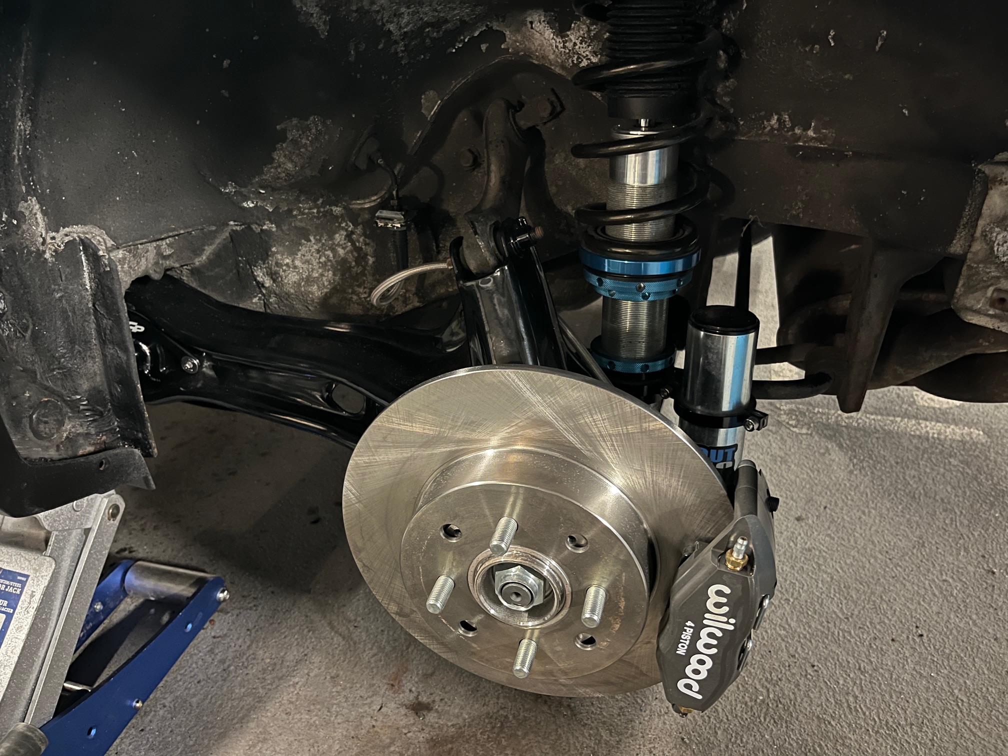

I've installed the new brake kit from Brian over at FastBrakes. 11 inch rotors with 4 piston wilwood forged narrow dynalite calipers in front and powerlite calipers in the rear. Honestly it's more brake than I need for rallycross but I don't like sliding calipers and 11" is the smallest kit that would fit on the new rear trailing arms (which take DA integra brake fitment).
They tuck in quite tidily behind the 15" wheels I'm running, which is the important part. All the good gravel tires are in 15" sizes.
Amusingly, because the aluminum wilwood calipers are so much lighter than the stock iron sliding units, there was zero change in unsprung mass in the front versus the stock 9.5" rotor setup, and a reduction of a couple pounds in the rear over the stock drums, without even going to fancy two piece rotors

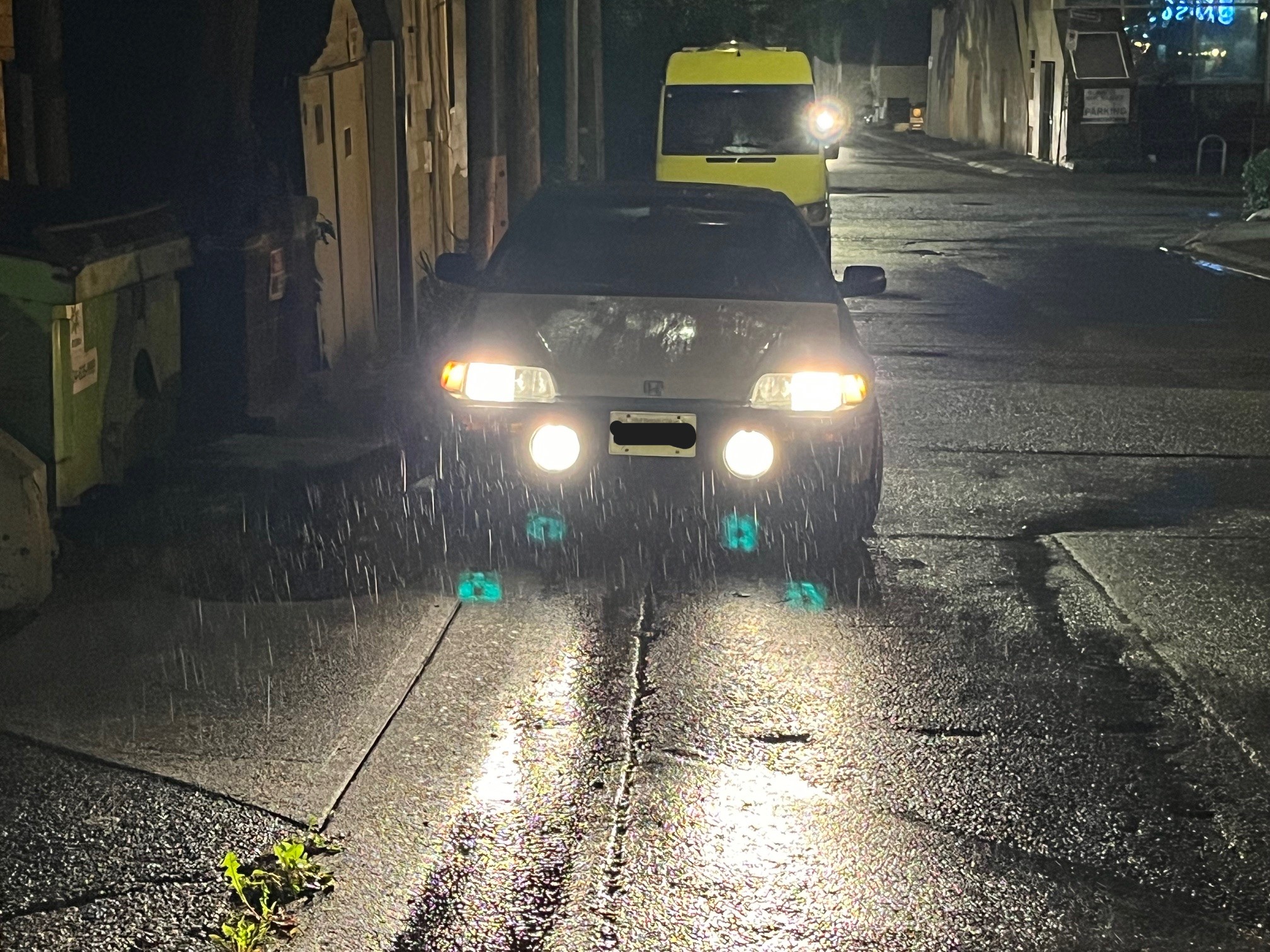

Some more (mostly) cosmetic work. This time on the front end of the car. I decided I wanted to have big fog lights like the old 90s Imprezas and Evos.
There was a rare version of the EF Civic Shuttle Wagon sold in Japan (the RTi) that came with fog lights in the bumper but of course those bumpers are now extremely expensive. So I decided to make my own. Those shuttles looked like this:
I picked up a set of Hella 500 series Fog lights. They have a diameter of about 6.5". I then set about dremelling a big ol hole into the bumper that the light would fit into. Took several iterations of cutting the hole, test fitting, making it bigger, etc until it sat where I wanted.
Then I needed to figure out how to actually make it look like it belonged there. So I went over to Canadian Tire and picked up some of these (but in black):
Yes, they are plant pots. But they're a convenient, very cheap, plastic object with a 7" inner diameter at the top. So I chopped the top ~2" off and started cutting it to fit into the bumper around the light:
Once I was happy with the fitment, some JB Weld plastic bonder got me here:
Then some sanding and a coat of paint later, and it's good enough for a rally-x car (ie looks good in pictures from 10 feet away)
And a little wiring later, and we're in business! These lights aren't super bright, but they add useful width to the low beams and I don't need to worry about blinding oncoming traffic by leaving them on. Later on this car will get proper LED rally light bars installed, but it just doesn't look the part without the big round units up front!
