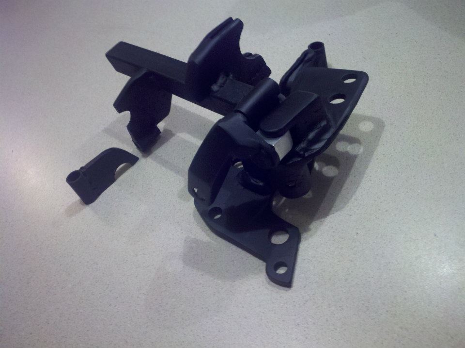

if you're going to do shorty headers, I would at least save a ton of trouble and use a G6 front manifold, it's practically a shorty header as is.
I would definitely install a bleed valve on the coolant crossover at the highest point possible.
I like my F23, I have mixed opinions about the transmission swap, on the one hand, you already have it apart, on the other, you already have mounts, cables, hydraulics, ect for the existing transmission, which will definitely get you going faster.
FWIW, this is what my original F23 shift linkage, it used Isuzu cables, and fit with an LX9. I would send it to you, but I have no idea where it is, if I even still have it.

Feel free to reach out whenever! I've made two custom F23 shifter mechanisms, both put the cables parallel to one another, the first used stock Isuzu cables, it worked, but the cable placement required me to carefully route them, and the exhaust to prevent the exhaust from cooking them. The second time, I took a page out of Fieroguru's book, and routed the cables through the fuel tank, and fuel filler voids in the chassis. Fieroguru did it for looks, I did it because I wanted the cables to be protected, and completely out of the way so they can't get hung up on anything, and they wouldn't be in the way for maintenance.zok15 wrote: ↑Tue Nov 05, 2024 5:25 pmYea, if things go smooth and I finish everything early spring (haha) then I would definitely go for it. Otherwise I will blow up the Isuzu and deal with it then.ericjon262 wrote: ↑Tue Oct 29, 2024 4:49 pm I like my F23, I have mixed opinions about the transmission swap, on the one hand, you already have it apart, on the other, you already have mounts, cables, hydraulics, ect for the existing transmission, which will definitely get you going faster.
I may reach out to you at some point when it is finally time to make this on my own about your design and what you liked and didn't like about it.ericjon262 wrote: ↑Tue Oct 29, 2024 4:49 pm FWIW, this is what my original F23 shift linkage, it used Isuzu cables, and fit with an LX9. I would send it to you, but I have no idea where it is, if I even still have it.

I saw how you (and Guru) routed the shift cables, I like it, but I definitely would worry that it would add extra shifting effort from the additional bends that the cables have to go through. Is this a non-issue with the California Push Pull Cables you used? My Isuzu cables have significantly less resistance when straight compared to bent when installed, but they might also have some corrosion in the jackets. It has led me to try and design the routing of new cables via shifter bracket with as few bends as possible.
However if it functions well I would probably go that route just to make the engine bay easier to work in and get the cables away from the heat as you have.

it functions fine IMO, granted, I don't think I've ever driven a stock 5 speed fiero, so maybe I'm missing something. what I can say is that I made sure all the loops were as long as possible to avoid possible issues with tightness.zok15 wrote: ↑Mon Nov 11, 2024 12:18 pm I saw how you (and Guru) routed the shift cables, I like it, but I definitely would worry that it would add extra shifting effort from the additional bends that the cables have to go through. Is this a non-issue with the California Push Pull Cables you used? My Isuzu cables have significantly less resistance when straight compared to bent when installed, but they might also have some corrosion in the jackets. It has led me to try and design the routing of new cables via shifter bracket with as few bends as possible.
