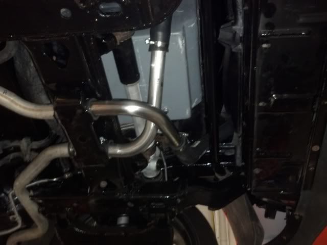

Here's some pics of bmwguru's LP9 coolant crossover solution:

Re: High Feature V6 Swap
Looks like putting hose couplers under the clamp that holds the tubes to the front crossmember was not a good idea.
