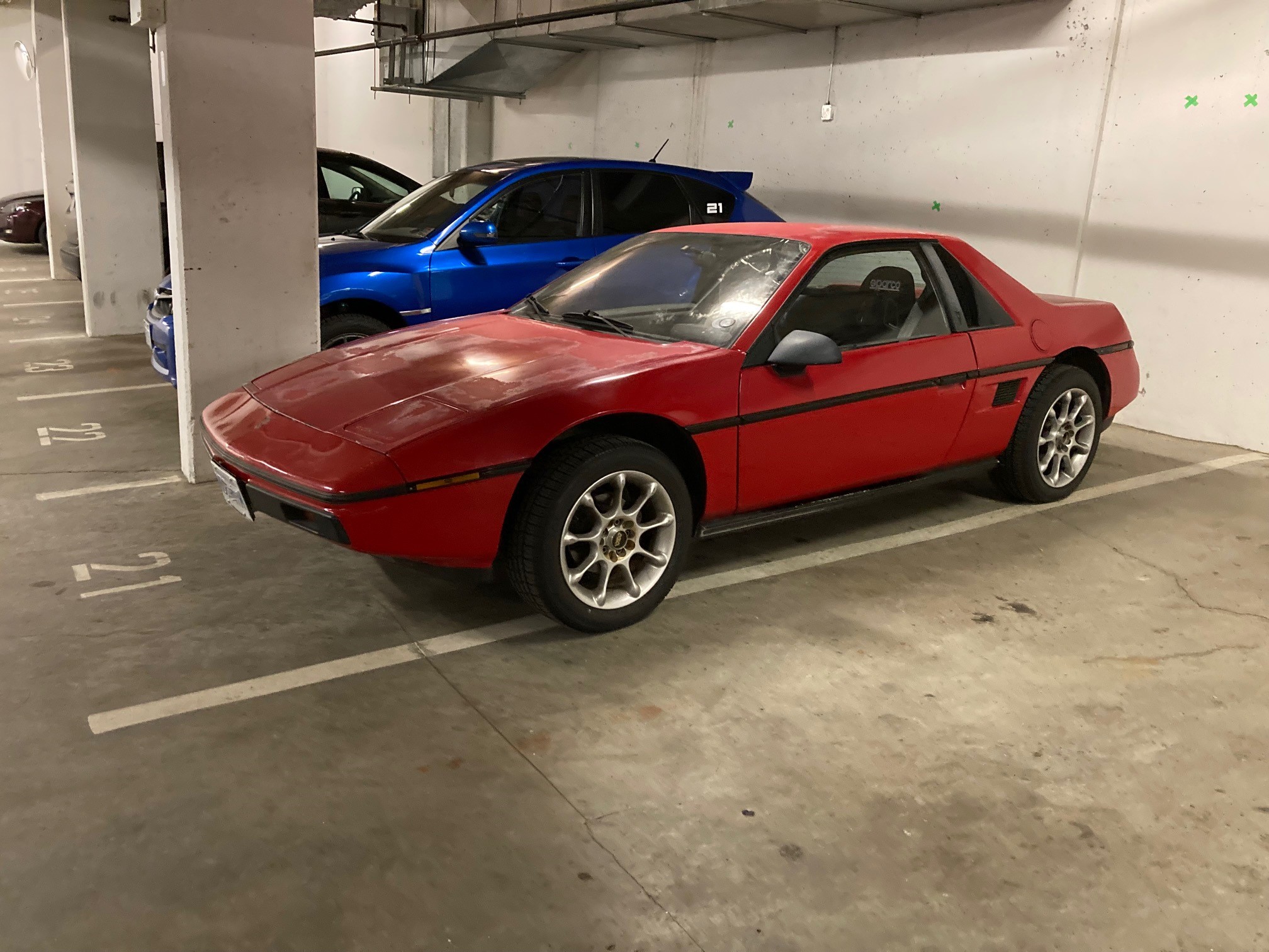

Some more mostly cosmetic stuff that I've been working on while waiting for parts and such to do the more exciting parts
Swapped on a bumperpad front bumper. I like the more old school lotus eprit-esque look that it gives the car.

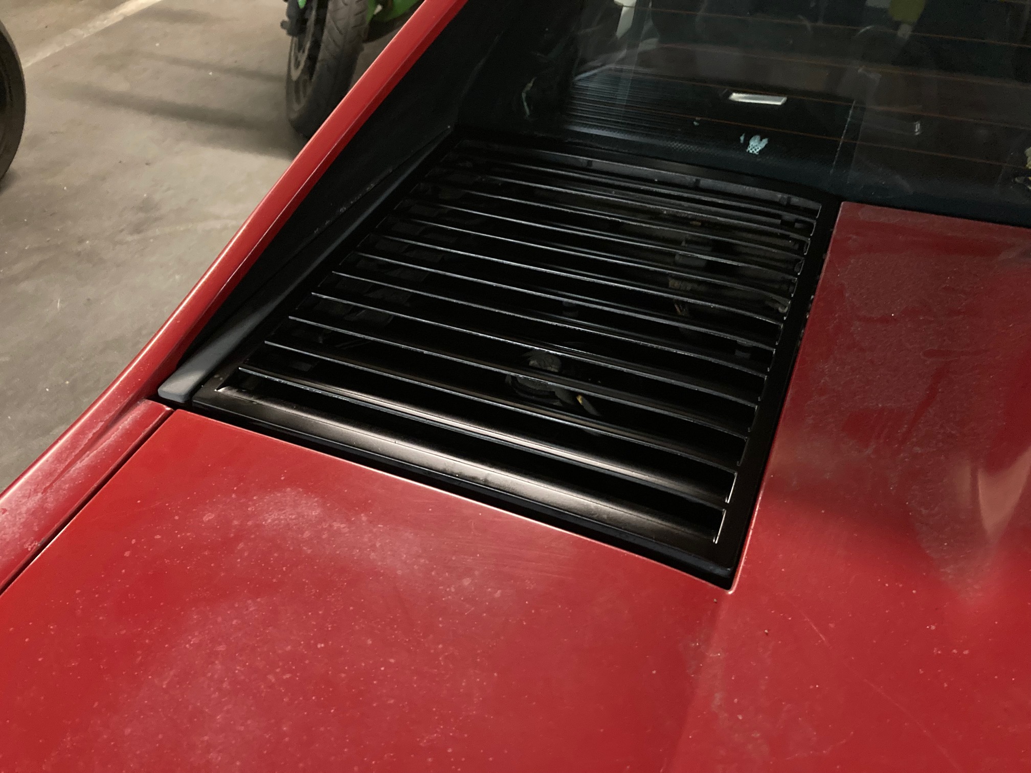

Also took out the inner grills of the decklid vents and gave them a fresh coat of paint

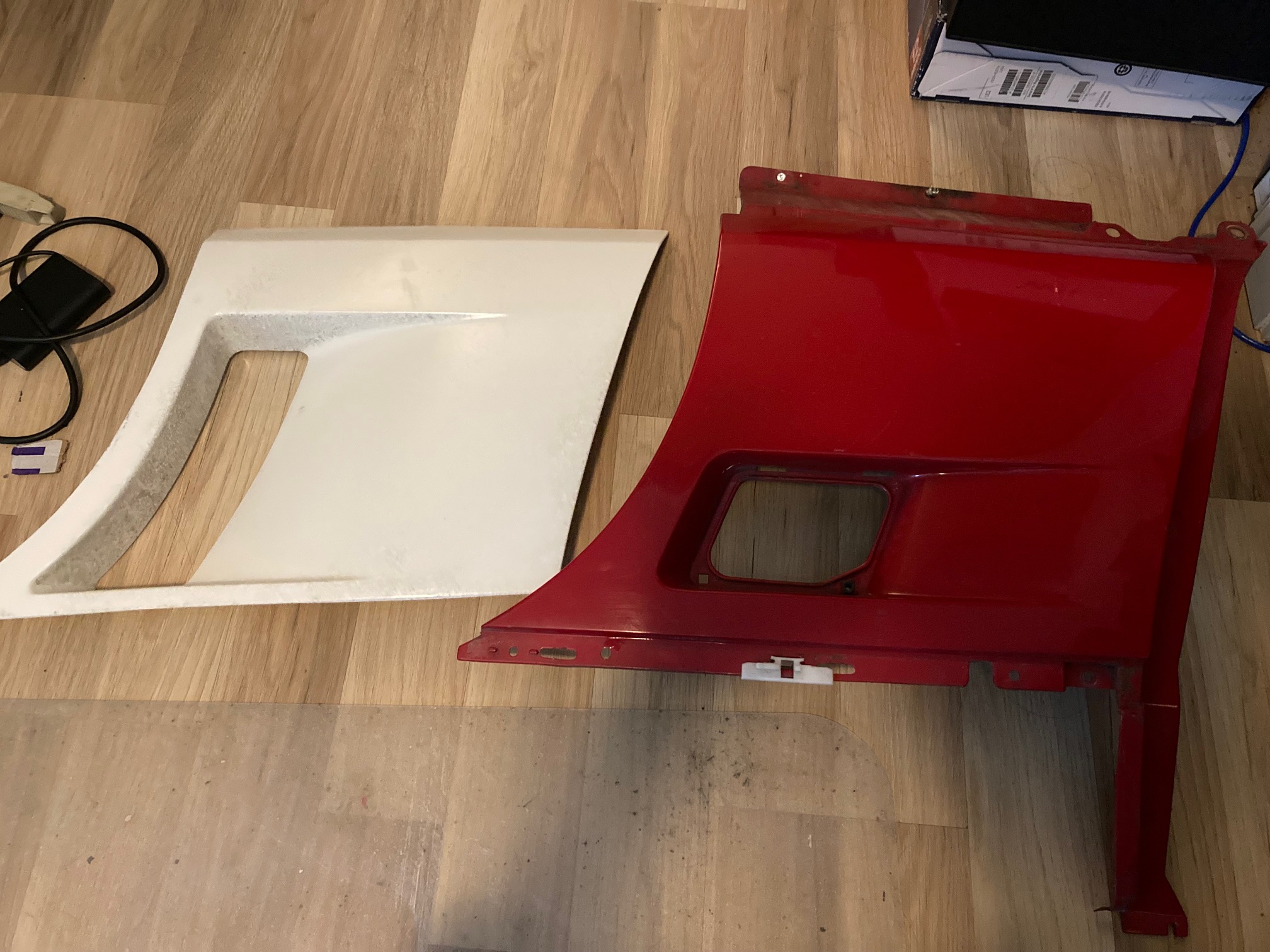

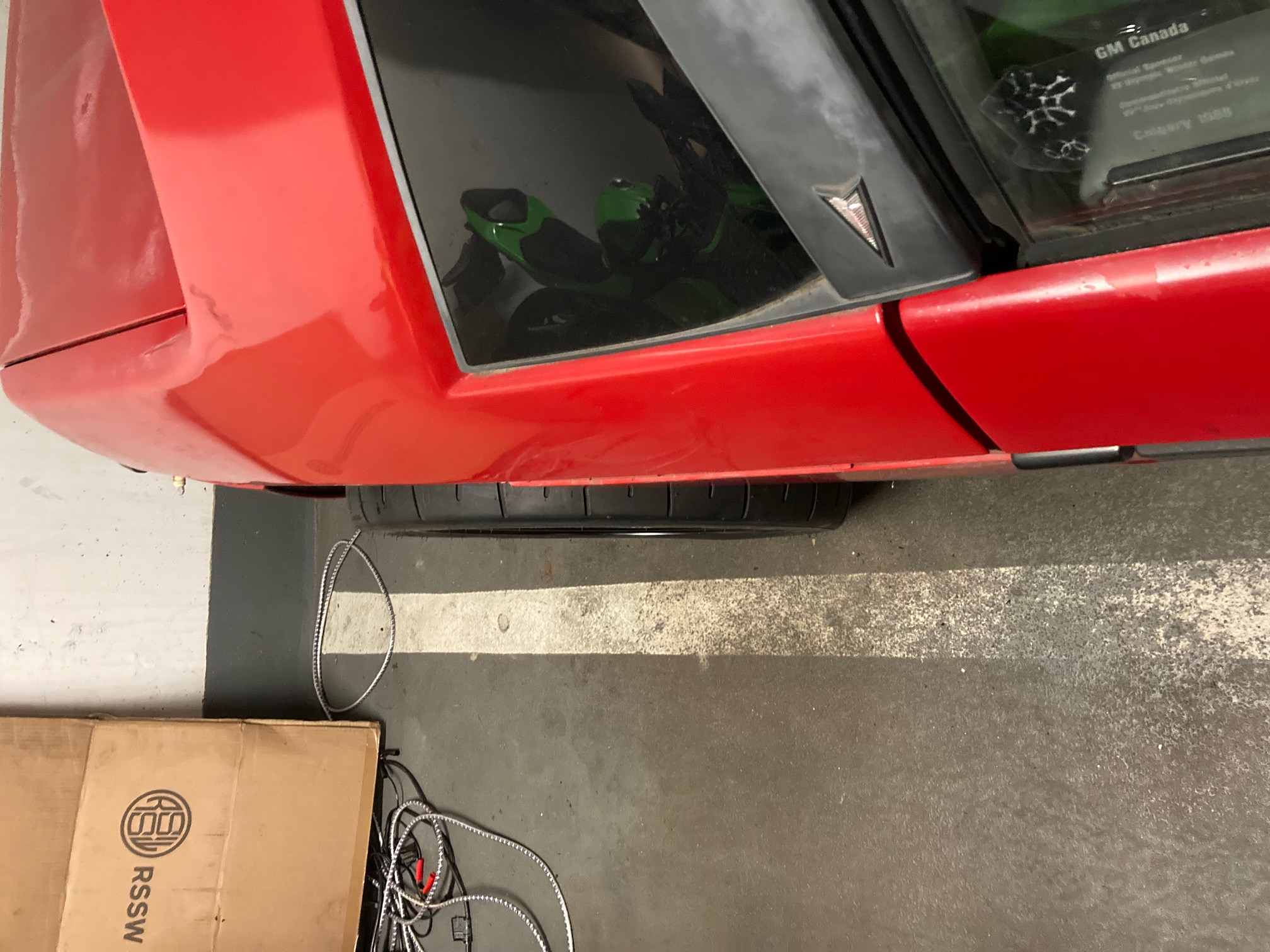

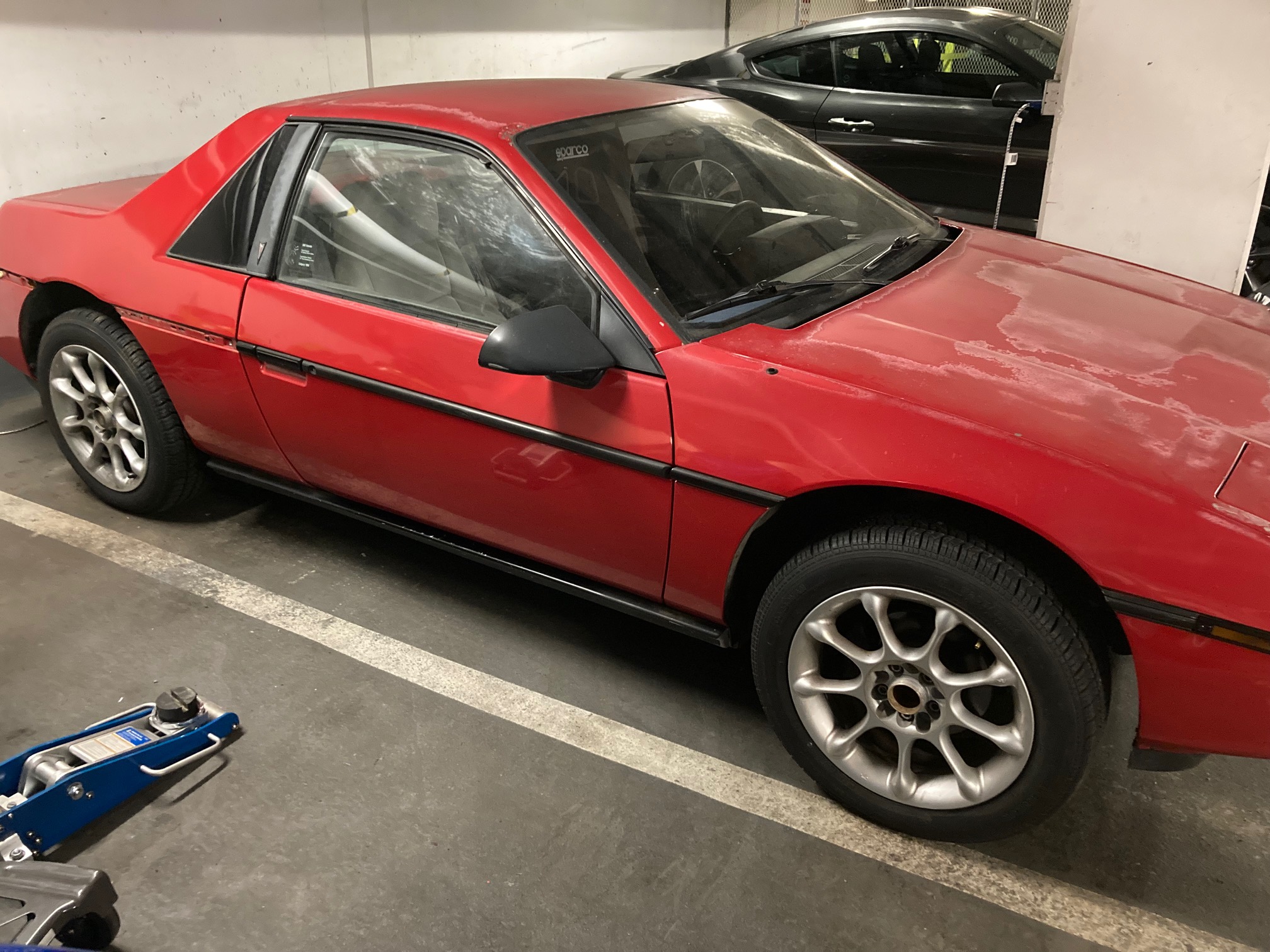

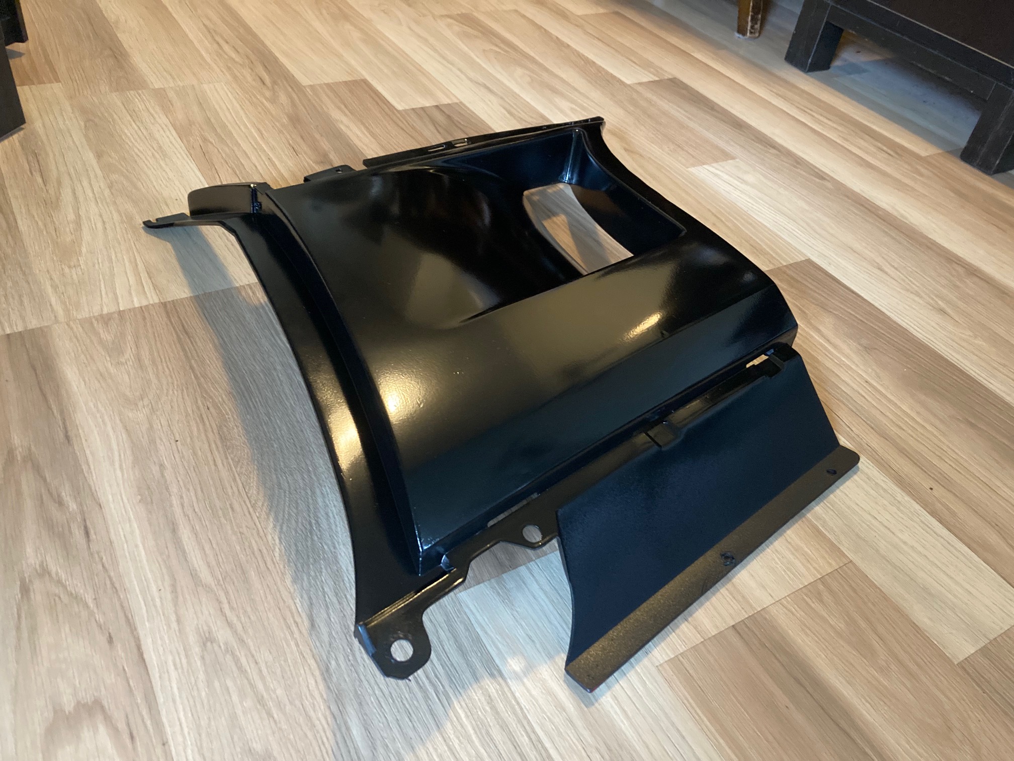

However, some progress has been made, my tires arrived, as did a pile of fun scoops and vents from Paul Angel. I started with the one that will provide air to the K20, replacing the stock fender intake:
Also got the tires mounted and on the car. Just a tad more contact patch than the 205s that came on the car

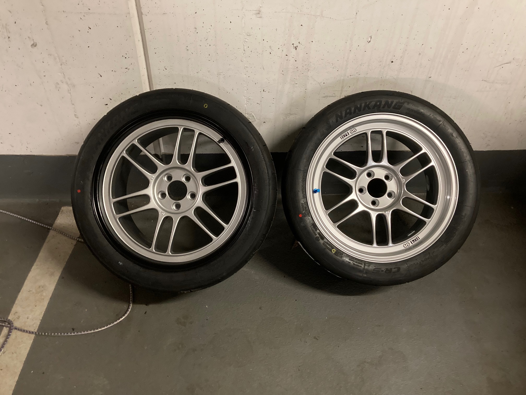

As for weight, I tossed them on my bathroom scale. The Enkei RPF1s are very light. I'm not sure what the OEM wheel/tire weight is on an 88 but I'm happy with this:
Garbage 16s + 205 all seasons: 42lbs
Front 17x9 RPF1 with 255/40r17: 41lbs
Rear 18x9.5 RPF1 with 275/35r18: 45lbs

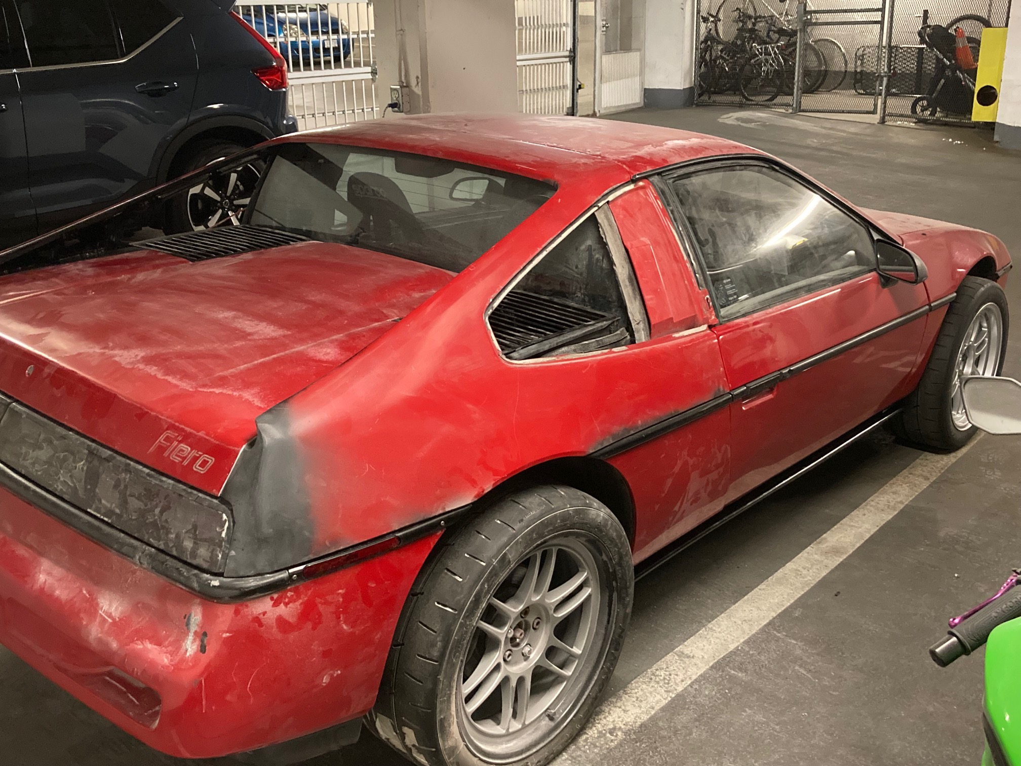

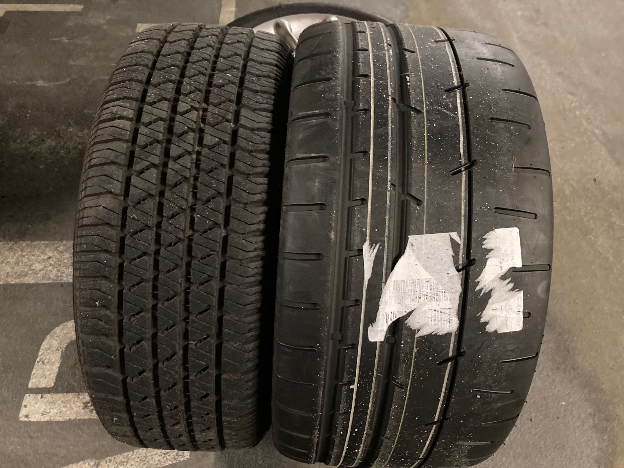

pmbrunelle wrote: Wed Feb 09, 2022 10:28 pm I want to see how the wheel blends in with the tire...
Here you go. 18" wheel with 275/35 on the left, 17" wheel with 255/40 on the right. To my eye the left looks like it has a far larger sidewall even though that isn't true.
Aesthetically I'm also pretty happy, and this package does indeed clear the suspension, though the car definitely needs some flares. That's fine though, I wanted an excuse to do that anyways. With my black paint trick the rears look incredibly meaty.

In other news I'm just about done the process of grafting on the fastback clip to my notchback bodywork. Why? Because while I've always preferred the fastback sails, I like the notchback taillight section better and I had nothing better to do while waiting for parts

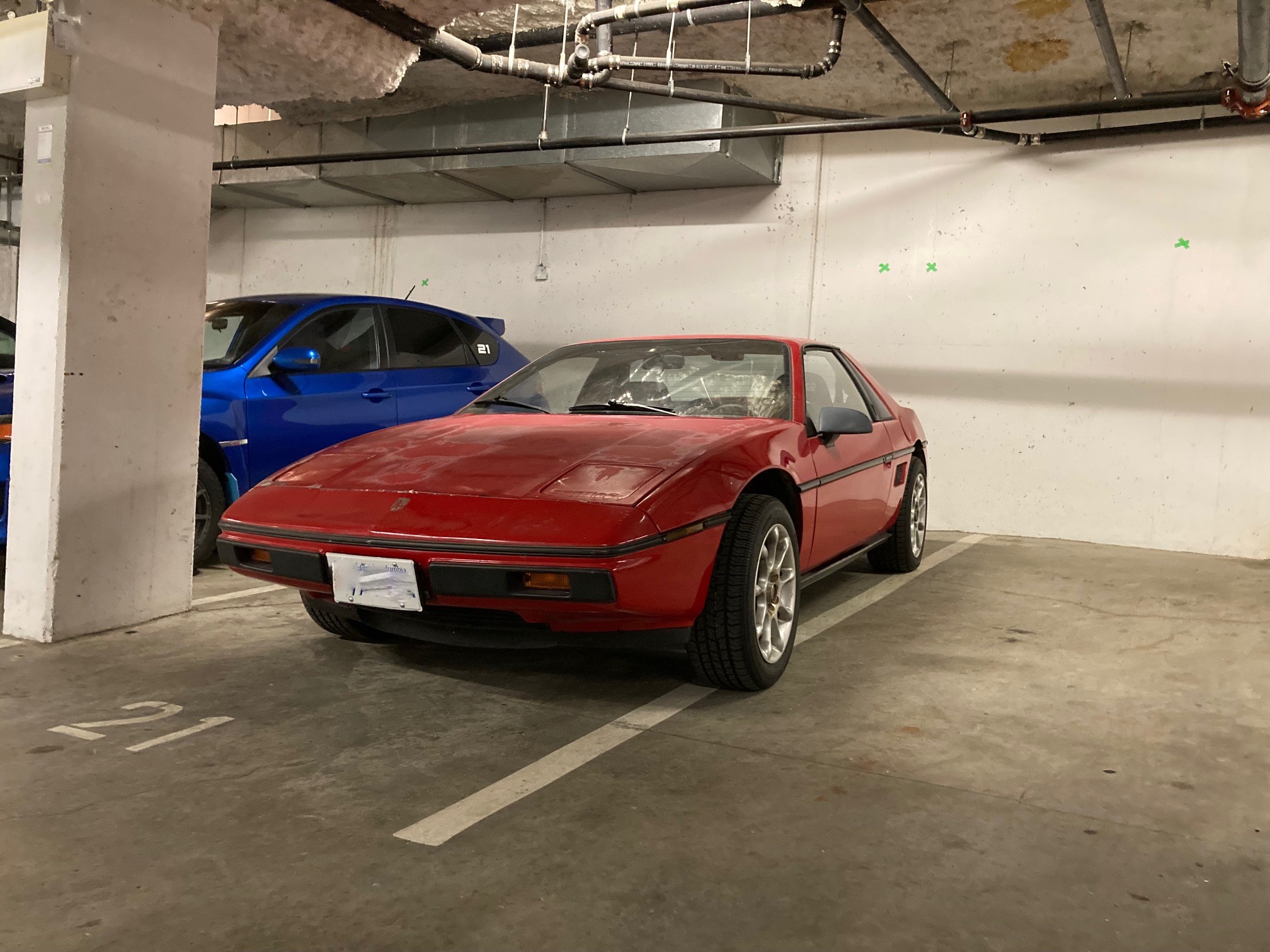

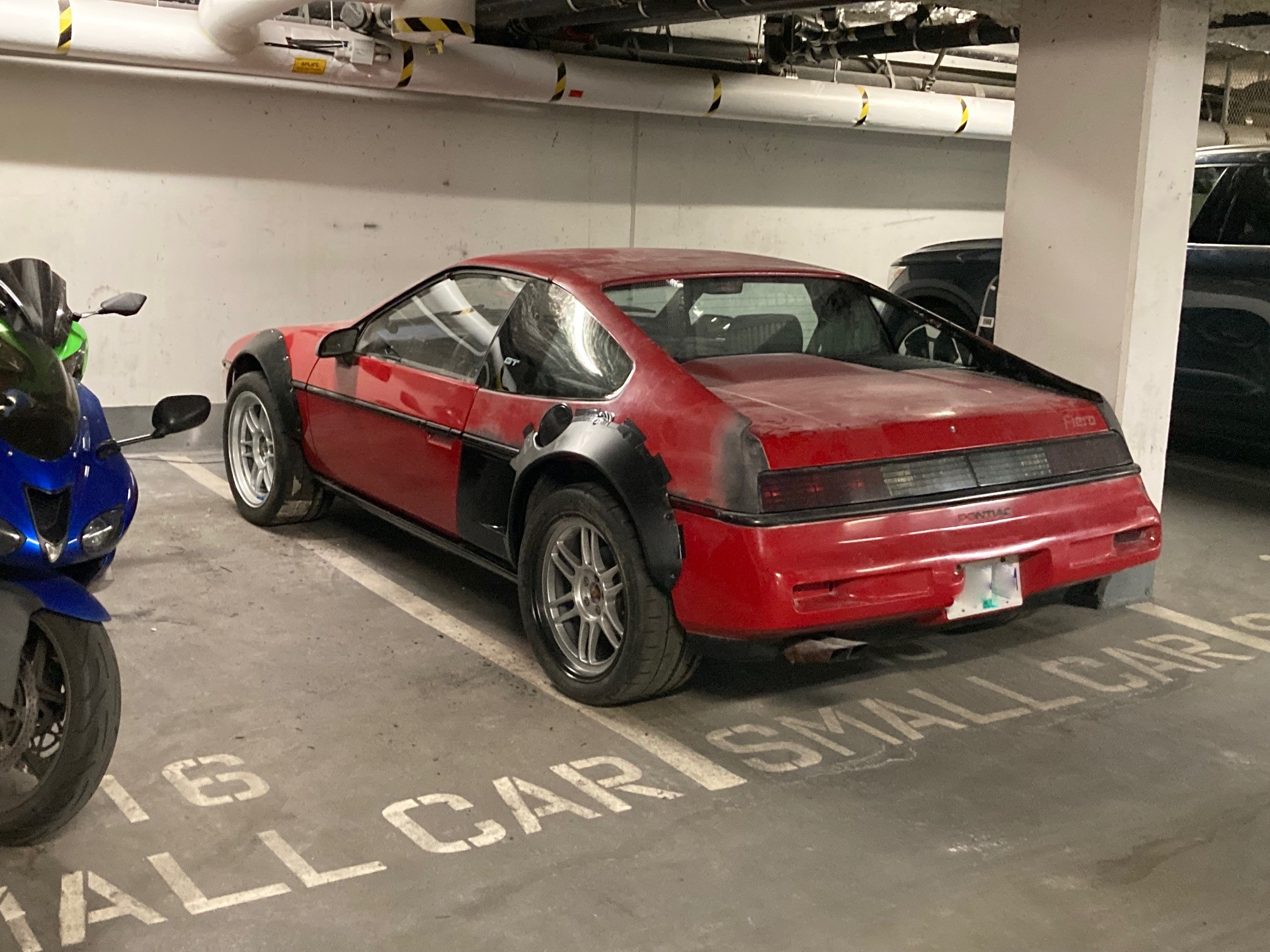

I'm not anywhere close to finished with the body (it'll eventually be all gloss black for one thing) so I haven't had it out for any glamor pictures. Here's a couple more quick shots of the current dusty state though.
Re: 1988 Fiero track car
Looks like you're in the basement of a big condo/apartment building.
The neighbors haven't given you any trouble for working on a car there?

pmbrunelle wrote: Thu Jun 02, 2022 11:02 pm Looks like you're in the basement of a big condo/apartment building.

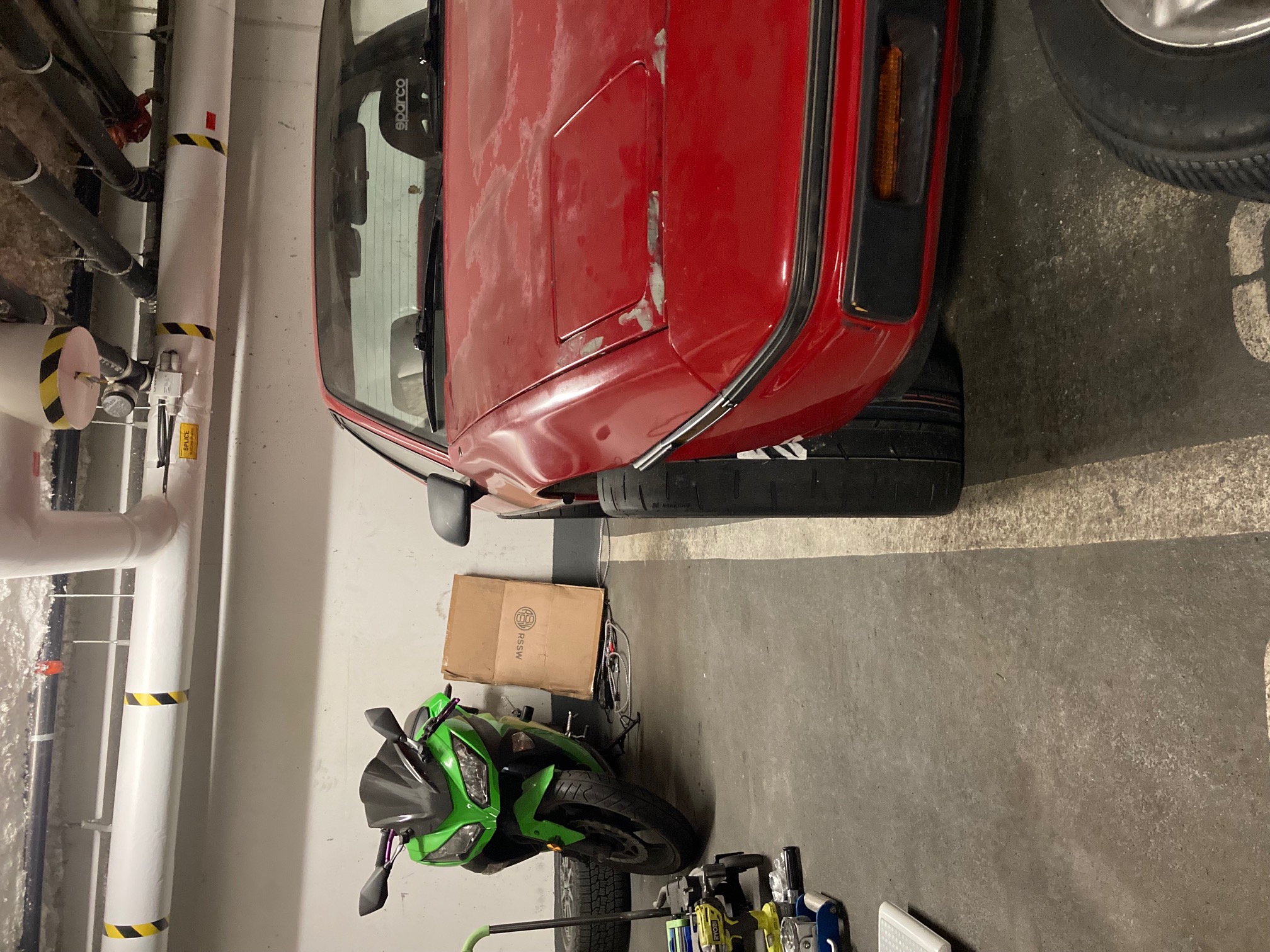

Not that big a building, only 4 floors of apartments. Thankfully everyone is very chill with me working on the car down there and I do my best to keep it clean and wash the spot out whenever I've made a mess. The spot next to me with the motorcycles is also mine so I have plenty of room to spread out tools and such (as is the one the subaru in the background is in...plus one more down a level for my partner's car :-D). The only ask I've had was from the couple with the new volvo next to me, that I put a blanket over their car if I'm sanding on that side to keep the dust off :)

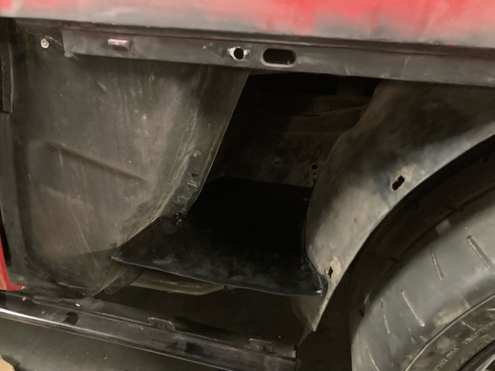

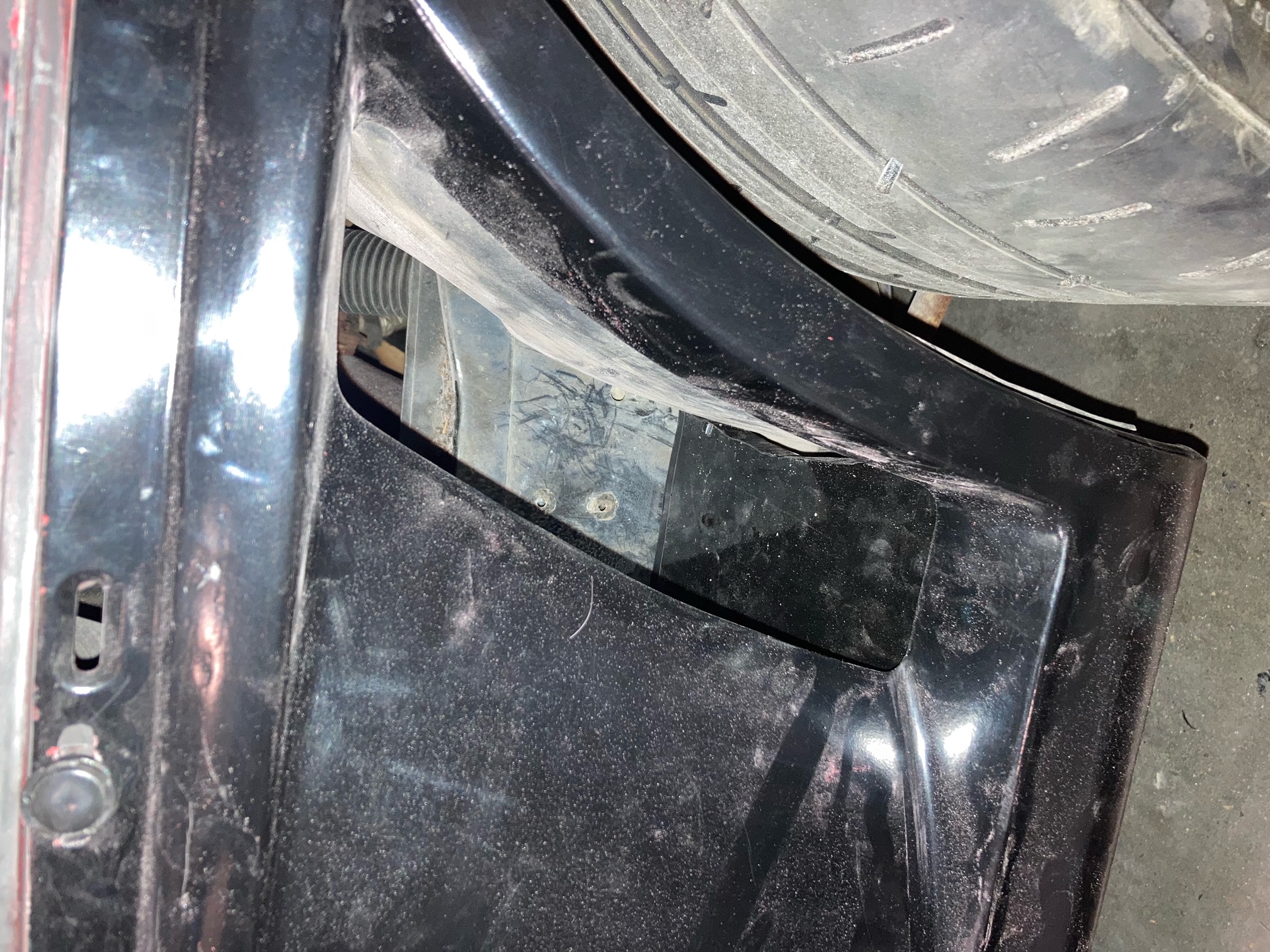

Fab'd up a simple panel for the driver's side fender intake. The plan is to have a cone filter sitting in here behind the intake so I don't want it open to the road at the bottom to suck up water:

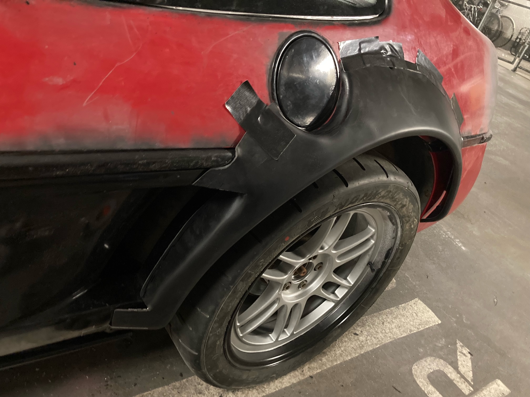

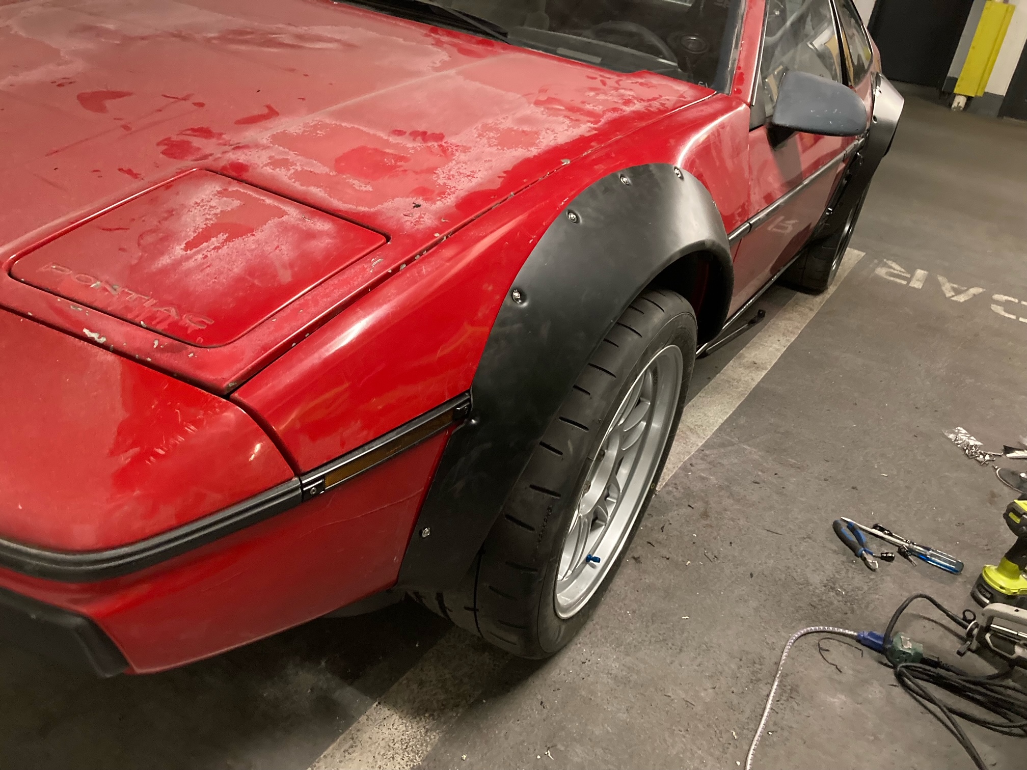

Aaand, started working on the fender flares. I'm using a set of universal flares, and then with a heat gun working them to fit the shape of the Fiero. These will eventually have black bolts holding them on, not a fan of the exposed silver fasteners (or the duct tape lol):

Flares look great! Have you thought about replicating the style of the PPG Fiero GTP rear? They had a variant of the fastback style clip that used notchback taillights, among a few other differences from the GT.

Series8217 wrote: Mon Jul 11, 2022 2:49 am Flares look great!
Thanks! I'll take some better pics of the finished product once I'm done, they're all molded and finally attached, but I need to trim the inside of the wheel arch still, and fill in the small gaps around the fender intakes.

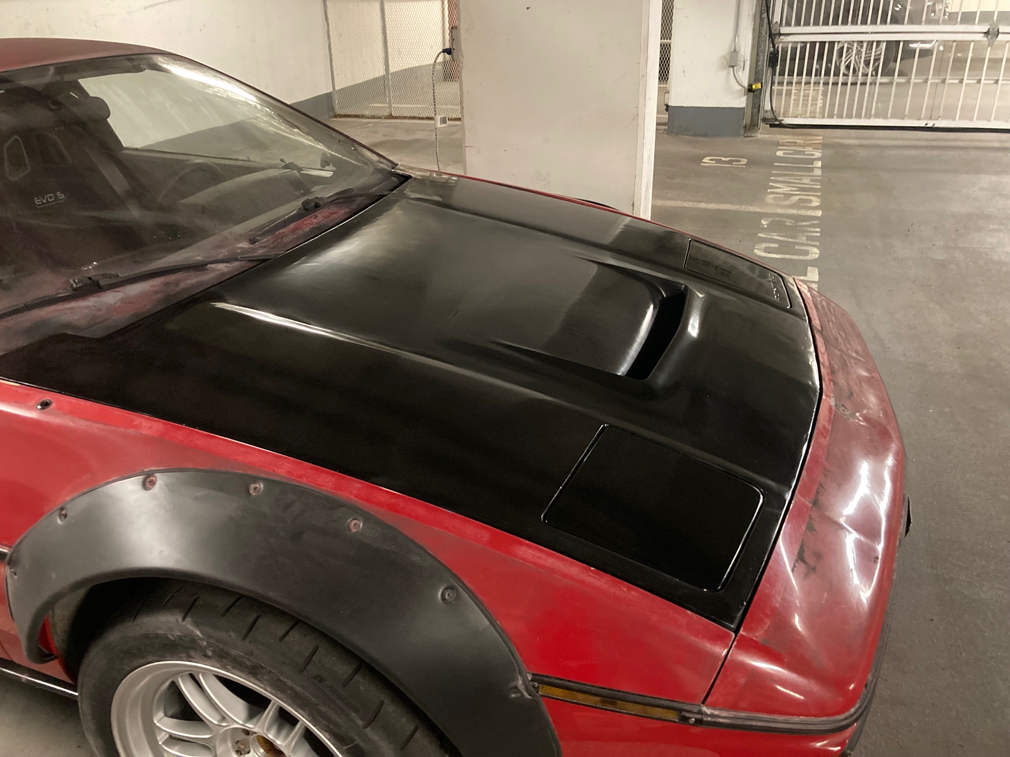

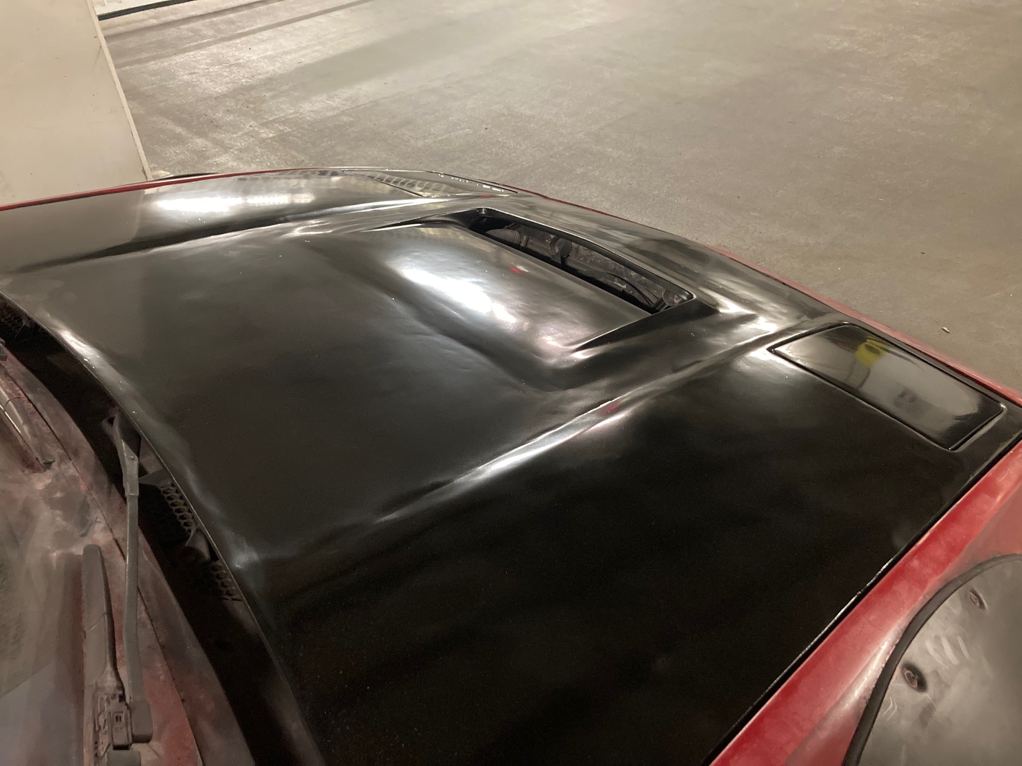

This past week's project, adding in the hood vent and giving it a quick paint job:
