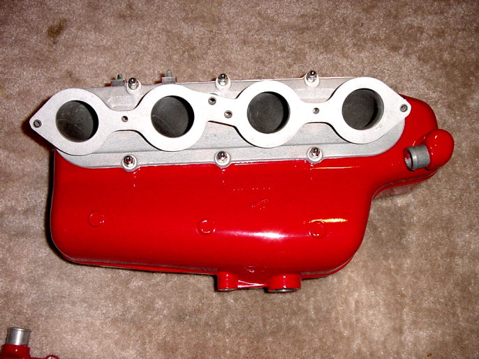

Here is Serie's photoshop of an LT1-like intake on his LQ1:
