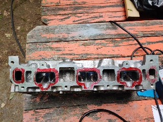

Getting ready to go start some porting in a few minutes. The full polish of the chambers turned out well. Took it to 400 grit cross-buffs but might go ahead and grab some compound and pads to take it all the way to a mirror.

Been a couple good hours of porting. Intakes are cleaned up, port/gasket matched, and the short radius are now opened up a little bit. Will hit them a bit with the 80 grit cones before I am done but no more. I want to keep good tumble happening there. Also knife-edged the dividers.
The exhaust sides are all port matched and the bowls are all shaped. This is the one that is all done with the rotary files. Will get the other two matched to it before moving on to the cones and then buffs. Will be taking these out to 400 grit cross-buffs and possibly rouged out like the chambers if I get a wild hair.
Was hoping to avoid needing to get the valves touched up but t I got a bit close with the ferrule and now will be getting them done 5 angle. I also nicked the port edge the same way on the completed exhaust. Apparently my skill (none) doesn't hold up so we'll towards the end of a four hour straight porting session. Seeing as I already took one head the wrong way and now need to pull one from motor number two to complete the this build. Steep learning curve. Might be able to pull a replacement when head when I hit the pull-a-part in the morning.
