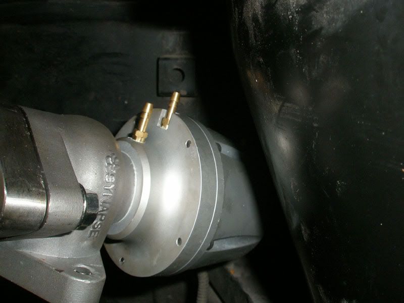

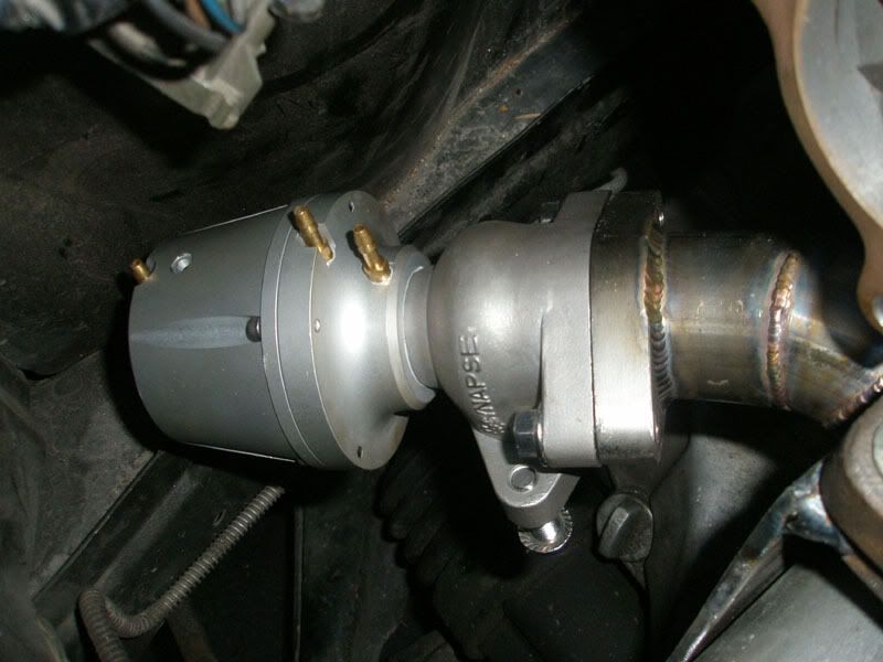

Okay, first off, I'm not buying a new wastegate. I bought that one for a reason. Second, I can make this one work by shortening up the tube as much as possible and angling it downward at about a ten degree angle. Since the strut tower tapers it should work out okay. Here is a few pics, with the flange and crossover on there it was hard to position it exactly, but this plan should work:
Everything that I had that guy tig weld (bung on the oil pan, hot side intercooler piping-allready tacked, and the crossover-allready tacked) cost me $100 because he's a friend of a friend and he was doing it in his spare time. So modifying the wastegate again should be like 20 bucks.
As for the air filter... I plan on running one but I need to get the shift cables in there because one kinda blocks the turbo inlet, so we'll have to see what I come up with. My guess is a short silicone coupler attached to a shortie K&N.
And I have no idea what your talking about with the just turn it sideways talk...

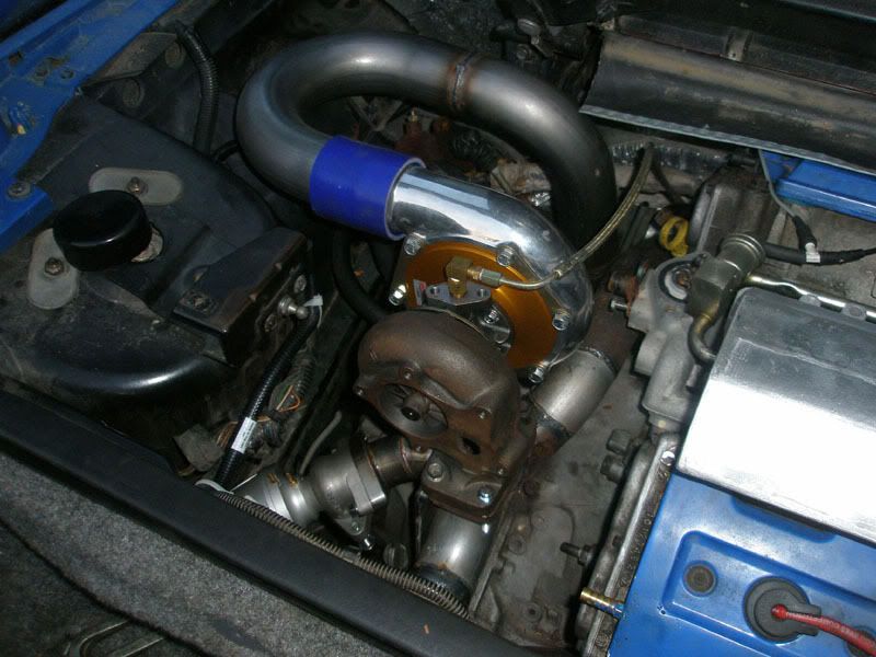

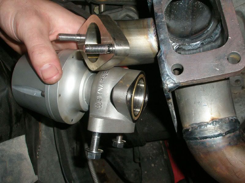

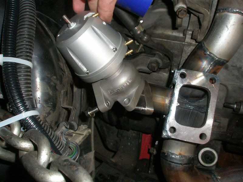

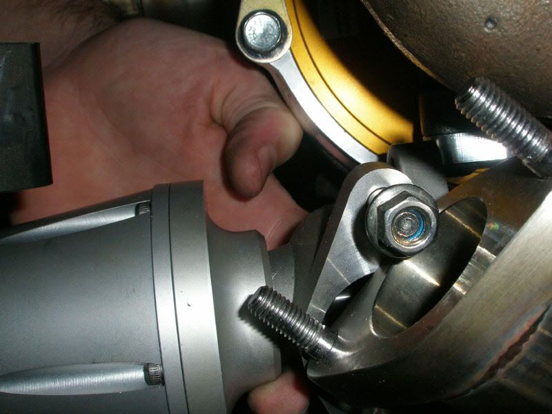

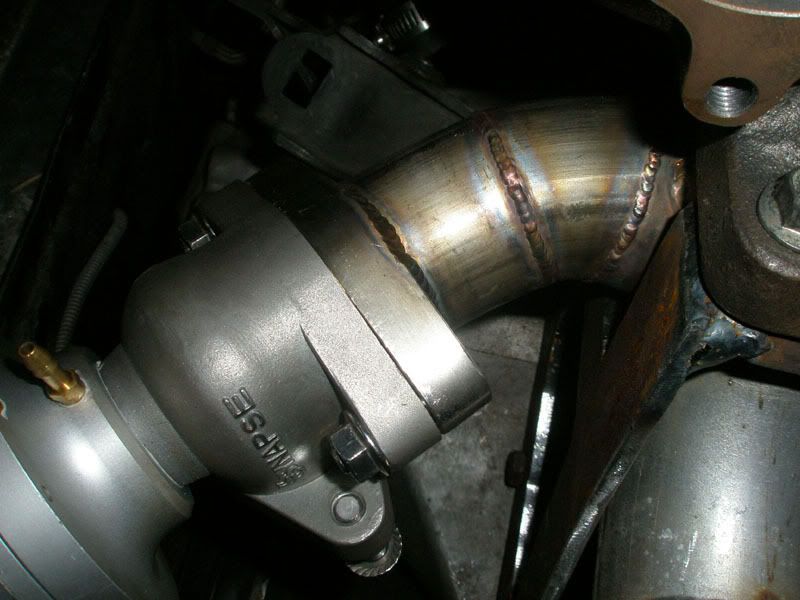

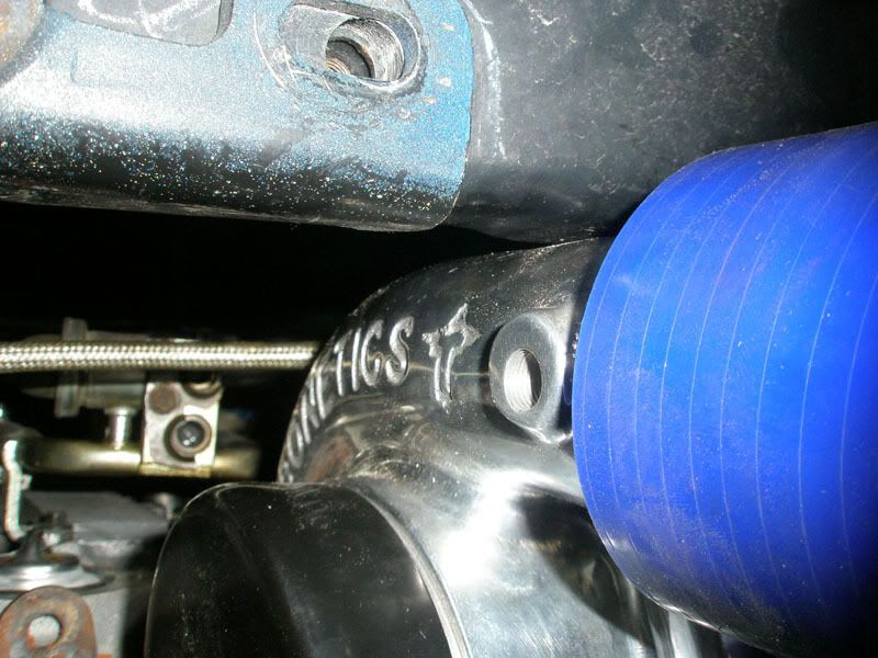

Well I got a few things figured out and got a little bit further on the project yesterday. Got the wastegate taken care of, that was the major thing. I'm also still struggling with my oil drain line issues. The AN fitting is hitting on the axel. Should have gone a different route with it but oh well! Here's pictures from the day:

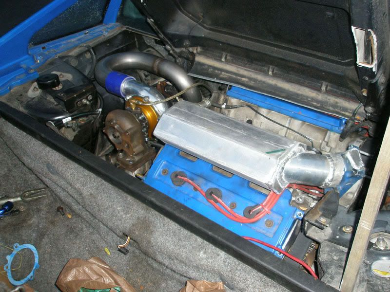

Also, here are some pics with the turbo on and the decklid down. It fits, but it's tight. I think I may be doing some trimming. The passeger side needs to get trimmed majorly anyhow. I was planning on adding a mustang scoop anyhow. I think I'll be doing that and painting the decklid flat black for now untill I decided for sure on the new paint on the car. It's going to be alot less "flashy" than now.
